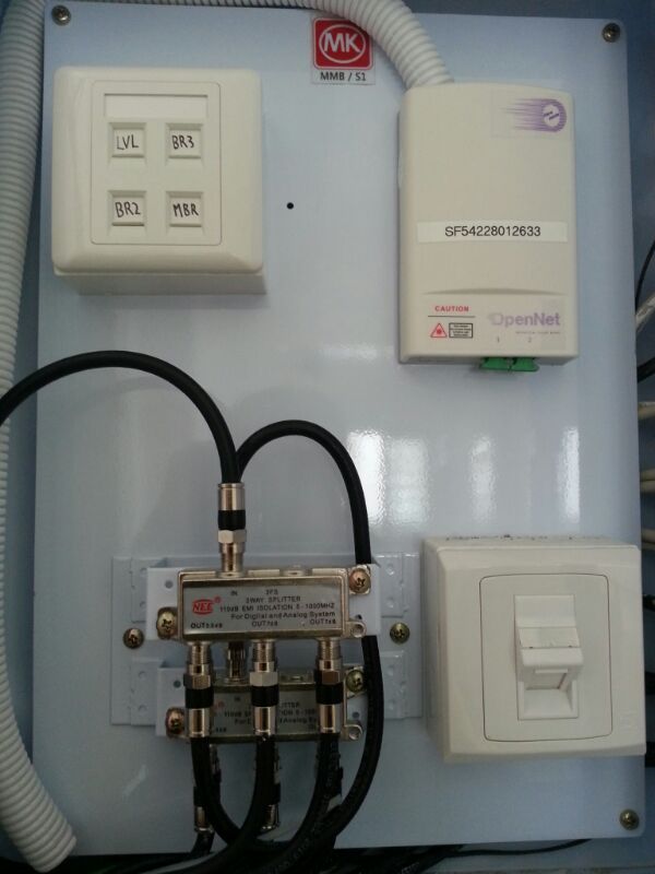

            Re: Suggestions on how to CAT6, CAT3 and RG6
            as long away from power lines.... is fine......
            one example ... singapore housing flats apartments....

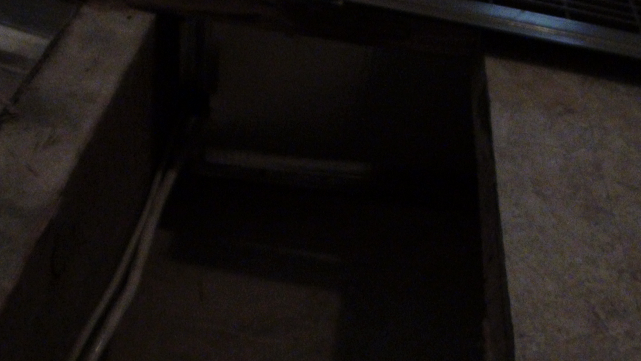

                        Does this look like the stuff I would want? I think I'd be able to get everything in there...also, I'd actually want to somehow try to slide it into the holes in the floor joists or would just having it sit between the floor joists be okay?
                        From reading your post, I'm thinking I cut the EMT so it fits snuggly on the floor joist and then try to seal around it. This is going to be a problem though, because I not only drill through the floor joist where the cold air return is and run the wire into it, but I also drill down inside that cold air return floor joists and run the wire through the ceiling there.
                        On the next floor down, there's an actual cold air return ductwork and these wires run _behind_ that ductwork, not through the ductwork. I'm going to have to find some sort of bended EMT or some sort of elbow to use there to make some short 90 degree piece.

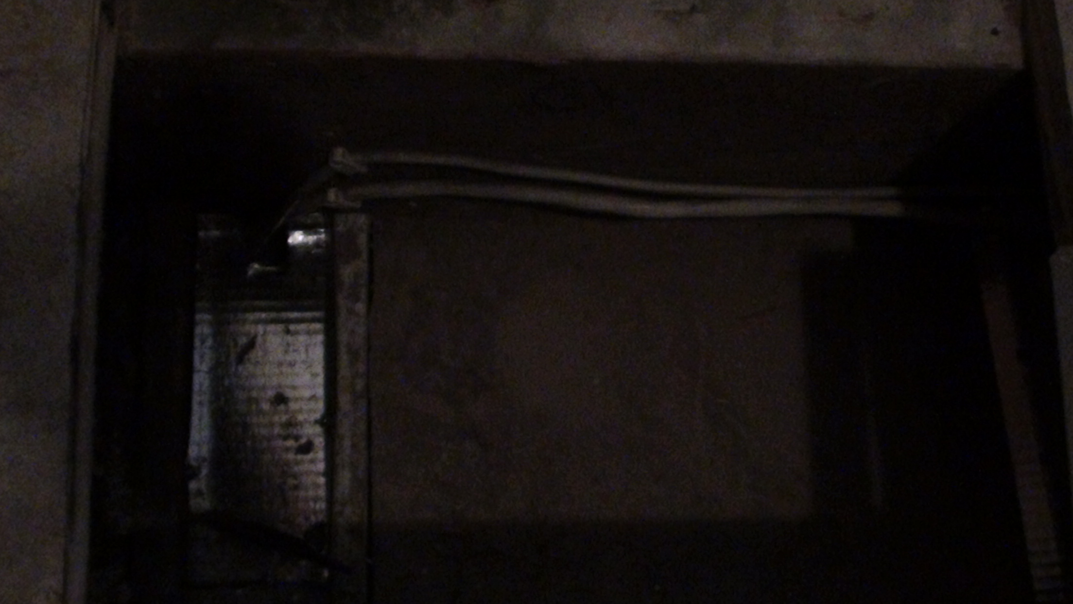

                          Here's the wires that I can see, from the cold air return they installed upstairs. These worry me, but I'm sure there's more under the hallway that I cannot see.
                          The cold air return is right by the hallway. If there was ever a fire down there, the air would fuel the fire and we probably wouldn't be able to get down stairs using the stairway. We'd have to jump out the window. Because this house uses bridging instead of blocking, they used this ThermOpan shiny stuff to block off the rest of the run, but I don't like those electrical wires there. If there was a fire there, nothing would prevent the air from getting to them and it'd go wild.
                          We'd probably have to break through the wall at night to get into the baby's room and jump out the window. I don't see any junction boxes right there. I should definitely find someway to add that EMT conduit to those electrical lines, right? They're 120VAC. Or would the circuit breakers prevent a fire and we be okay there?
