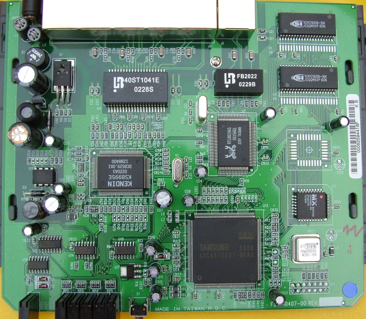

    yep as stated more then likely buzzing is course the caps gone west and you got pulsating DC from the bridge
    (or read as very bad ripple if you like)
    I was interested in what FizzyC was talking about I just remember something on it.
    There is a photo of a version 2 HERE at this page Looking at it, it seems the above must be an older version?.
    here's a link to another page which has a version again different
    (or wrong pics don't) here
    this site has photos of the unit shown above (Yatti420 unit) Here
    2/3 down page, in French me thinks and don't think it states version but does have a link to version 2 at linksys...
    regulator is AS2830AT (shown in above site photos )
    3A Low Dropout Voltage Regulator
    Adjustable & Fixed Output,
    Fast Response
    PDF at bottom this page
    Guessing D2 is a protection diode of some sort but no idea what the story with Q1 (772CK ?) and U3 (in a TO92 type package) are doing ?
    provided I got the above info right...seems to be a few variations on that model
    Cheers

      Hi Everyone,
      I looked over Starfury1's last post and have concluded that I have the same problem as most people.. I ordered some caps via ebay, without checking the "bad" capacitor thread.. I hope these will do as a replacement.. Can tolerance have a bad effect?? The only weird markings I diddnt understand on the D-Paston caps was the "LR" beside the temperature.. Do those letters have anything to do with tolerance or?? The Sanyo's have WG markings... (I think) Here...
      My unit resembles the one that has been recapped in this (same capacitor) thread.
      Here is all the details that I can see...
      Linksys
      (Plastic)
      Model No BEFSR41 ver. 2
      EtherFast 4-Port Cable/DSL Router with 4 Port Switch
      Made In Taiwan
      If anybody wants the numbers off the ABS plastic let me know..
      (Topside - Board)
      PCBA: F5-41V207-00 REV:_______ (nothing but a white bar nothing written)
      Made In Taiwan R.O.C
      White Sticker - 0006255F665B
      T2 in black marker..
      What appears to be "B18" or "BT8" (right below "T2" marker)
      Green Circle Sticker With Triangle Inside
      (Bottomside - Board)
      PCB: 56-41V206-0D ("0203" in a gold box to the right of PCB #)
      HM6 94V-Ø
      Thanks,
      Yatti420

        Re: Linksys BEFSR41 Router Capacitor Solution
        dont know on the D Pastons cap guess it possibly is series
        but yeah Sanyo WG is the "series" of the caps
        "Series" meaning what specs they are and what application they may be used for (generally speaking.)
        If they are fair dinkum Sanyo WG you shouldn't have to worry about replacing them anytime soon.... heat in the box is probably going to be there only real contender
        They seem to stand up very well in the VRM circuit of a Motherboard so should be able to do that little job without breaking a sweat
        (Although were are talking a different application to a VRM, Mains frequency ripple)
        I thought it was mention it might be better that they are 25V?
        I'll have to re read the thread
        They are LOW ESR type WG so should be more then suitable as far as spec's go
        but you may have to check Height
        generally speaking with any job
        Height and Diameter is were you can run into problems, getting them to fit ....also pitch which means the lead spacing (if memory serves me)
        A quick look Here
        At the PDF (if I go the right one) says 16V are (D/L) 10mm X 16mm
        If they are too tall you could possibly, if there is room mount them on there sides.
        Use needle nose pliers to bend leads, hold lead close to body with pliers and the bend lead down with finger the idea being not to stress lead in the body of the cap
        Not Ideal but I cant see a real problem with that with this supply.
        (if anyone can feel free to pipe up)
        just make sure they are not sitting on other components or near anything hot
        (maybe just use a small bit of that spongy type double sided tape to sit them a bit higher off the pcb)
        anyway keep us posted on how you go.

            In this Linksys case I found maximum height I could use to be 20mm.

                Hey All...
                So I recapped today...
                The buzzing is gone, but...
                The router still doesn't come out of diagnostics... Did the cruddy D-Pastons take out other components?
                Thanks...
                Edit: Could it be the voltage regulator now?? That went south due to D-Paston's going bad? Im not ruling out bad contact for the caps.. But I redid it.. Same thing.. No coming out of diagnostics.. I have them very high up now since i diddnt trim leads etc...
                  hosed firmware?
                  could be a missing voltage.

                    Try to reset it.
                      had something similar on my D-Link DI-604 after i recapped it (GSC caps )
                      i just waited a while (about 3 minutes) and everthing started to work as usual...
                      seems that it made a self-test or initialization or something like that...?!
                      whatever it was.. it was in service mode for so long that i thought i killed the router

                        The caps don't seem to be getting hot at all.. The black circular thing just past the power jack seems to get very hot.. and after few mins its still has red light on. With the link light flashing..

                                Late reply I know
                                but that could be a shot Bridge rectifier.
                                I suppose that my depend on you idea of hot and how hot they normally get But I shouldn't image its real hot
                                Black round thing with 2 ~ and a + on it
                                like in this photo Here
                                You need to check/replace it or firstly if you got a meter check the voltages.
                                Id check voltages on cap reg etc first
                                It also so possible its "Bricked" if someone was trying to flash it while it was somewhat working.
                                there use to be a page over a linsys org on possibly how to unbrick never tried it so dont know... or even if applicable in your case.
                                Cheers
