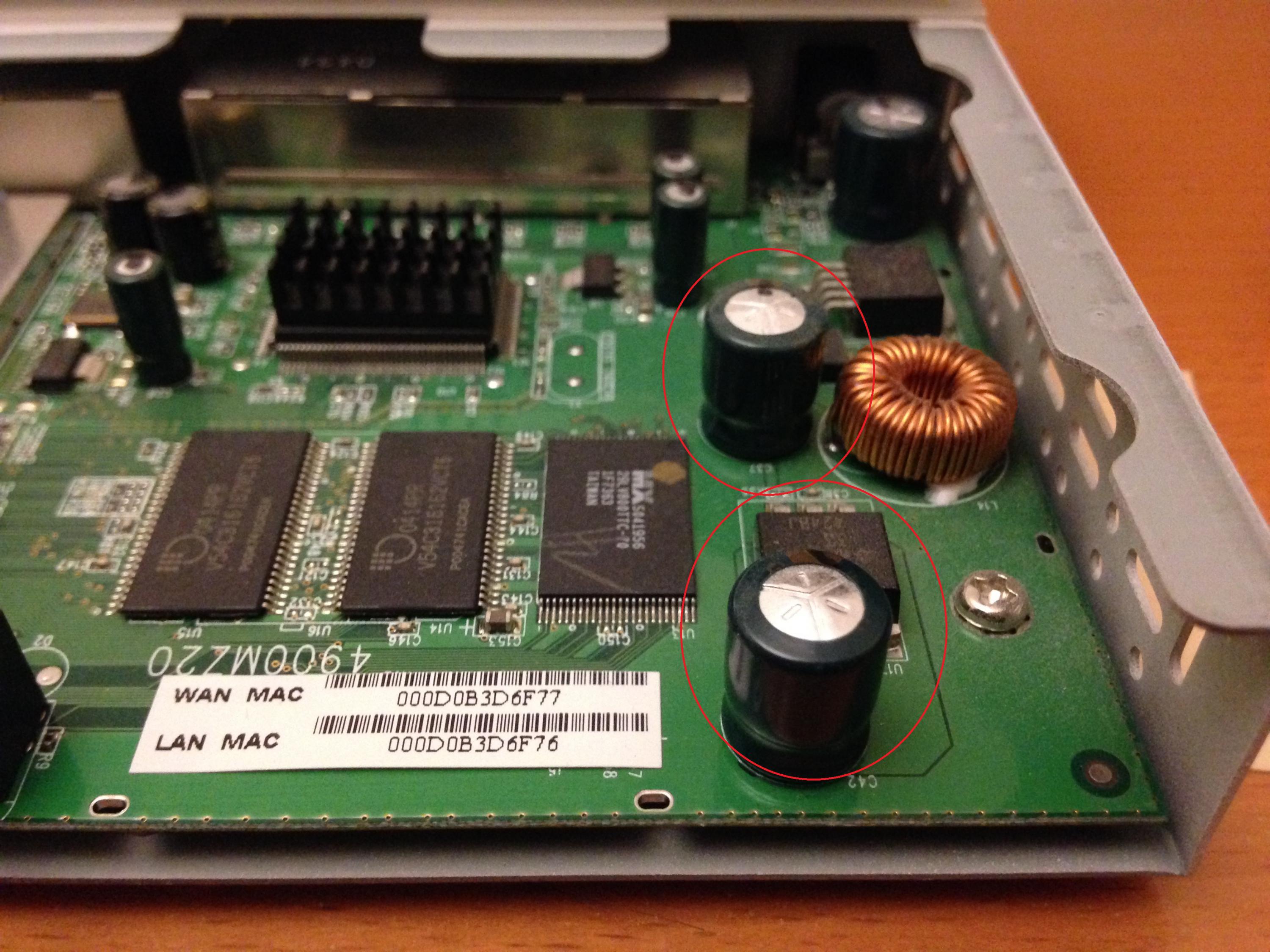

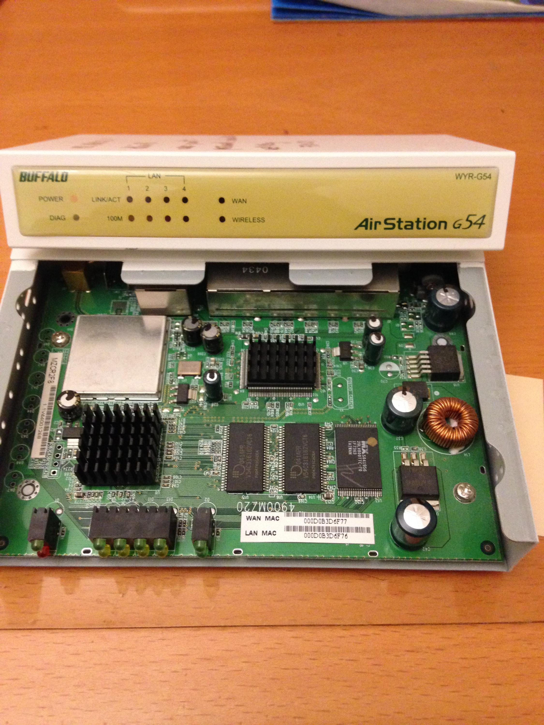

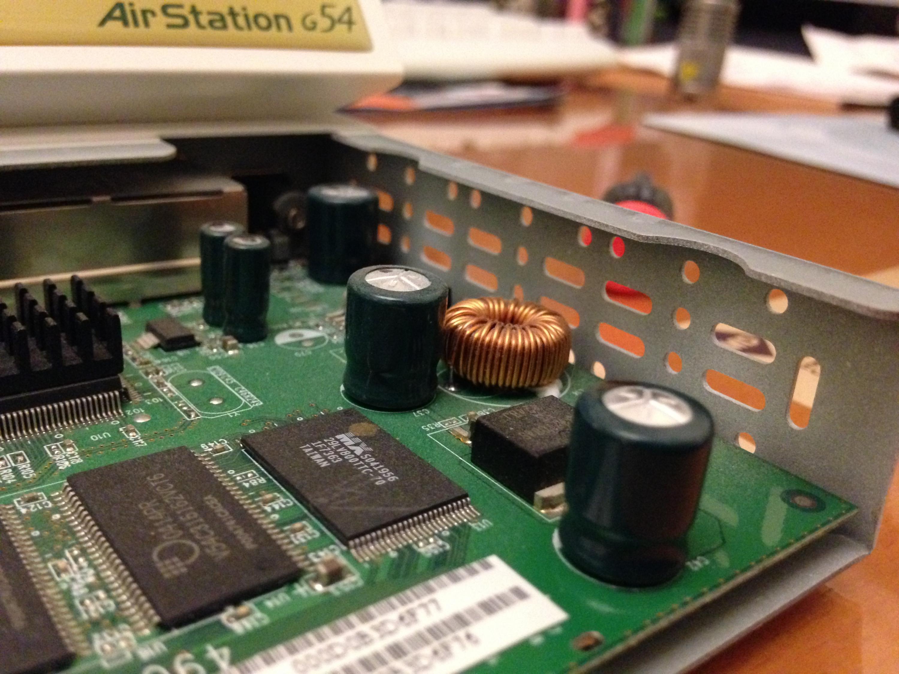

    Buffalo Airstation G54 WYR-G54 Wifi G Router
    Adding to the knowledge base.
    This is an old router circa 2005 that I had picked up while I was in Japan. It started getting flaky with freezing and disconnects. I retired it from service and finally pulled it apart today to show 2 bad caps (bulging).
    They are Teapo 470 uF - 25V caps.
    I haven't bothered to fix it yet; with the stock firmware, this would be garbage but I'll see if dd-wrt was ever ported to this device.
    Hope this helps someone out there.
    • 22119

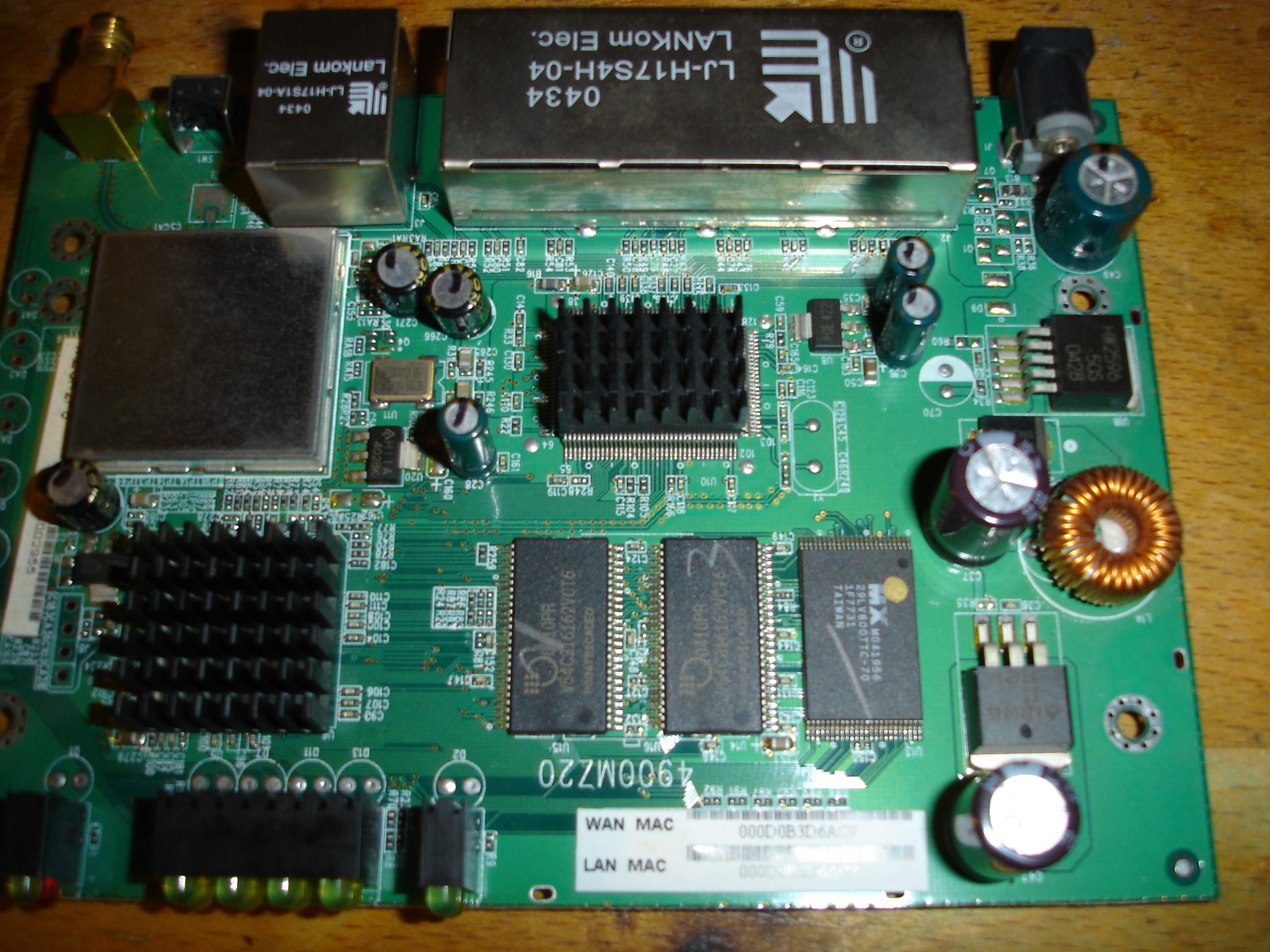

    Re: Buffalo Airstation G54 WYR-G54 Wifi G Router

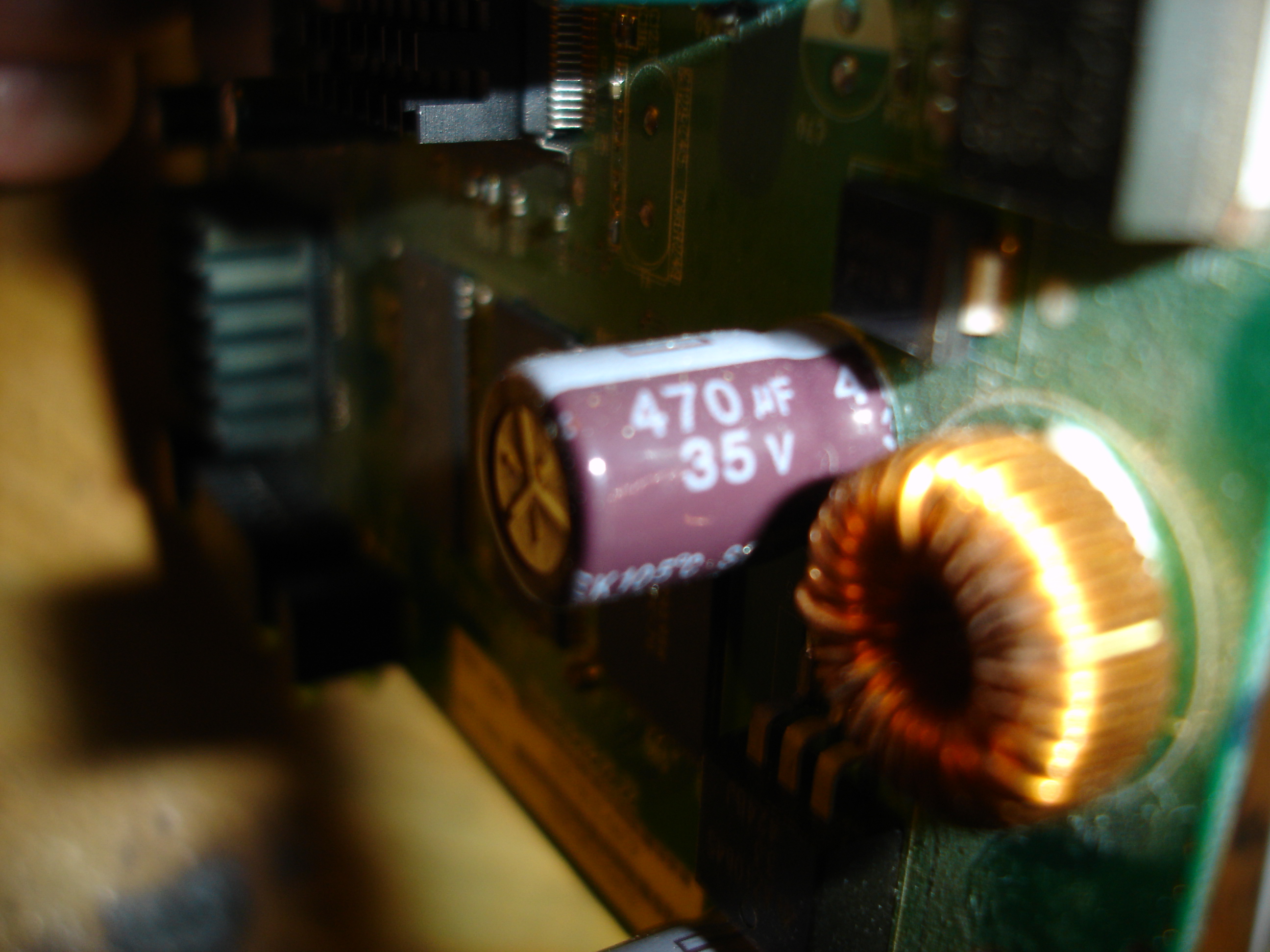

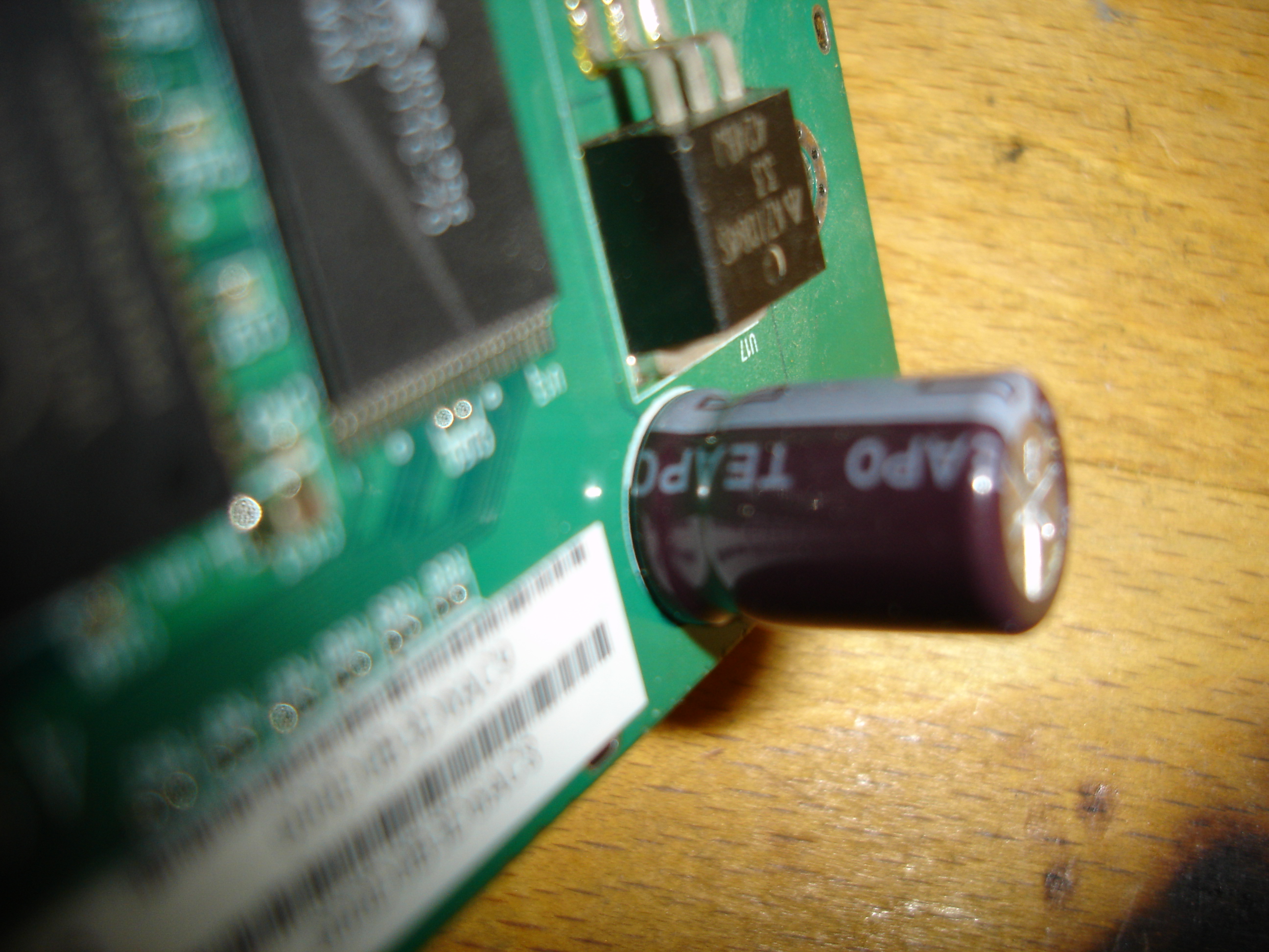

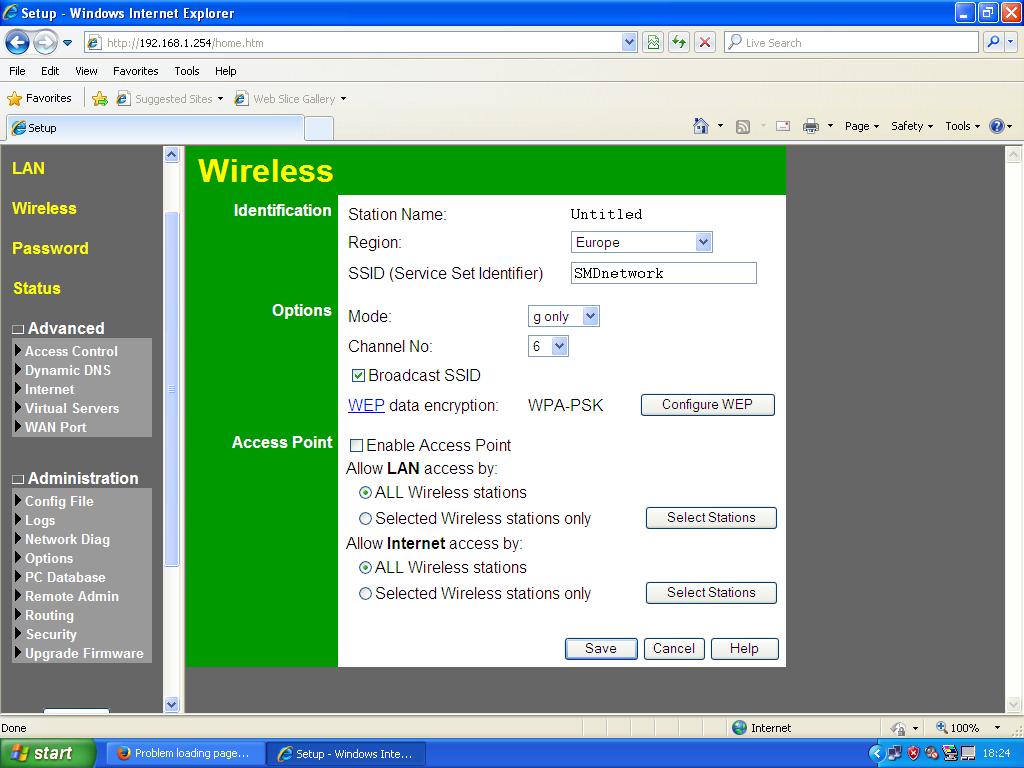

    I replaced the Teapo 470 uF - 25V caps on one of these old routers around 10 years ago, i replaced them with.... 470uF 35V TEAPO caps .I only used the router a few times after that,if i remember it was while i unbricked my WRT-54G . Fired up the old router today.
