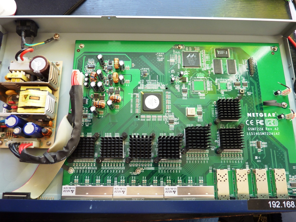

    I have been using this nice 24 port layer 2 switch for a couple of years now. Last week it started to cause serious troubles by rebooting without any reason and by hanging at startup with all the status LEDs permanently lit.
    When I press the packet-processor down gently, the booting continues and the LEDs turn off but the unit will not run stable. When pressing down the processor while it is running might cause the unit to reboot.

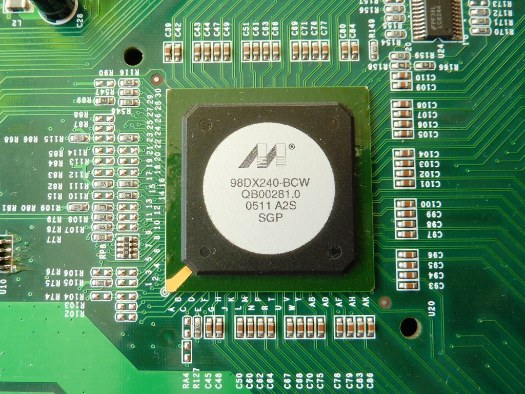

    This looks to me like a case of faulty solderings of the BGA chip, a Marvell 98DX240-BCW. The packet-processor doesn´t have any heatsink atttached to it and gets considerably warm during operation.

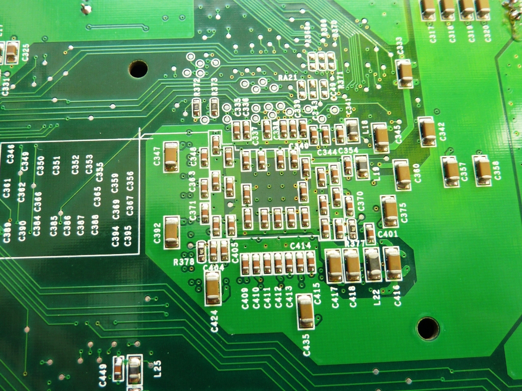

    The pictures show the packet-processor and it´s surroundings and the bottom side with several capacitors.
    I wonder if there´s a reliable way to resolder / reflow or even reball this chip to make sure it will operate stable for another couple of years.

              It could also point to one of the ceramic capacitors being cracked or something, and pushing down on the CPU affects it since they are right under it on the other side.

                There are several capacitors and two inductors on the downside in the processor-area. I resoldered all of them carefully, but the problem persists.
                I also took a look at the layout of the bga pads of the processor. Most of them are located near the edges of the chip, only a few in the center. And the right half of the rear edge is whrere the thing responds to light pressure.

                    The capacitors themselves might be physically damaged, resoldering won't fix that. (Unlikely though, more likely it's the BGA)
