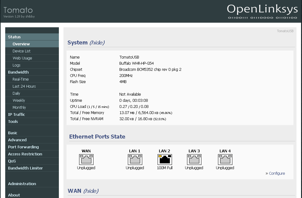

              Do yourself a favour and use Tomato. Here is the latest Shibby build for your router:
              http://tomato.groov.pl/download/K26/...1-124-Mini.trx
              • mockingbird
                • Dec 2008
                • 5484
                Re: DD-WRT software help.
                Here's what the latest version looks like:
                Pretty slick.

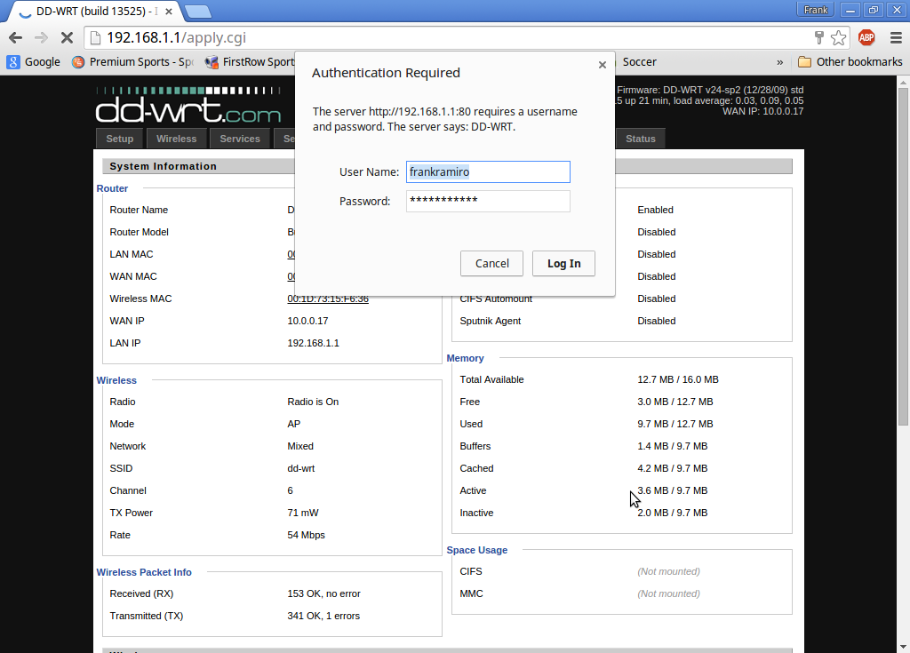

                        here a Screenshot of DOS,disregard ''upload'' after ''frank''
                        http://postimg.org/image/588wn31y7/61443153/
                            You forgot the hyphen ("-") before the i. Should be tftp -i not tftp i.
                            Also, pay attention to the instructions. There is only a small window of time when the router is starting up when it will accept the new firmware. It's a little tricky. If you can have someone helping you, it would be ideal. One person plugs in the router, and one person has the command all ready and typed out, and presses enter immediately after the router is plugged in.
                            Also, use this link, this is the newest version of Tomato for your router. I just flashed it to my WHR-HP-G54 as I show in the picture, and it works perfectly:

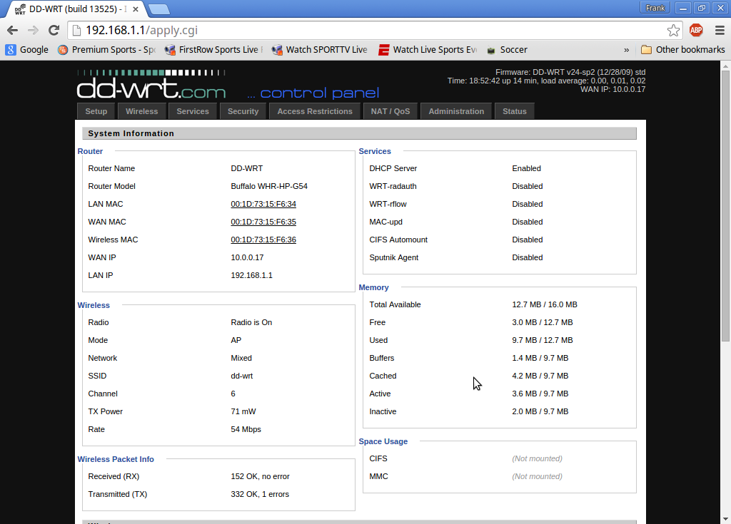

                              Thanks Steve; it looks like your way is easier;
                              i entered DD-WRT control Panel but via wireless, cause via Lan it doesn't enter.

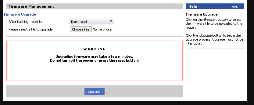

                              so i'm in the firmware upgrade menu Dos WRT
                              i put in the 24-mini.trx.
                              it it sais after flashing reset to and in the box it says "don't reset"
                              please select file to upload
                              Reset to default settings
                              do i till have to push the reset button and unplug power?if so how

                                Set it to reset after flashing, click flash...

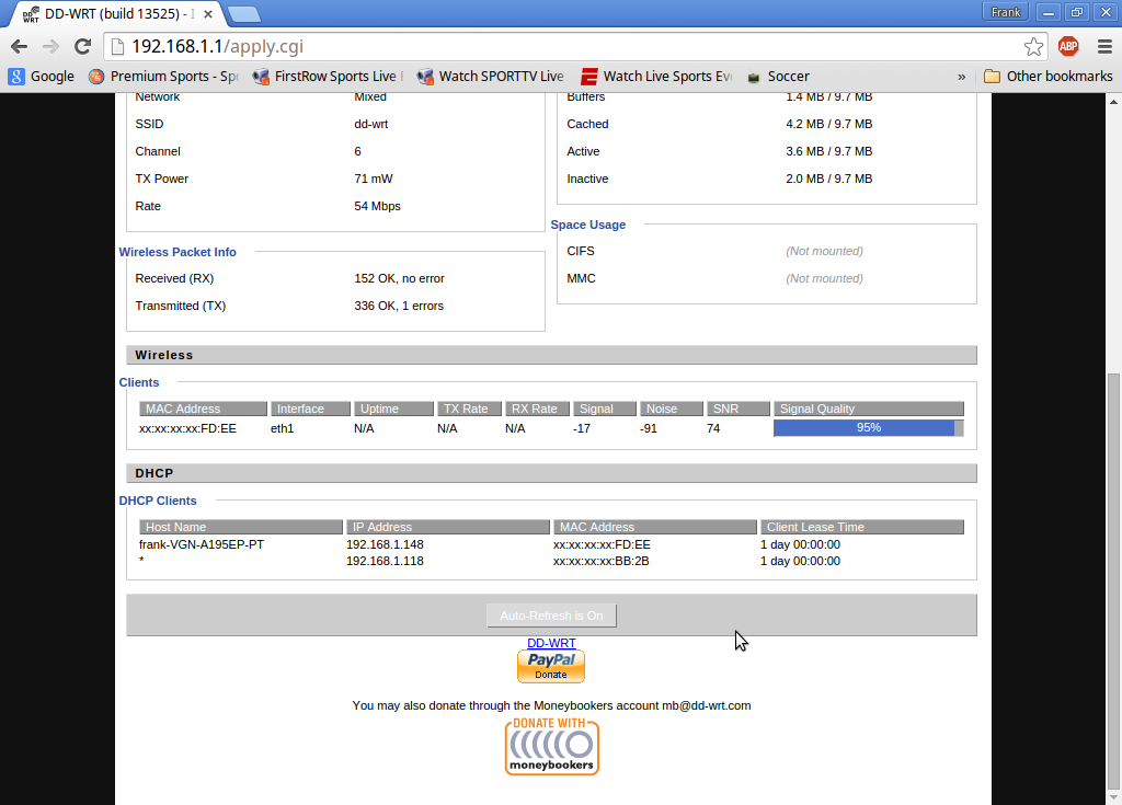

                                  So at the moment you have a Sony laptop connected on wireless, but if you plug in a pc/laptop using an ethernet cable then it's not connecting ?
                                  Your WAN cable is the one going from this Buffalo to your gateway.
                                  The many asterisks is a security feature, it's the same length however long your password is.
                                  The security tab is where you will find the security settings.
                                  LOL, seems whilst i've been typing this and getting distracted you've changed the firmware.

                                    In DD-WRT choose reset defaults, if it doesn't automatically reboot the router then yes you need to manually restart it. Probably a 30 sec power cycle will suffice, if not then a 30/30/30 reset.

                                      thanks mockingbird; it does't offer reset after flash!
                                      it offer; Do Not Reset
                                      or Reset to Default Settings
                                      choose file
                                        i think he is seeing something like this.
