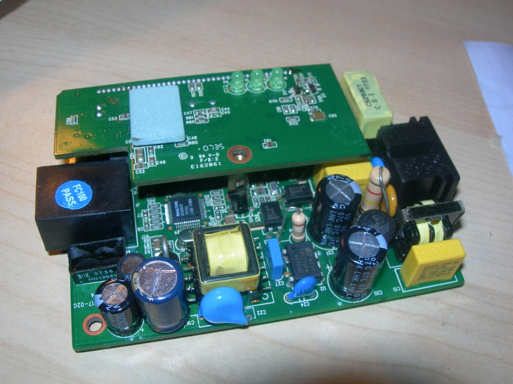

    I was given two of them, new in the box, for my own uses. I use them to connect my upstairs computer to our downstairs network; it removes the hassle of having to run a wire upstairs or use wifi, which never worked well. There are a pair of adapters, they connect to each other. I'm told you can also expand the network and add as many adapters as you like but I haven't tried it.

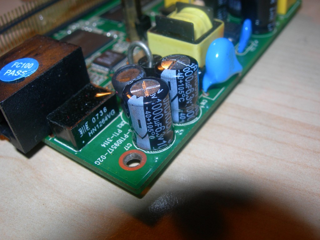

    They worked well themselves... until 3 months after owning one, it just stopped. Died. Nothing. No power indicator, not recognised as an ethernet adapter, etc.
    Open it up and lo and behold a bad cap. Order replacement cap, replaced it. Works great.

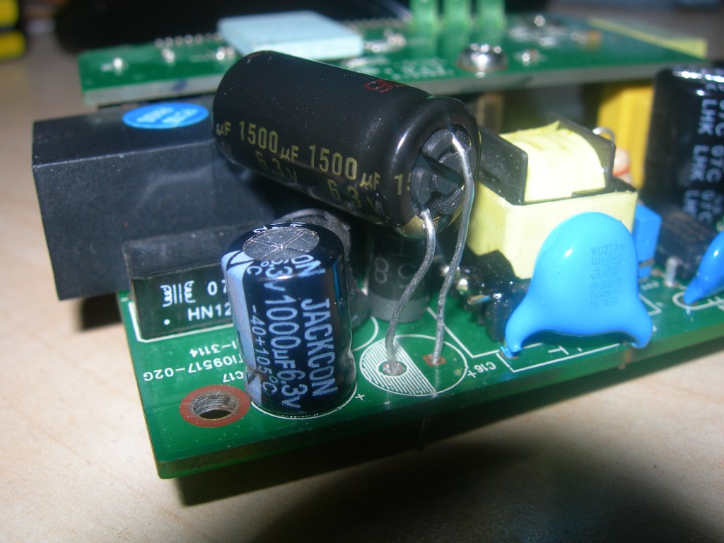

    Then 2 months later (so 5 months total), the other one died... with the same symptoms and the same cap. Replaced that one too, but I used some 1500u 6.3V motherboard caps, instead of the 1000u 10V cap I replace the 1000u 6.3V original with, because I was in a rush. But it didn't fit, so I mounted it horizontally . The original cap is a cheap Jackcon capacitor in both units.
    Both are in good working order now.
    But what pisses me off is that these adapters died so quickly. Obviously I knew how to fix them but it is just plain poor design. And not everyone knows how to fix things. A few more items saved from landfill, but it's a losing battle.

        I recommend replacing the capacitor next to the bulged unit as well.
          Re: Advent Powerline Ethernet Adapters
          It's part of a pi filter but it's not subject to anywhere near the same amount of ripple so I left it in for now.

            These things blow their power supply capacitors and you can probably get the power supply fixed by replacing them. They fail by the hundreds, sometimes after a month or two. The overall quality of these things is terrible, they get hot and I hesitate to use them because of the possibility of melting the plastic container and worse. Wireless is the best way.

              Agree 100%. They run at 75°C on the case - insanely hot. No wonder the 85°C caps popped. At such a temperature they cannot be energy efficient. However, the wifi in my room is really poor so I had no other choice, really...

                recap now with quality parts or do it again very soon.
                a neighbor has a set of these.every lytic in them was baked dry or popped.their cat rests its head on the things for the heat.edit.forgot to note these things are turning a brownish yellow.they were a bright white when i first saw them.were brought home from somewhere in uk.sold in the px.

                          I simply upgraded the two 1000uf 6.3v and the two 4.7uf 400v with superior Panasonic equivalents (but 105C rated). Worked a treat since!
                          Only other component to fail in these units is the IC TNY276PN which can be replaced, though a tad trickier to solder due to the 8 pins being close together.
