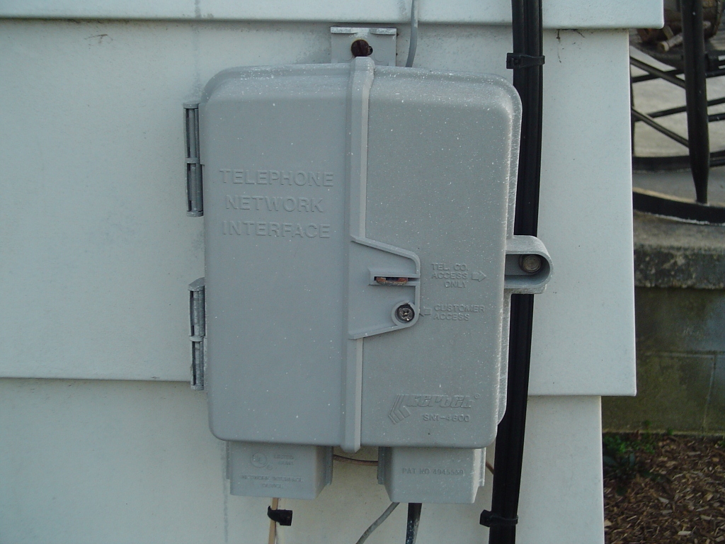

                            • delaware74b
                              • Apr 2009
                              • 628
                              Re: New modem router combo
                              Here, in the US, we have what is called a demarc (demarcation box). The phone company is responsible to the demarc and is also responsible for the demarc itself. There are 'maintenance agreements' available through the phone company for those who can't or don't want to maintain their own interior wiring. The demarcs in the US also have a test jack where you disconnect all interior wiring and connect a test phone (or you dsl modem)
                              With that said, do you have a demarc or something similar in Australia? If you do, I'd try connecting your DSL modem directly to the demarc with your interior wiring disconnected.
                              Personally, if interior wiring is over 10 years old, I replace it with cat5. Cat5 is overkill for voice, but the twisting in the cable rejects a lot more interference and ac hum than the old 4-conductor phone cable. Also, if your phone cables run parallel to any ac wiring, try to maintain 6" minimum distance.

                              • stevo1210
                                • Oct 2006
                                • 4156
                                we dont have demarcs here, unless you are with a company called optus, which runs thier cables in the air instead of the ground. They use cable (as in cable internet cable) for telephone wiring and not plain old copper wiring, then from there, it splits out to the normal copper phone wiring.
                                I'm not sure how my house (and grandparents house) works, but phone wiring goes underground and comes out of a socket, and from there it goes everywhere.
