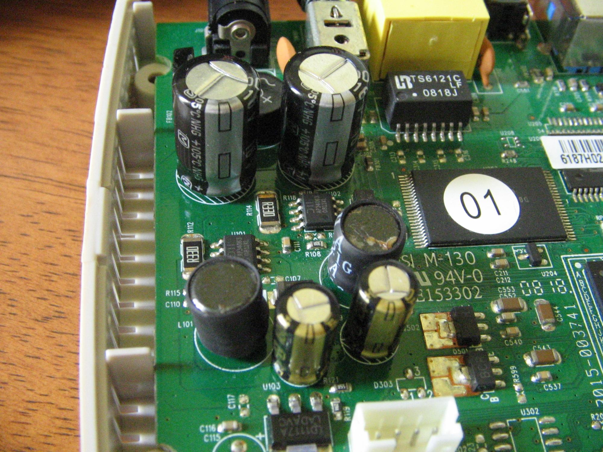

    I need some help with replacement capacitors for my ADSL Router.
    It's a Dynalink RTA1320 - and none of the capacitors match anything on the datasheets
    It's got:
    2x G-Luxon SM Series 1000uF 25v
    2x Ost RLK Series 200uF 10v
    1x G-Luxon LZ Series 47uF 25v
    The RLK and LZ don't appear on the datasheets in those values.
    The SM appears in the value, but in a bigger size.
    As such, I guess they are all cusom jobs and therefore I don't know what their specifications are.
    The Ost and G-Luxon LZ are slightly bulging, but the SM are OK. The are just after the bridge rectifier and so I guess they have a fairly easy job. I still would rather replace them, though.

    Well, you already know the voltage and capacitance since they're printed on the capacitor. That leaves you wanting to figure out the ripple and ESR.
    Within *the same series* ripple current and ESR are dependent on the can size. So, measure the SM to get its size - diameter and height. Find something in the SM datasheet that is the same physical size, and that will tell you the ripple and ESR of your capacitor. If you can't find the exact size, you can find close sizes and interpolate a bit. Repeat for the other series.

                  The two OST look like they are already gone.
                  Derating voltage is good if you know the limits. Measure the working voltage of the rest and derate. This gets you into better ESR and easier to get capacitors. I'd rather have a pair of super low ESR 560uf, 680uf, or 820uf capacitors instead of those high ESR OST.
