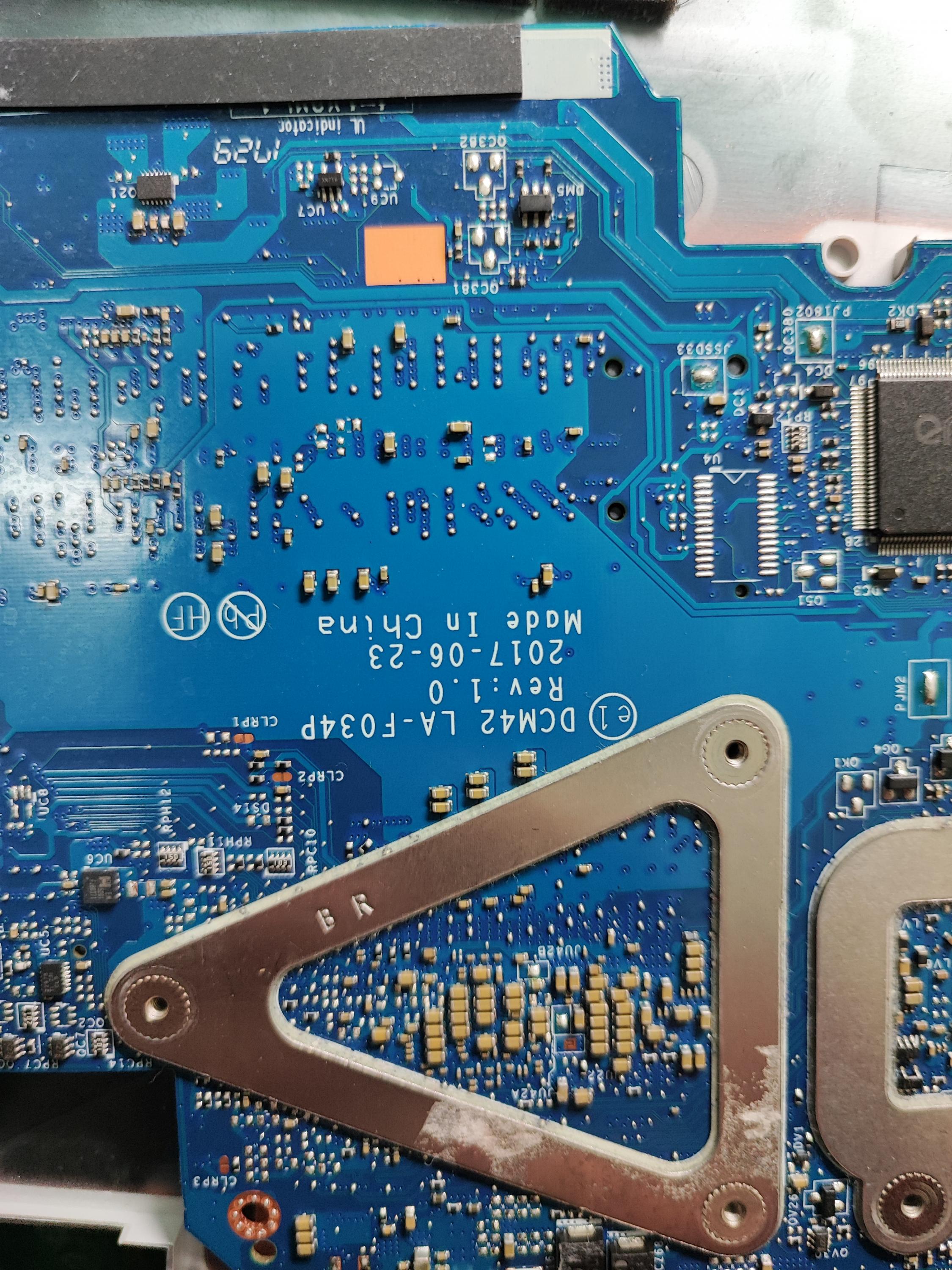

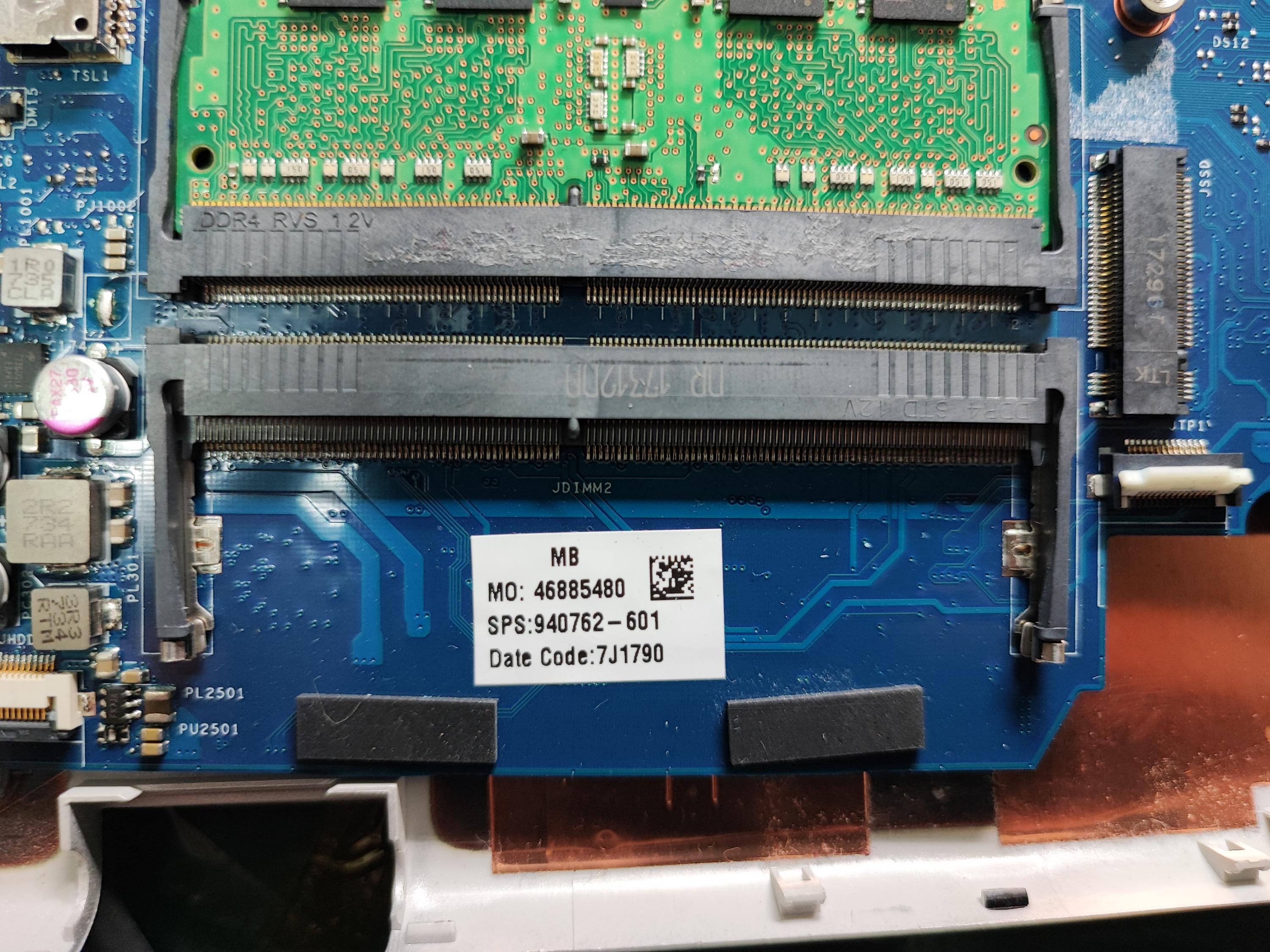

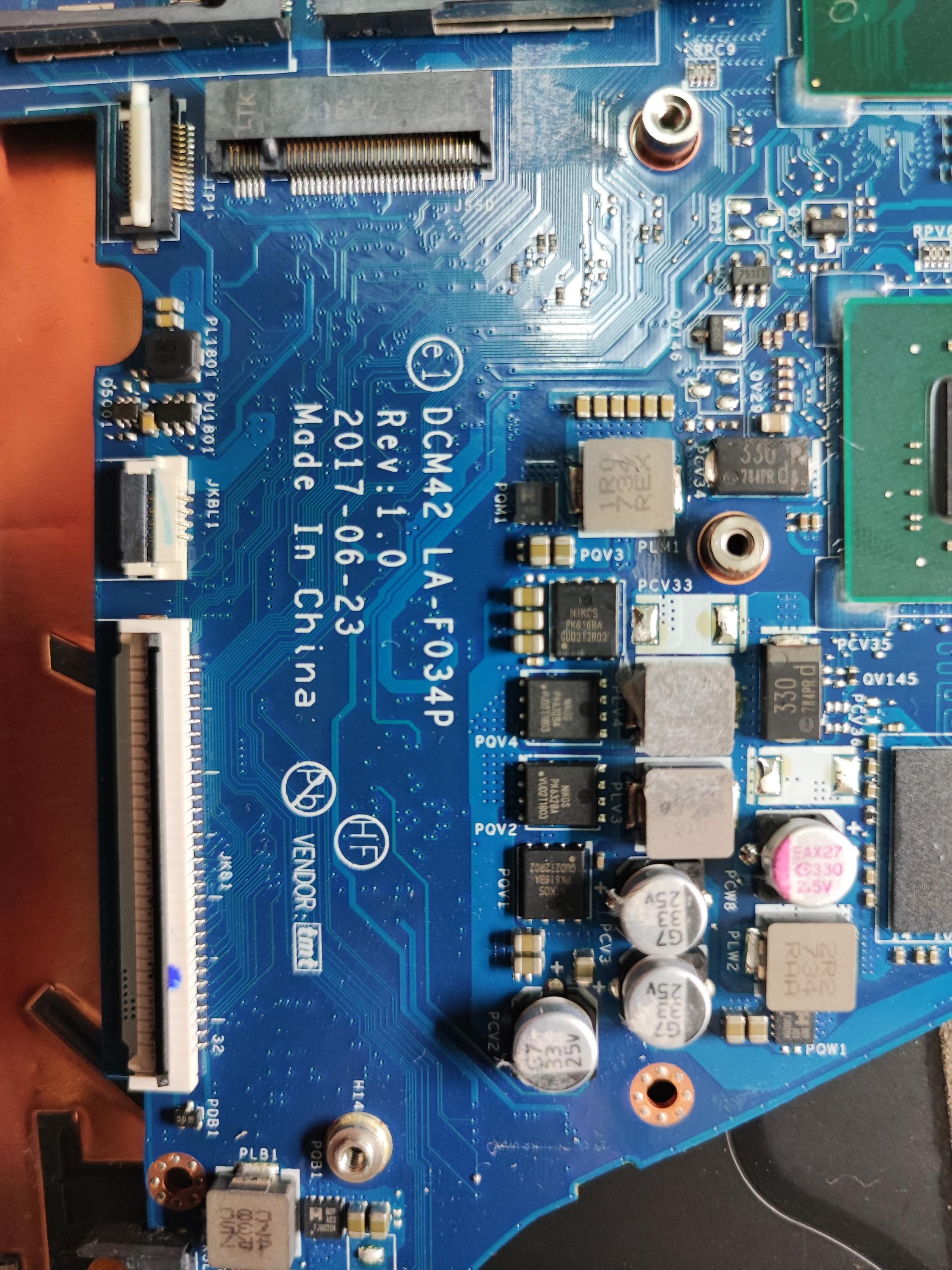

hp pavilion 14-bf153sa la-f034p schmeatics if exist please
  • darckreign1984
    • 260
    • Romania

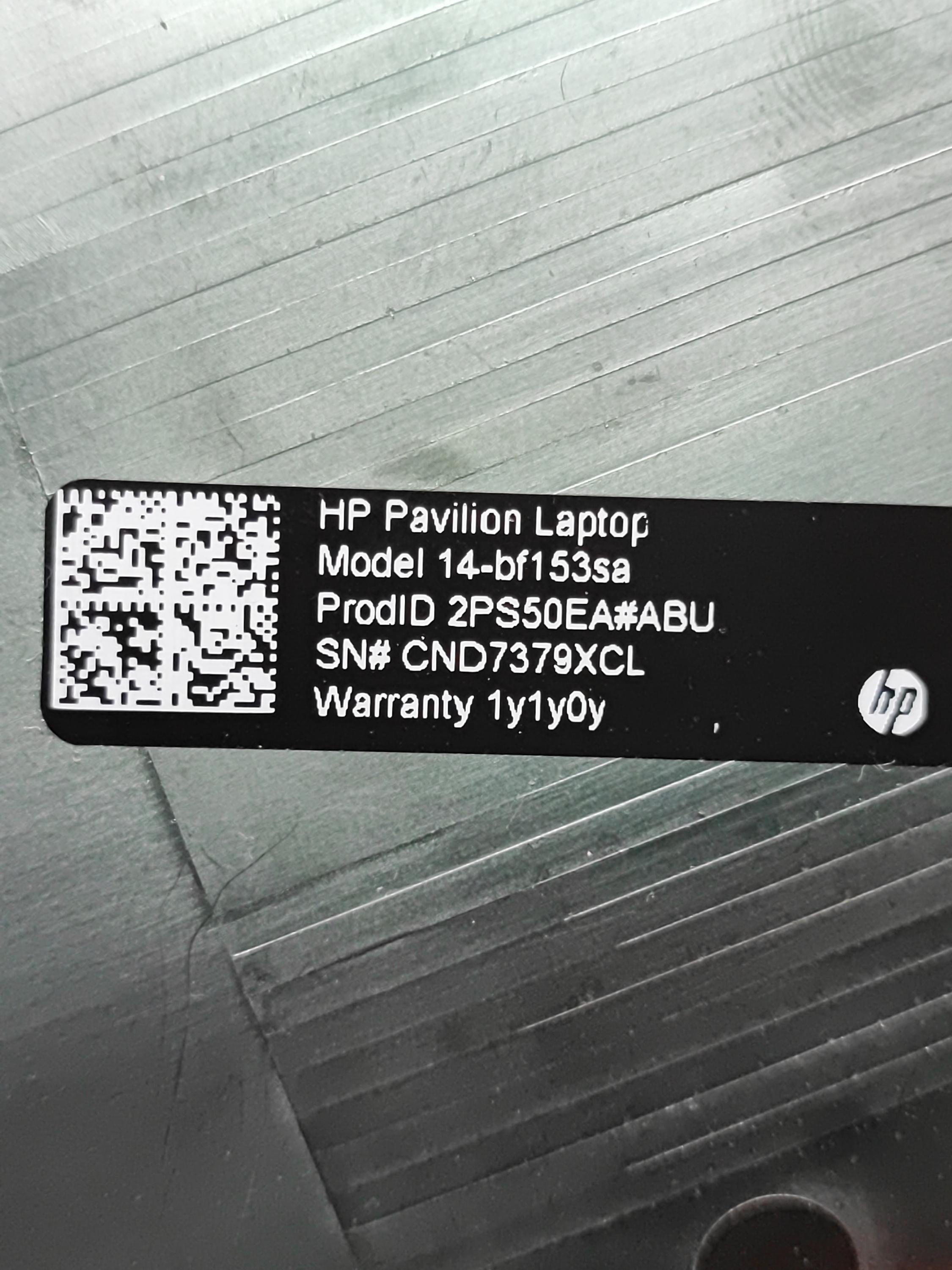

    proid 2ps50ea#abu
    sn# CND7379XCL
    the laptop charge, no start, an d bios dont have 3.3v
    thanks in advance

      Re: hp pavilion 14-bf153sa la-f034p schmeatics if exist please
      solution:
      -i discover that power connector - from inside laptop have brocken data pin and was shorted .
      tested some bioses, replaced ite, replaced bios chip reprogramed, - then i put back original ite - and laptop started.
      - i dont know exatly what was happening, i am glad that its working
