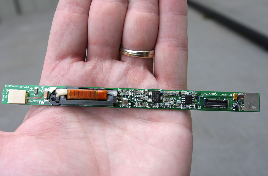

                Hi. Thanx for guides, here is link to pics of inverter.
                http://s781.photobucket.com/user/bez...brary/inverter

                  Re: Laptop inverter
                  is your screen completely dim? therefore with no backlight? if you want a schematic try to take the datasheet of the IC, there's maybe an example as usual..

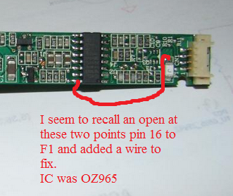

                      Re: Laptop inverter
                      Is the ic OZ965?
                      I believe you should see continuity at pin 16 and fuse F1

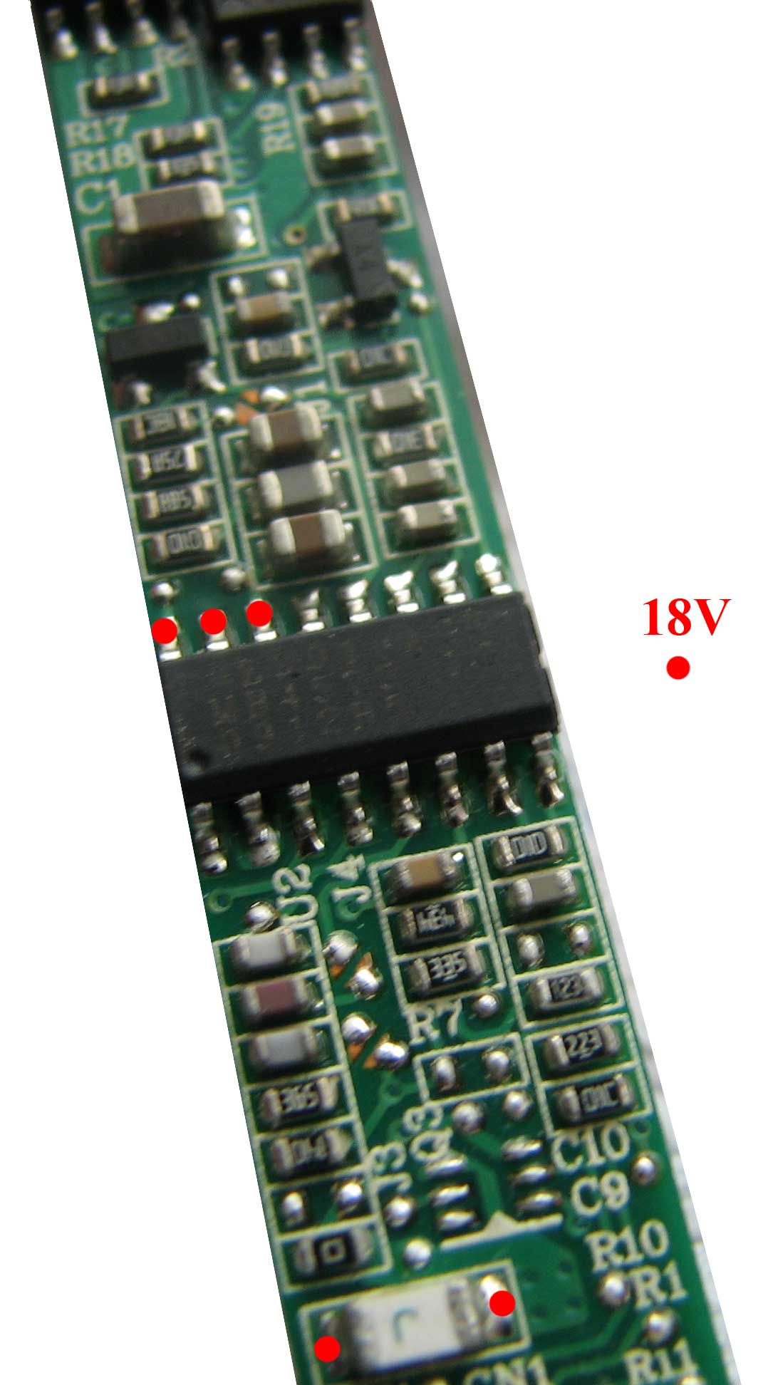

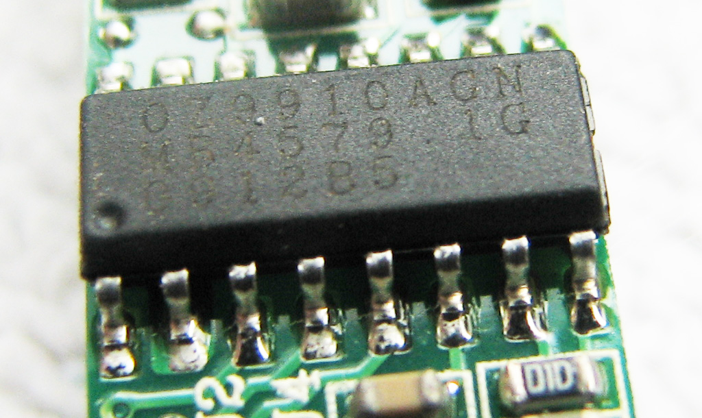

                        Re: Laptop inverter
                        Hi I check that pin and got 18v there, but I got 0Z991
                        must find datasheet for that
                        • primoz1
                          • Oct 2010
                          • 270
                          • Italy-Slovenia
                          Re: Laptop inverter
                          This is only what I found in free web area.
                          can someone confirm if pins are equal like 0Z9910AGN ?
                          thank you

                            Re: Laptop inverter
                            smason
                            Can you get more photos? What are IC's?
                            Continuity for fuse F1 and from F1 to U1 and U2 -at least one pin?
                            primoz1
                            Use your ohm meter as budm said "...use Ohm meter to trace out the B+".
                            Pin 14 to the fuse.
                            The IC is turned off and with a high impedance you will see 18v.
                            Pins 2 and 4 test continuity to only one pin of connector CN1
