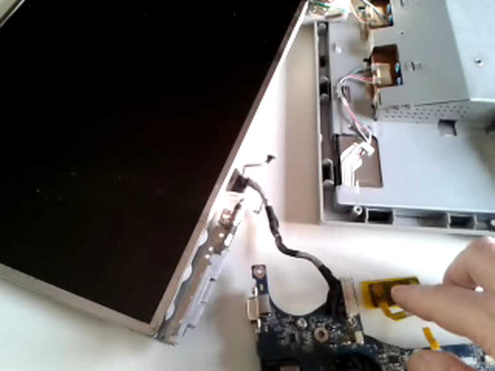

Laptop inverter
  • primoz1
    • Oct 2010
    • 270
    • Italy-Slovenia
    Re: Laptop inverter
    I start Up CCFL with external LCD power and work.
    http://tinypic.com/r/ak79jp/5
    • Davi.p
      Hobbist Tech
      • Sep 2009
      • 4289
      • Italy - Milan
      Re: Laptop inverter
      I need to know 1 thing, you changed 3 screens, from where do you get them? Used with no warranty formula? Sold as "to be tested"? Maybe all 3 had faulty lamps?
      • primoz1
        • Oct 2010
        • 270
        • Italy-Slovenia
        Re: Laptop inverter
        I got all 3 working on other toshiba same model, but on this unit I reball North Bridge 2 times, and not help, so Im allmost 100% that NB is faulty (not total dead) enough to work on external LCD and If you see that movie work on primary too if I help with other inverter.
        Because I must wait too long time to new NB arrive from china I got idea to Light Up somehow that CCFL and laptop may be in use, meantime I wait new chip.
        • Davi.p
          Hobbist Tech
          • Sep 2009
          • 4289
          • Italy - Milan
          Re: Laptop inverter
          I think the only way to bypass is to find out on the mobo a 3,3v, it's surely present, search it on + mark side of tantalum caps in the DC-DC converters area, or the leg of a big inductor connected to a cap, then you feed it through a resistor (sorry, don't know the value, ask members for an hint, 1kohm is good?) into the ENA pin and also the DIM, in that way you will have a near full brightness screen, if you don't want it you can use a voltage divider with 2 resistor, so the 3,3v---R1=?----R2=?--DIM-PIN---R3=?---GND..
          R2=33 (or 330) R3=100 (or 1k) for a minimum bright. R2=39 (or 390) R3=100 (1k) for a medium bright. Am i wrong?
