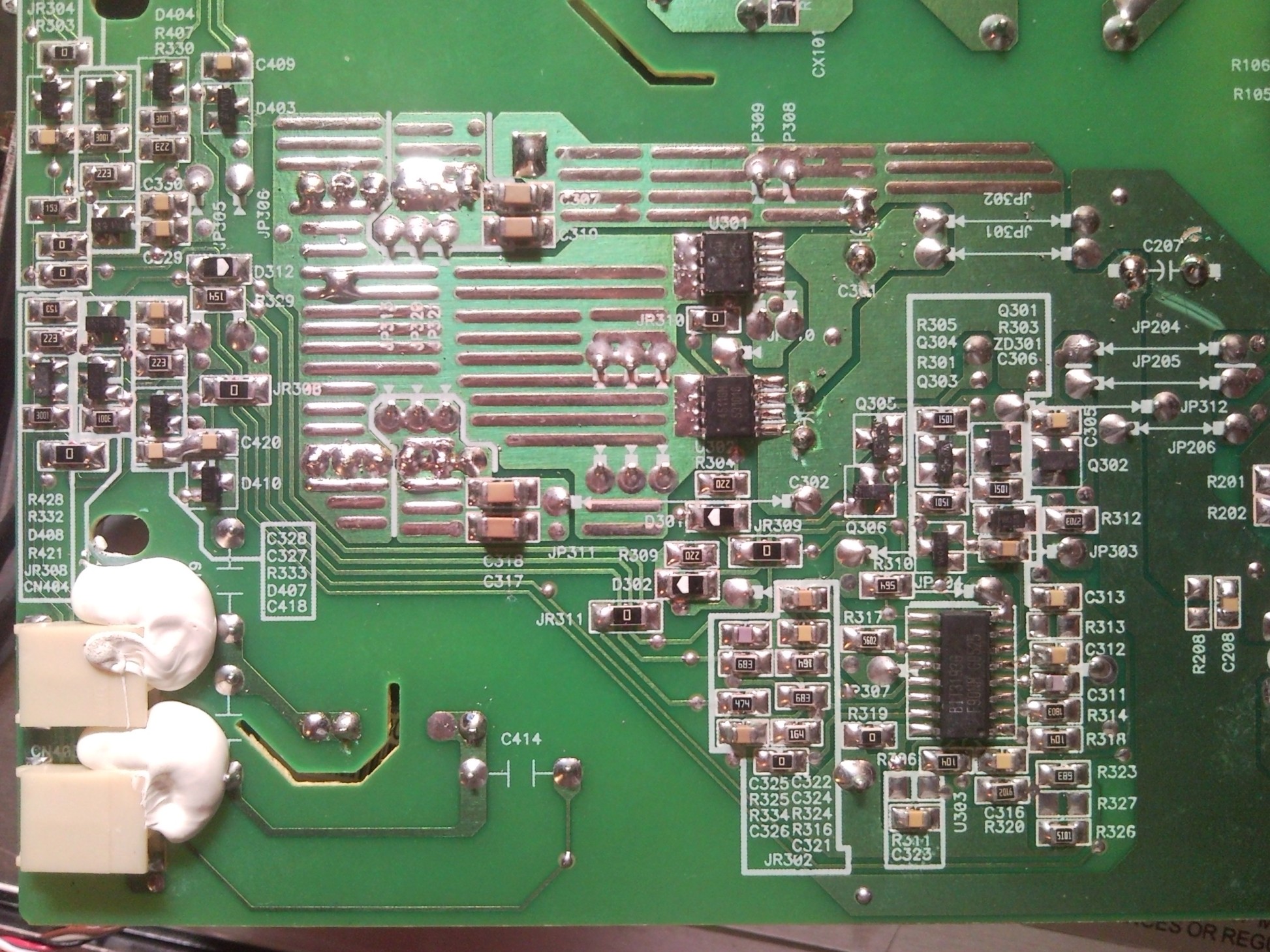

    The backlights on the monitor will not come on. Not even flicker! I do see the image on the lcd with a flashlight, so that part seems ok.
    I checked the caps in the inverter area with an esr meter, dropping some off the board just to make sure, and they all tested fine. I am getting 3v from the logic board for the ON to the inverter side. Is that high enough?
    With it powered on, I checked voltage at the inverter transformers. Nothing on the secondary side of either one. On the primary side, I get 12v when I turn it on, and it immediately begins trailing down to almost 0v over about a minute or so.
    I tried plugging in other ccfl's, but no change. I removed the two transformers and tested them with ring tester, and they showed ok (2 yellow lights on the Blue ring tester). I looked for a fuse but couldn't find anything on that part of the board. I am stumped!

    Good pictures, thanks. A couple of points to check. What is the voltage across C207? Many of the pins on U301 and U302 are common. The pins are numbered counter clockwise from the lower right corner. I believe 2-4 are connected together and 5-8 are connected together. Check for shorts between 1 and 2, 1 and 8, and 2 and 8 of each IC.
    Also, what is the voltage between pin 6 and pin 7?
        17.08V
        I get the same readings on each IC, with meter set to 200k:
        Black probe to 1/Red probe to 2: 127
        Red probe to 1/Black probe to 2: 136
        1 and 8: discharge and then charge up to 1, and then repeat the process when I swap the black and red probes. 2 and 8 does the same.
        Not sure what you mean, as I think pins 5-8 are soldered together - are you still referring to U301/2?
        I did check voltage on U301/2 with it powered on:
        1 = 0v
        2 = 7.5v
        3 = 17v
        4 = 16.5v
        5-8 = 0v
        (the first time I tested the voltage it was lower: 0, 1.76v, 16.3v, 15.8v on pins 1-4. I turned it off/on and tested it several times more and got the voltages above...)

          Sorry, my mistake. I meant the voltage between pins 6 and 7 of U303 - the inverter controller.
          U301 is a power FET in an 8 pin package.

                I have just gotten back to this one. Since most of PlainBill's questions centered around the area before the mosfets I have decided to keep working in that direction. Attached is a datasheet for the inverter controller. Here are the readings from the pins on the controller:
                pin# - power off - power on
                1/INN - 0 - 1.28vdc
                2/CMP - 0 - 4.44
                3/LOAD - 0 - .7
                4/CTOSC - 0 - 1.4
                5/TIMER - 0 - 3.94
                6/ONOFF - .11 - 3.7
                7/GND - 0 - 0
                8/NOUT2 - .15 - 0
                9/NOUT1 - .25 - 7.56
                10/VDD - .25 - 7.57
                11/PWMOUT - 0 - 2.02
                12/CTPWM - .01 - 1.8
                13/PWMDC - .78 - 1.5
                14/CLAMP - 0 - 0
                15/ISEN - .04 - .4
                16/MODSEL - 0 - 0
                I saw another post that said if pin 15 is below 1.3Vdc an error signal is set - which it is, and if pin 5 is greater than 2.5Vdc - which it is, the outputs are shut down.
                I tried testing the transistors in that area, and only 1 or 2 of them tested normal, but I did not remove any of them from the board yet. None of them seemed to be shorted completely out.
                Next I tested the resistors without removing, and below are some unexpected readings:
                R312 - 2703 - 90kohm (dmm set at 200k unless noted)
                R306 - 104 - 87.3kohm
                R310 - 564 - 171.3kohm
                R334 - 474 - .391 with dmm at 2M
                r325 - 683 - 50.1kohm
                R324 - 164 - 88.2kohm
                R316 - 683 - 52.4kohm
                C321 - 164 - 73kohm (notice the marking on the board is "C"321, not "R"321)
                R309 & R304 - 220 - 1.0 with dmm at 200M
                I must admit I am puzzled by the C321 with a resistor in place. It does not appear to have been replaced, unless the tech did an awesome job of soldering.
                I also removed the inverter transformers and tested with ring tester. The meter only showed 1 or 2 yellow lights for both primary and secondary on both transformers.
                Once again I have exhausted my limited knowledge...

                  You've done some good work, the problem is trying to figure out what is going wrong. This would take less than 15 minutes with an oscilloscope. Without one, I'm trying to figure out some practical tests.
                  Pins 8 and 9 are the outputs that drive U301 and U302. They are turned on alternately, with a 'dead' time between on times (so they will never be on at the same time). They will go active for about two seconds (maybe less) whenever the power light is turned on.
                  If I follow this correctly, the signal from pin 9 of U303 goes under R310, through JR309 to the cathode of D301, to the left end of R304, then from the right end of R304 to either pin 2 or pin 4 of U302 and U301. Please verify.
                  Now the drive for the other pair of pins had me scratching my head. It appears it is routed through Q303, Q304, Q305, and Q306. Check those transistors, please.

                        Good work. I suspect the purpose of that circuit is level shifting of the gate signals to the mosfets. Fortunately, I just realized a functional test is easy.
                        You will be working on your choice of U301 or U302. The test is simple. With the monitor plugged in press the power button until the LED turns off. Measure the voltage from pin 2 of U301 or U302 to ground. Press the power button. The power LED should turn green. Does the voltage on pin 2 change? Repeat the test for pin 4 of U301 or U301. Now place the probe on pin 5 of U301 or U302 and repeat the test. Does the voltage change?
                        I'm not sure if you want an explanation, but you are going to get one. In standby one output pin of U303 will be at 7.5 volts, the other at 0 volts When you press to power button the outputs of IC301 switch fro. When the inverter controller is active the output pins will be switching from 0 volts to about 7.5 volts. This will be reflected on the output pins of U301 and U302.

                                Here's the problem in a nutshell. These two guys alternately pull a line down to Gnd, then up to 17 volts. That line is connected to one end of the primary windings of the inverter transformers. The other end of the primary windings are tied to ground.
                                The inverter controller APPEARS to be putting out a drive signal. That signal appears to be reaching the gates on these FETs. There is no action on the output line. Now, if the drive waveform did not go high enough to turn on either the P or N channel, that is exactly what we would see. With an oscilloscope I could see the waveform. Without it, I'm pretty much blind.
                                Oh, good grief!!! Sometimes I'm so blind I wonder I can find my ass with both hands!!!
                                This test will require a small ceramic cap - anywhere from .001 to 1.0uF. Something from a junk box or Radio Shack will be fine. Hook one lead of the cap to the + lead of your DMM. The other lead will be the probe. We want to eliminate DC bias. Hook the - lead to ground. Set the DMM to the 20VAC range. It is NOT necessary to reinstall those two ICs.
                                Plug in the monitor. Now probe the pad for pin 2 of either U301 or U302 while cycling the power button. Repeat for pin 4. What voltages did you see?

                                        Re: 700G no backlights
                                        Originally posted by PlainBill View Post
                                        Excellent!!! That shouldn't be enough voltage swing to trigger the FETs. Now check pins 8 and 9 of the inverter controller.
                                        PlainBill
                                        You are easily excited...
                                        Pin 8 reads .33 off, about 4 seconds after turning on it drops down to around .002 and then goes back up to .33 and remains when lcd goes into standby.
                                        Pin 9 reads .03 off, about 4 seconds after turning on it jumps up to as high as 1.74 (did it several times) then drops back down to .03 and remains there.
