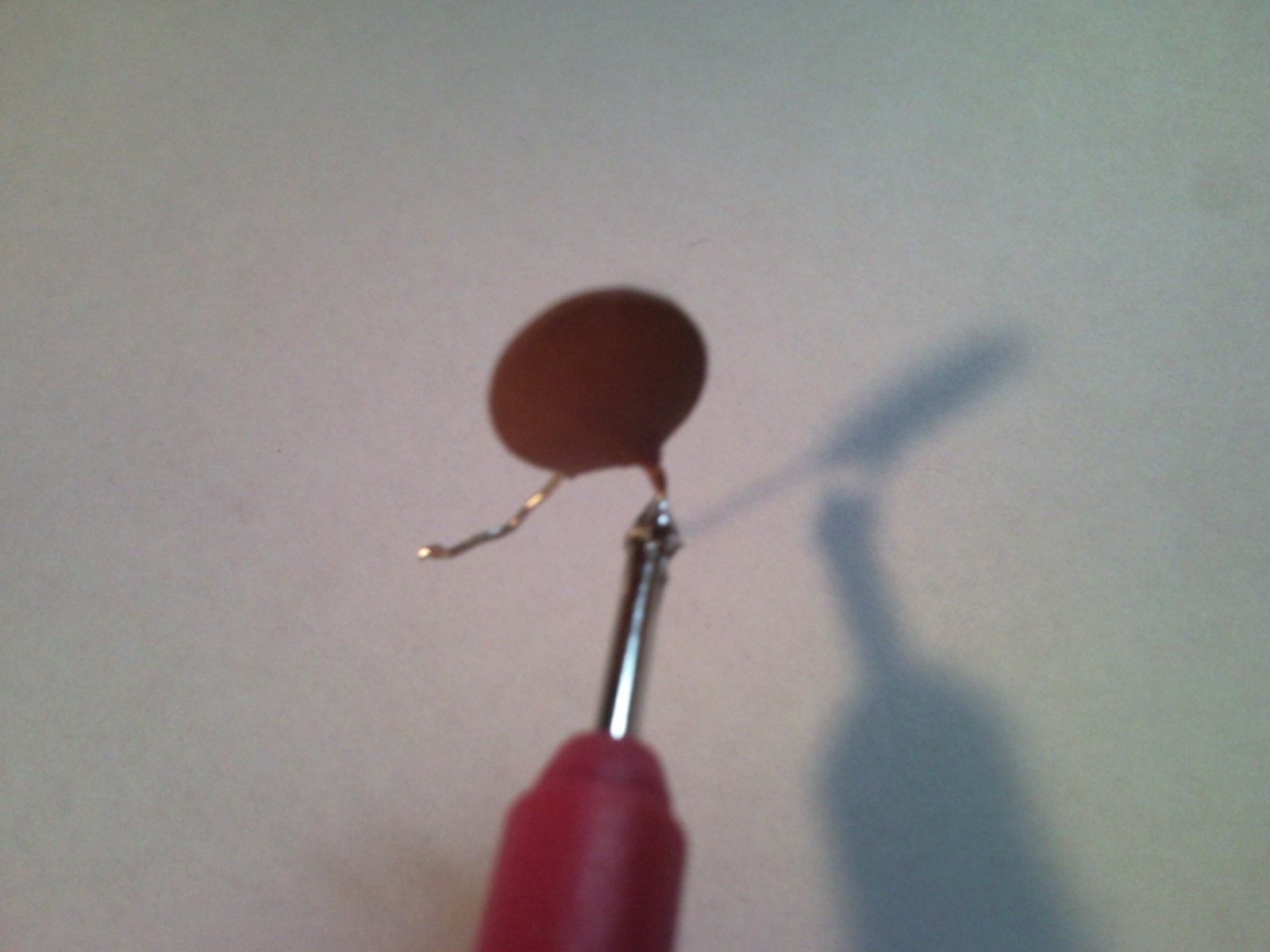

    Is that using the capacitor and with the DMM on the 20V AC range?

      I can tell that is not what you expected, so I did it again. The meter is set the same as when testing the MOSFETs. Same results. I attached a pic of my tester in case I did not get your instructions right.

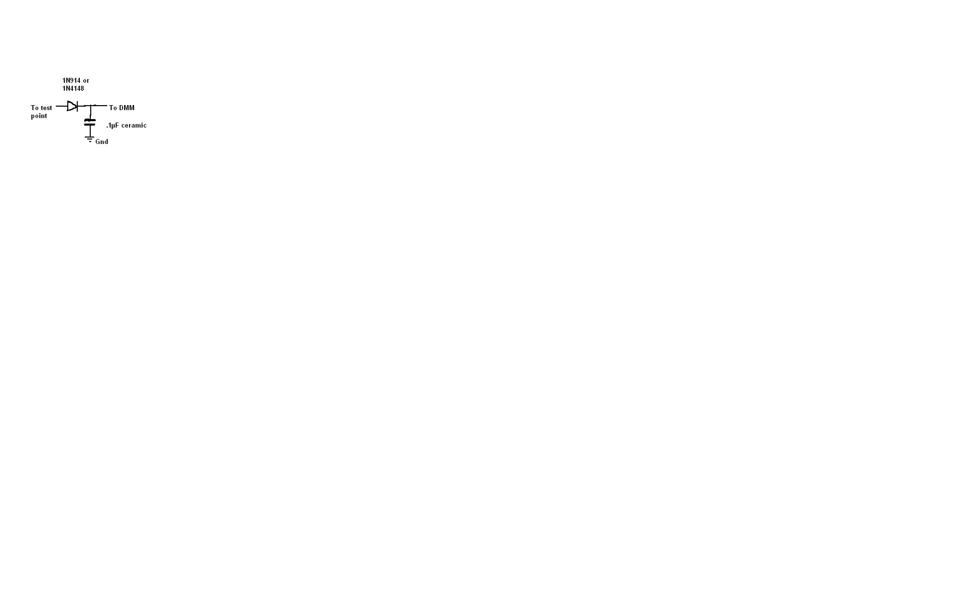

        You learn very well, Grasshopper. While I'm not absolutely sure that your DMM is ''fast" enough to read that frequency, I'd have to say evidence is pointing to a defective BIT3193. If you want to be super secure before ordering one, I've sketched a 'peak voltage adapter' that will determine the peak voltage pins 8 and 9 of the BIT9139 reach.
