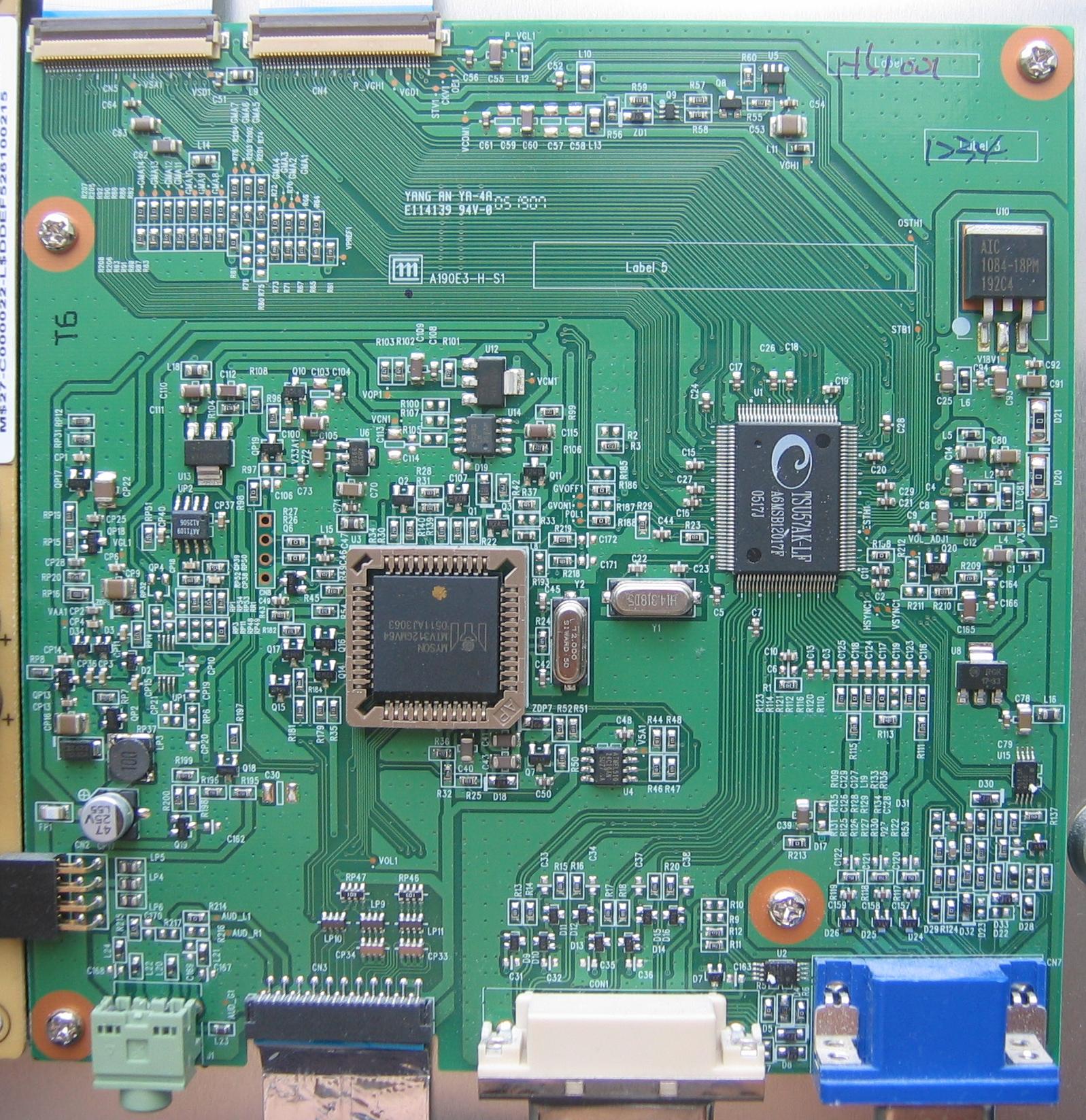

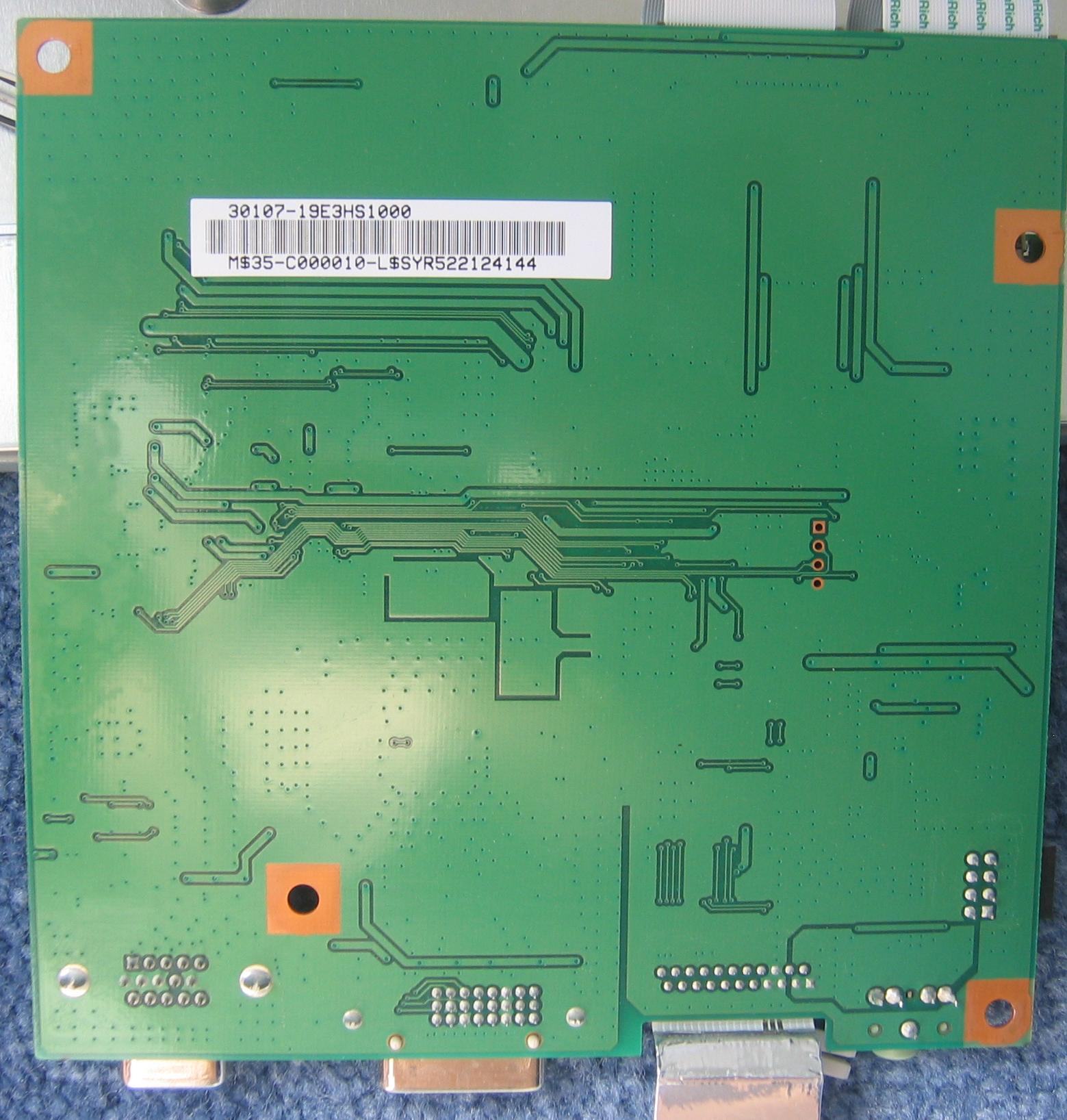

    This is a CMV CT-934D made in 2004 LCD. It won't power on. The power LED does not turn green.
    THINGS TESTED
    1) Measured steady 164V DC across main filter capacitor.
    2) With the power board ONLY (i.e. logic board is disconnected), the secondary voltages 19V and 5V DC are present at connector location CN100. The 19V and 5V DC voltages are steady and do no fluctuate.
    3) Fuse FP1 on logic board reads 0.3 ohms.
    4) All connectors from power board connector CN100 to logic board location CN2 read 0.3 ohms. That is, the connectors are fine.
    PROBLEM
    1) Press the power button and the power LED does not come on.
    2) When the logic board is connected to the power board, the voltages found at CN100 disappear. The 5V DC disappears immediately. The 19V DC drops slowly from 19V to 0V. I can see the voltage dropping on the multimeter. It drops about 1V every 5 or 10 seconds. The voltages at CN2 on the logic board show the exact same behaviour as CN100 (drop and disappear).
    QUESTION
    What could cause the secondary voltages to drop/disappear when the logic board is connected to the power board? When the logic card is disconnected, the secondary voltages are solid and steady on the power board.

    Probably a short on the 5V rail on the logic card. Most monitor power supplies use a transformer with three secondary windings. One secondary (I often refer to it as a tertiary winding) powers the SMPS controller. Another is rectified to provide 5 volts. The last winding is rectified to provide the inverter voltage - anywhere from 12 to 20 volts, depending on design. On an SMPS design with current limiting on the primary an excessive load on a secondary will cause the SMPS to shut down. Because there is very little load on the 19V supply, it's voltage drops slowly.
    Now you have the fun of locating the short on the logic card. I would suggest investigating the four voltage regulators, U8, U10, U12, U13. If it turns out I am wrong (it happens) and there is no short, investigate the small capacitor in the SMPS primary.
    Edit: Interesting, I just noticed there are TWO optoisolators on the power supply. How interesting. What, pray tell is U101 on the power supply?

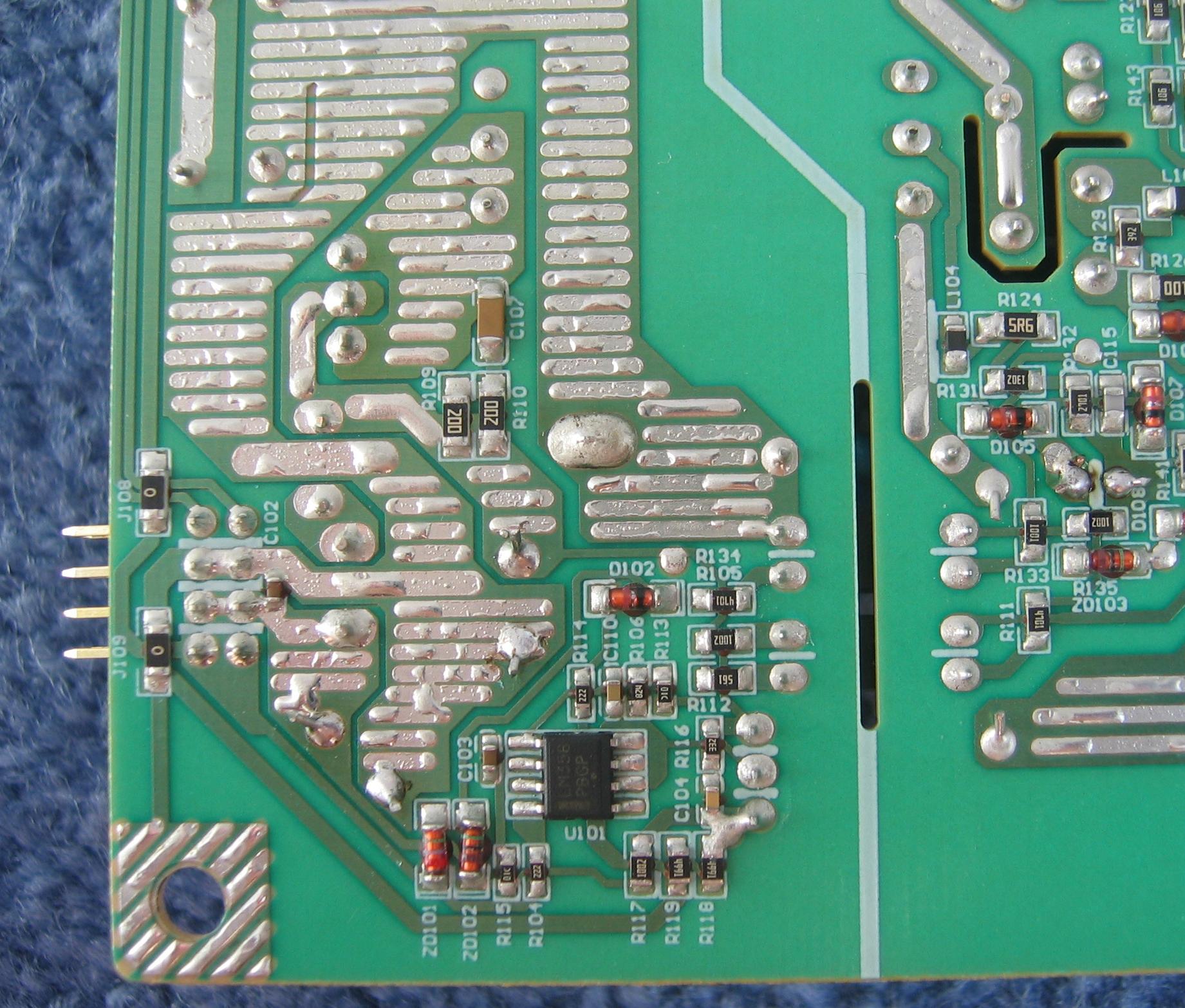

      I measured the ohms on U8, U10, U12, and U13. U10 with red on pin 1 and black on pin 2 measured 146 ohm (I measured this 4 times). All other voltage regulators readings were well over 800 ohms.
      Pin 3 of U8 and U10 are tied to the 5V rail. I figured this out by using the continuity beep test by probing around.
      On the CN110 connector (read vertical down), the 2nd pin is GND, 3rd is 5V and last pin is 19V.
      The small cap at CE107 was the first thing I replaced when I didn't get secondary voltages (before I discovered it was stable without the logic card). The original cap was a Capxon 22uF 50V.
      I replaced it with a Samxon GK 22uF 25V. When I first replaced it, I didn't realize my mistake of substituting in a lower voltage cap. It wasn't until I went to write this response and checked the original cap that I had made this mistake.
      Anyways, I don't have a 22uF 50V spare. And I had the same problem of disappearing voltages before with the original Capxon cap. If I had to, I could try and see if one of my working boards has a 22uF 50V that I could borrow to figure this one out.
      U101 is LM358 PBGP. Datasheet is at
      http://www.datasheetcatalog.com/data.../5/LM358.shtml
      PS. I also changed out 2 caps that were rated 10V (all others are rated 25V), just to rule out bad caps on the 5V rail. I used Rubycon MCZ and Nichicon HN(M). Same problem with disappearing voltages.

        The lower voltage cap shouldn't be a problem. Many manufactures don't make 22uF caps in the lower voltages.
        On this one, I would suggest tracing the outputs of the two optoisolators. One should be used for feedback for voltage regulation. I just came across an application note that used a second optoisolator to shut down the SMPS controller.

            U100 and U103 (optoisolators) is part
            B T2
            PC617
            Sharp
            Pins 1 and 2 are on the secondary side. Pins 3 and 4 are on the live power side.
            I tested both with the diode functionality on pins 1 and 2 and got 1.04 in one direction and 0L in the other. Pins 3 and 4 give 0L in both directions.
            I measured ohms between pin 1 and 2 and they are not shorted. Same for pin 3 and 4.
            I'll do the trace.
            All the diodes on the back in that section test okay.
            ZD102 measures0.72 and 0L with the diode test.
            D102 measures 0.59 and 0L with the diode test.
            ZD101 measures 0.72 and 0L in the diode test.
