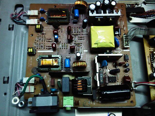

                            hi everyone , i had the same case as above is it be possible C913 is the cause of problem ? 0.0047 uf 250V capacitor
                            • Agent24
                              I see dead caps
                              • Oct 2007
                              • 4978
                              • New Zealand
                              Re: AOC LM725 Dead
                              I don't know. What makes you think it is C913?
                              What problems do you get with the monitor?
                              Please upload some photos too if you can.

                                Re: AOC LM725 Dead
                                Hi Agent 24
                                good day , the board look exactly like this below , the c913 is the blue capacitor between the yellow square transformer and the connector
                                yeah, i maybe wrong, just a rough guess , the main problem is there is no voltage output in the secondary winding
                                I checked the capacitor this morning, it appears ok, so right now, dont know where is the culprit
                                • jeromy
                                  • Jan 2017
                                  • 11
                                  • philippines
                                  Re: AOC LM725 Dead
                                  when you plug in the monitor, , its dead, no LED,
                                  there is no power output from the power supply board (5 , 12v 2.5 etc)
                                  when plugged in, the main filter capacitor read ard 340 Vdc
                                  • Agent24
                                    I see dead caps
                                    • Oct 2007
                                    • 4978
                                    • New Zealand
                                    Re: AOC LM725 Dead
                                    Does the supply make any noises? Like a ticking noise? Or completely dead?
                                    -David VanHorn
                                    • jeromy
                                      • Jan 2017
                                      • 11
                                      • philippines
                                      Re: AOC LM725 Dead
                                      no sound, working but no voltage output whatsoever in the secondary transformer winding , big filter capacitor is working ard 325 Vdc
                                        Re: AOC LM725 Dead
                                        Do you get any DCV output if the you run the power supply board by itself without other board connected to it?
                                        We need straight shot pictures of your board, top and bottom side of the board.
