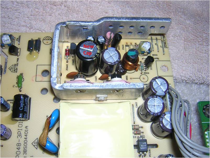

    I opened it up and found a 1000uf/10V bulging. Replaced cap with a new one 1000uf/25V. Put monitor back together and powered it up. Still the same thing.......2 to 4 seconds on and then off.
    What i have done:
    1- replaced bulging cap. No change.

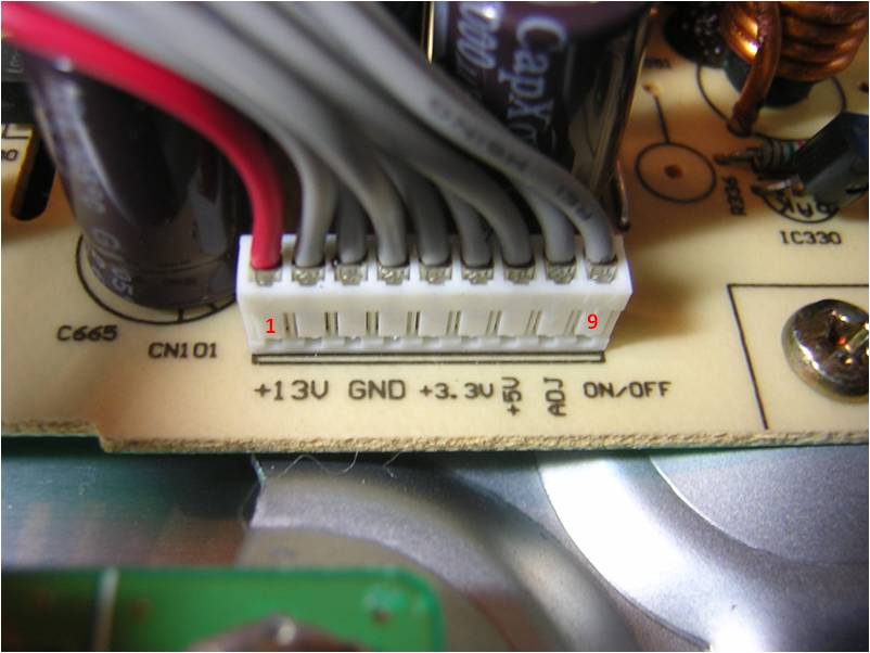

    3-Measured voltages at connector (see enclosed pic of connector):
    Pin1=>13v when off. When on ~14V and then when shuts down voltage goes to 12.6V
    Pin2=>13v when off. When on ~14V and then when shuts down voltage goes to 12.6V
    Pin3=>0V
    Pin4=>0V
    Pin5=>0V
    Pin6=>0V
    Pin7=>4.96V
    Pin8=>0.138V
    Pin9=>when off ....0V.........when on....2.72V.
    Note: See connector pic.......i dont seem to measure the 3.3V.

    If there's one failed/bulged cap, then the rest are probably not far behind. I see that you have CapXon caps in your unit. Replace them all (except the 400v one) - it's common for CapXon to go bad in LCDs.
    As for the 3.3v rail - can't say why it's not there. If you can get a picture that covers the whole underside of the PCB, that would be helpful.

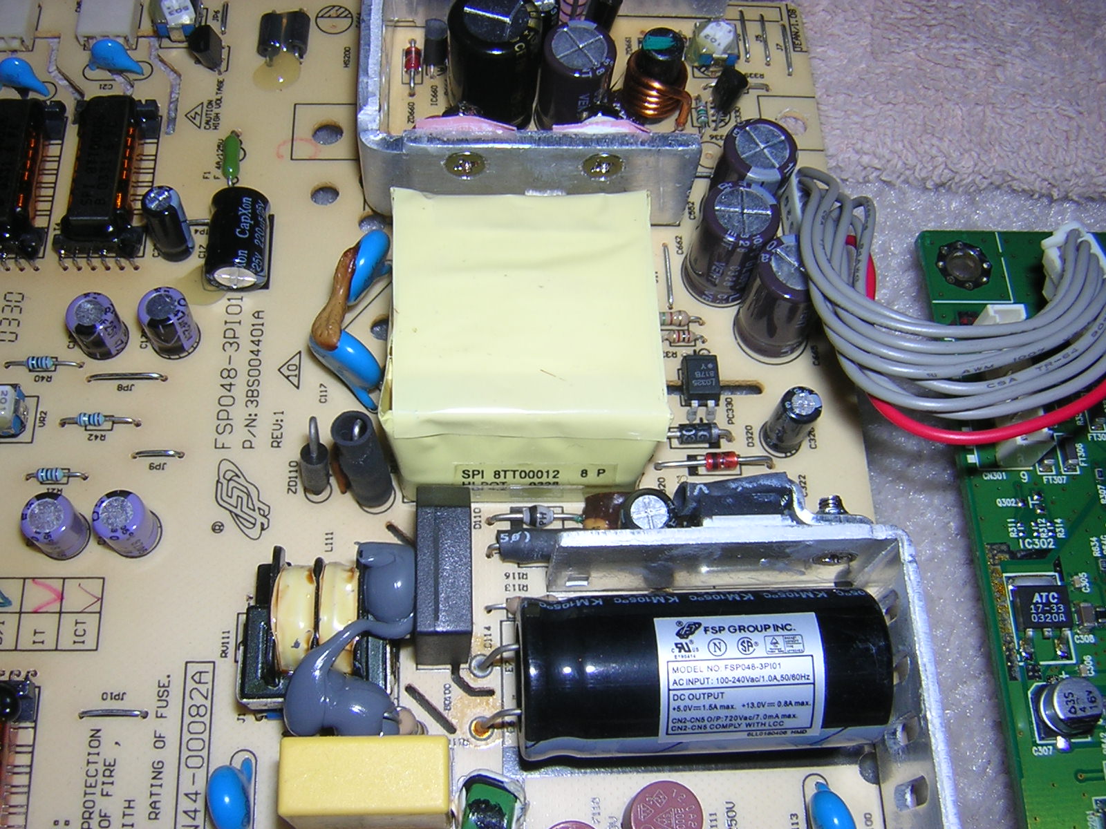

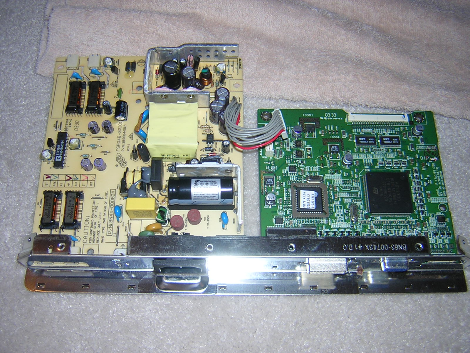

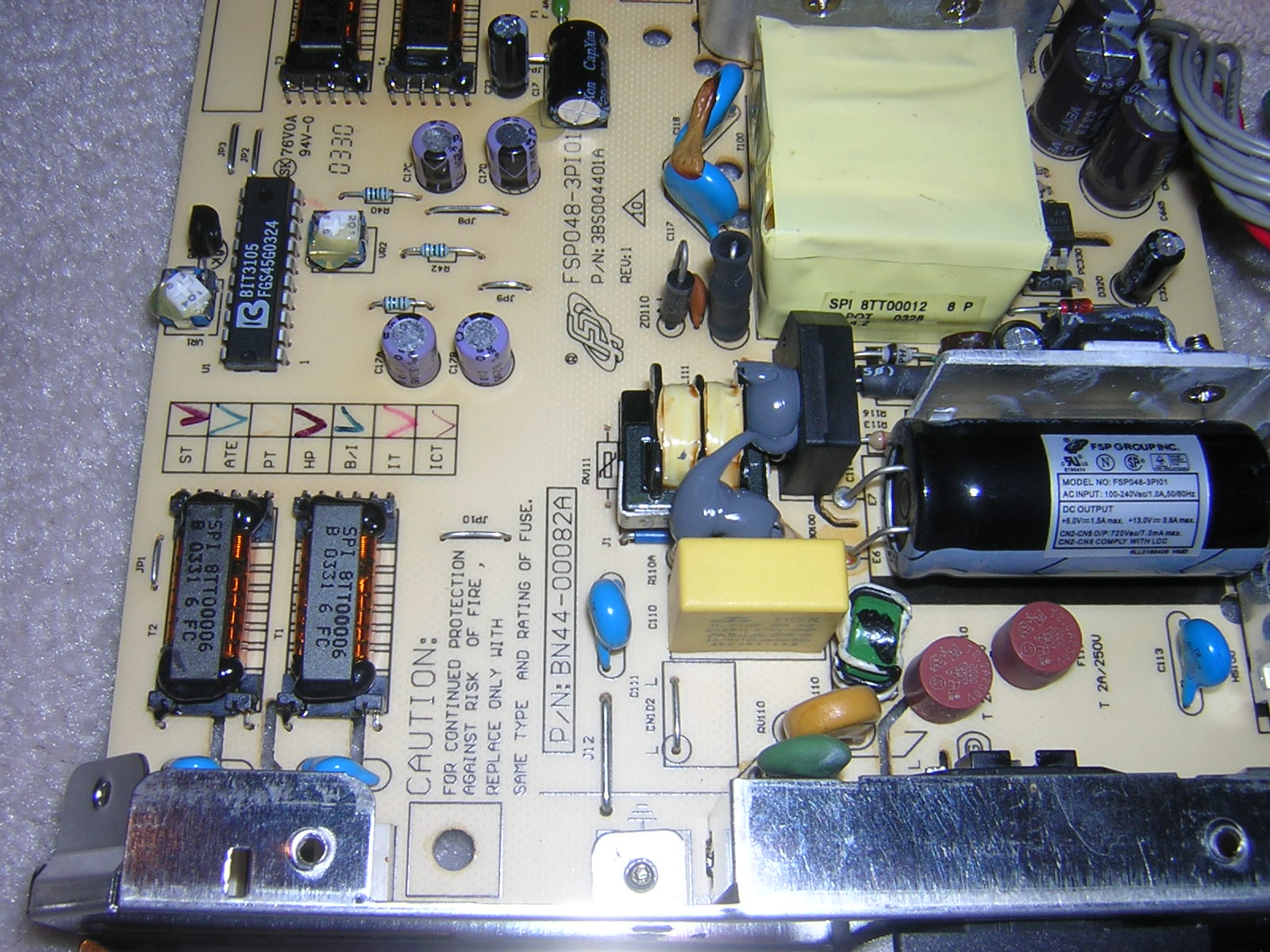

        Re: IBM 6734_HBO: 2sec to black

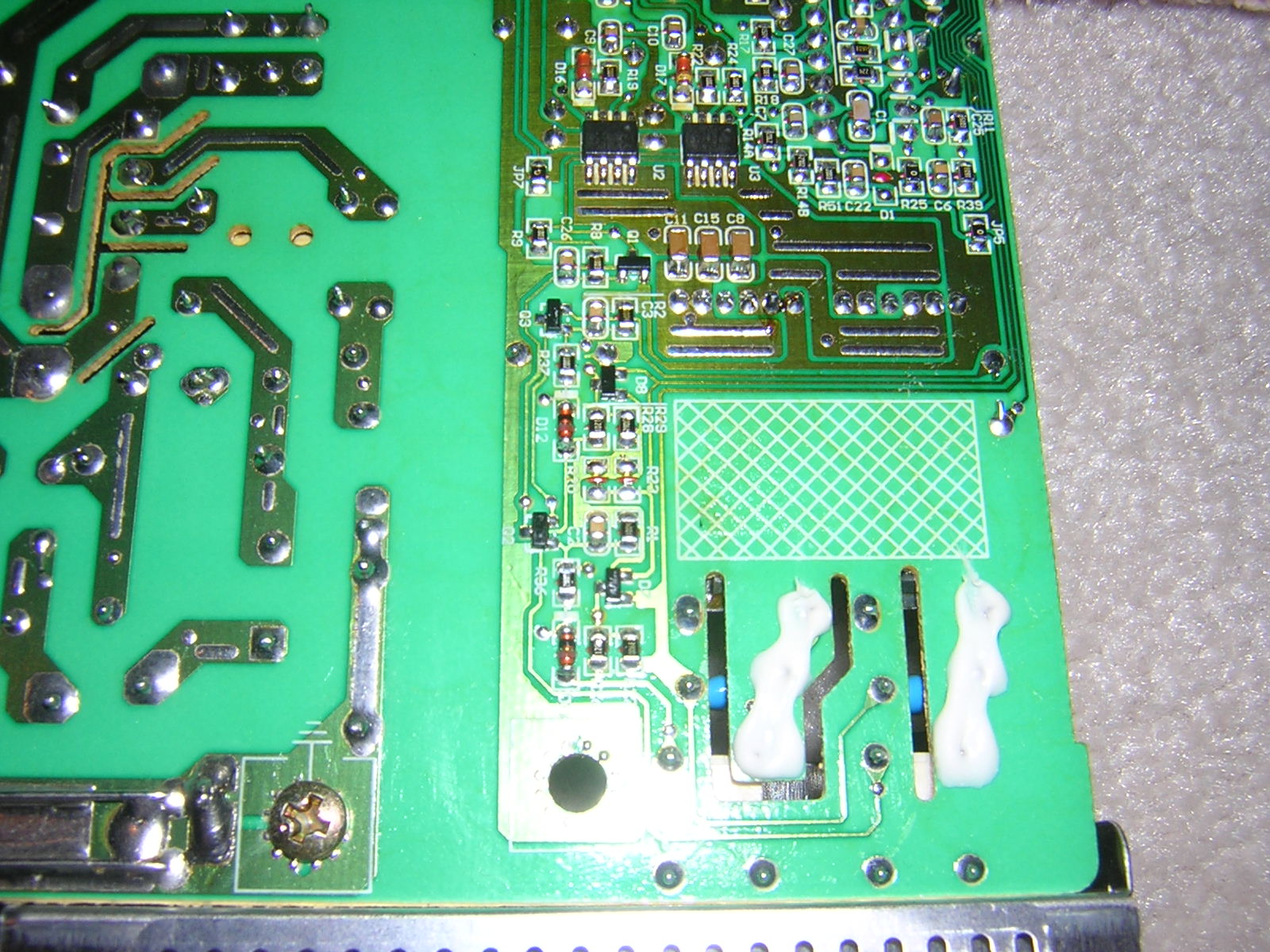

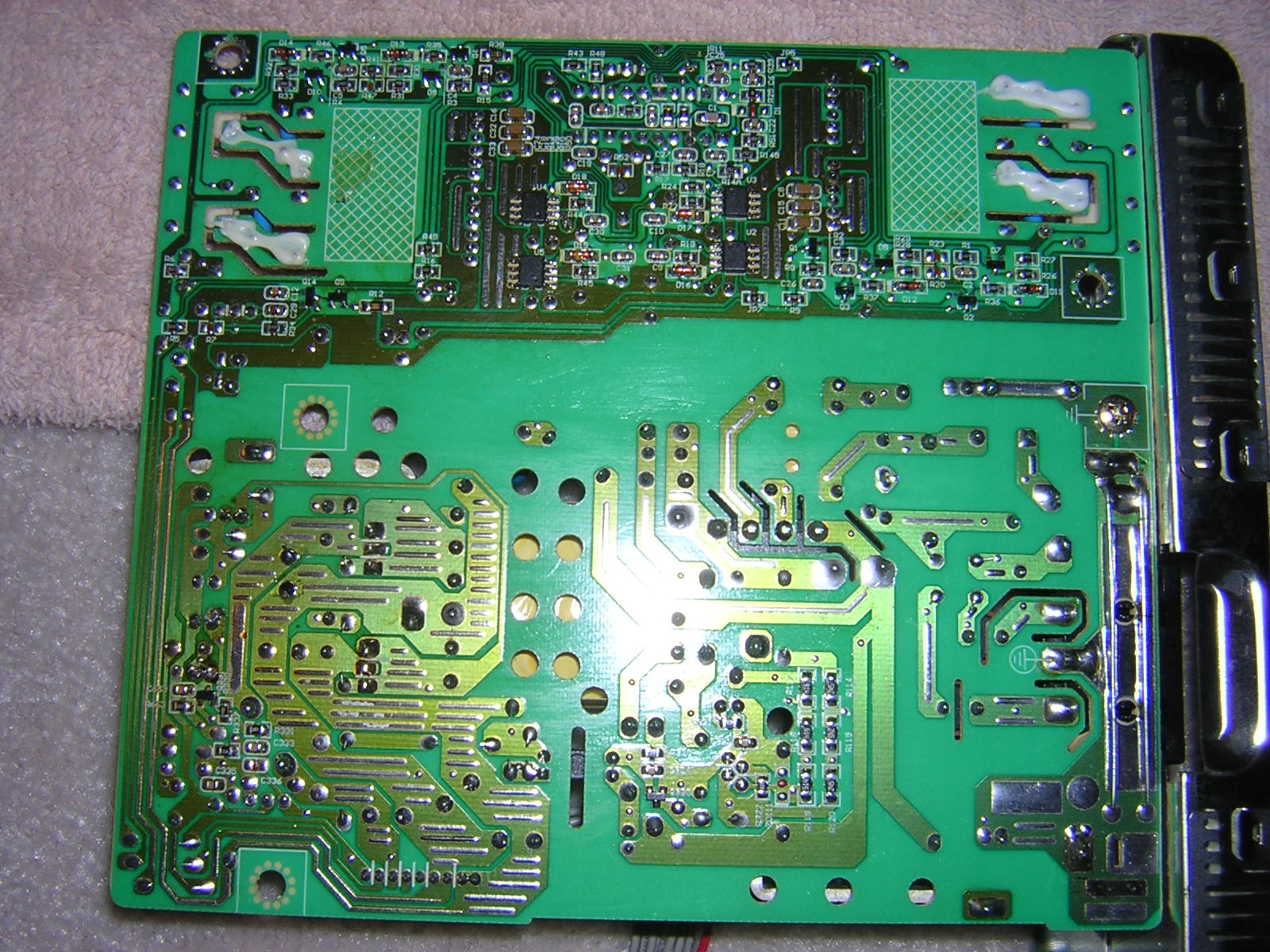

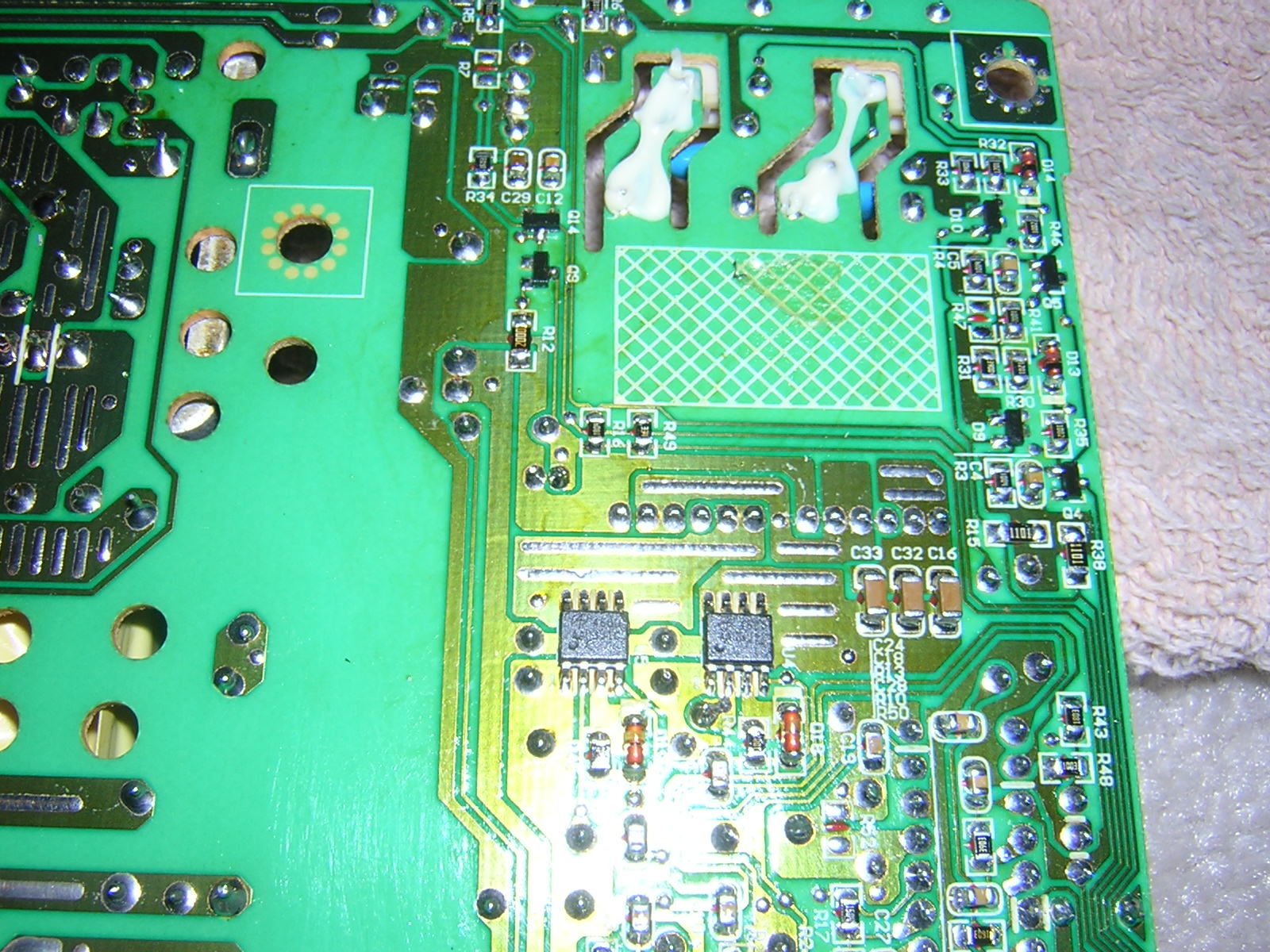

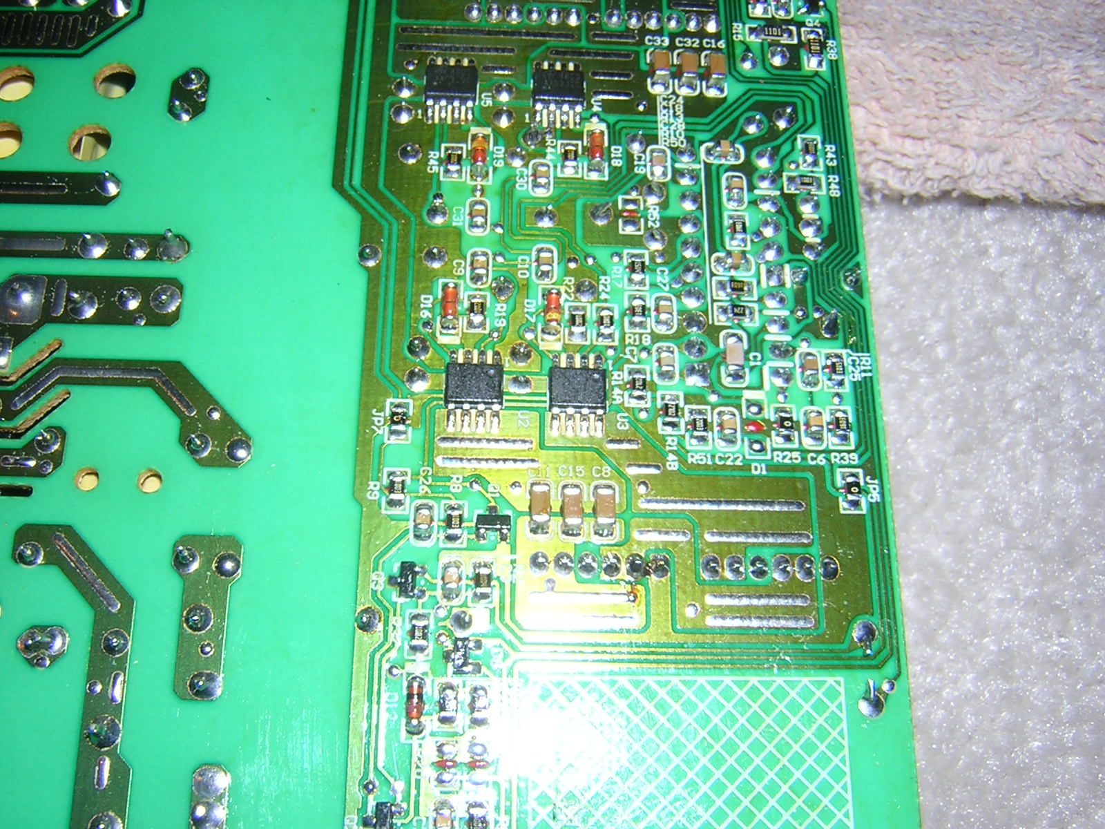

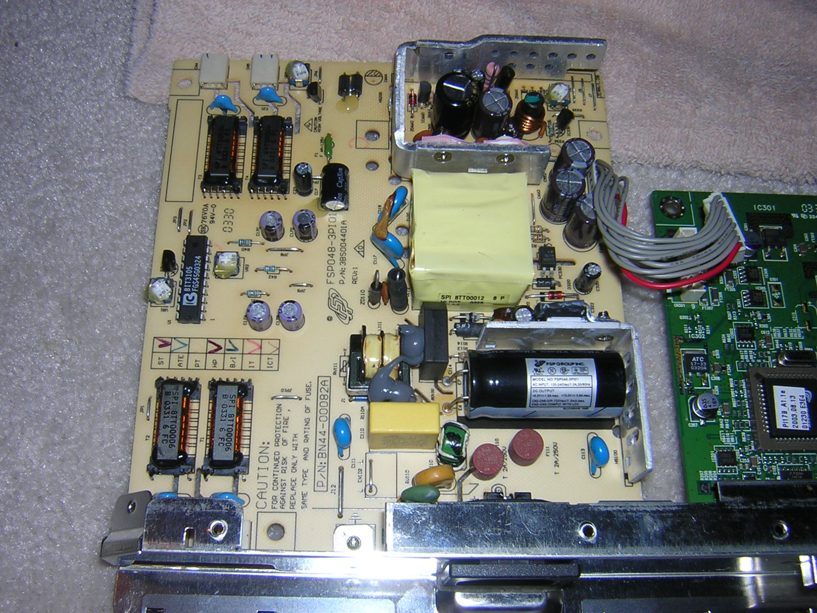

        I am enclosing an "overall" pic of the back of the power-supply/inverter board.
        I also measured the IC660:
        Note: MEasurements same with either black or red lead first/second.
        Pin1 to Pin2: Measured resistance was 9.9kOhm
        Pin1 to Pin3: Measured resistance was 0.4ohm
        Pin2 to Pin3: Measured resistance was 9.9kOhm

                    Odd, I can't see how pin 5 and 6 (if it is 3.3V as marked on the board) go anywhere on the back side?
                    What is IC660? That is, what is written on it?

                    • PlainBill
                      • Feb 2009
                      • 7034
                      Originally posted by Welchs101
                      I guess i dont understand. How is connecting a known good bulb doing anything if i have already verified the bulbs are "good". Sorry but i dont understand.
                      A common inverter design has one 'stability' feature, as well as two forms of protection. The stability feature feeds the total CCFL current back to the inverter controller so the lamps are running at their designed current.
                      The two safety features react to the maximum current through any one lamp and the maximum voltage across any lamp. By substituting a known good lamp in turn for each original lamp you can determine if the problem is caused by a lamp that is drawing too much current (current draw increases as the lamp ages).
                      If you remember the IBM monitor I helped you with a few weeks ago, try the same test I PM'd you'.
                      PlainBill
                          Yeah, it seems the 3.3v was omitted from the PSU design, so pins 5 and 6 may be ignored when doing measurements again. I'm guessing the video board probably has it's own 3.3v regulator.
                              ok. In the previous monitor you helped me with the monitor stayed on after doing this (not a permanent fix) but for THIS monitor lamps went out....ie....no change. Monitor comes on for a few seconds then goes off.
                              OK, that means it's not an sensing an open lamp, so that side can be ignored. Now try measuring the resistances of each transformer secondary. I've circled the pins.

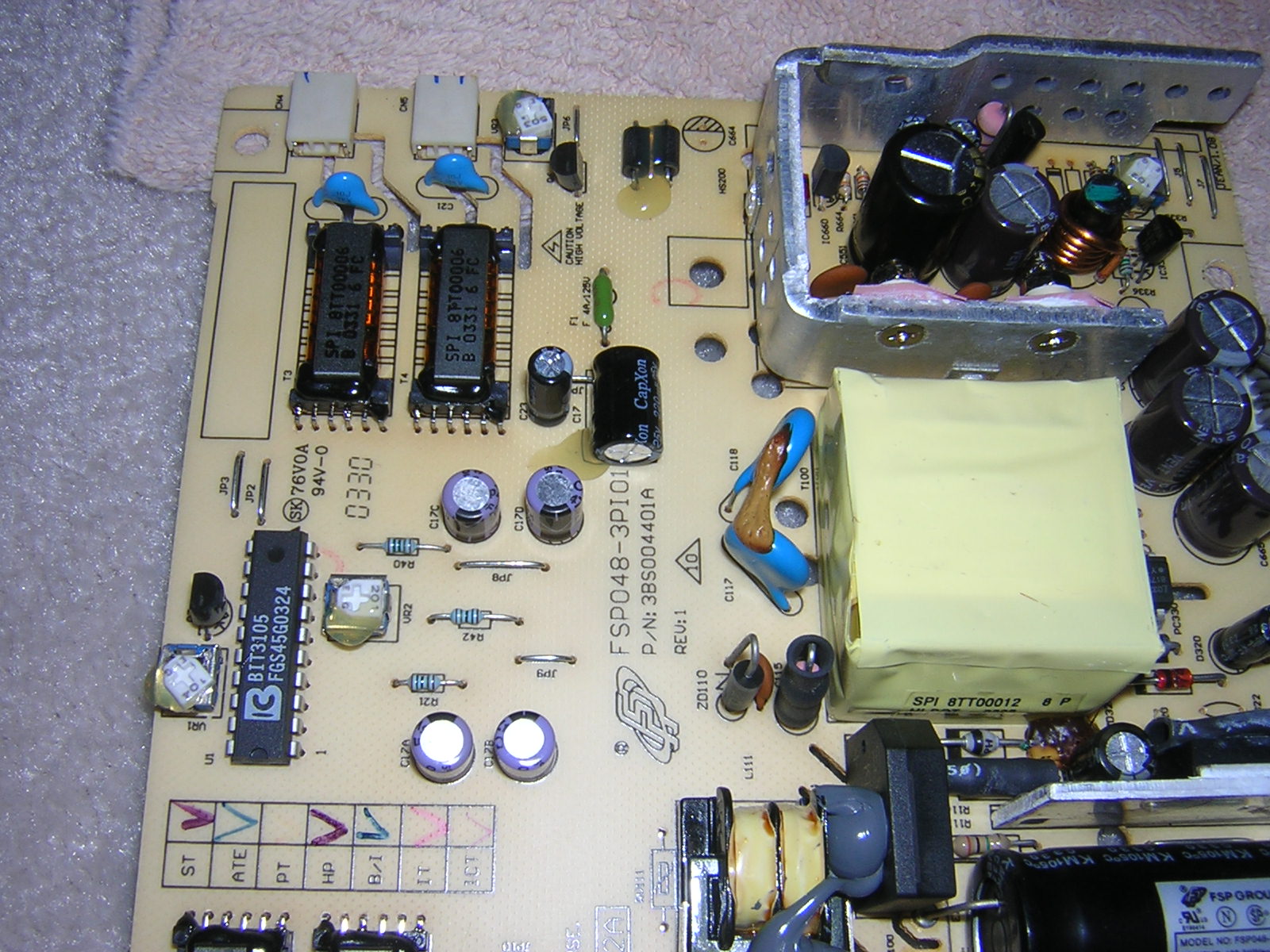

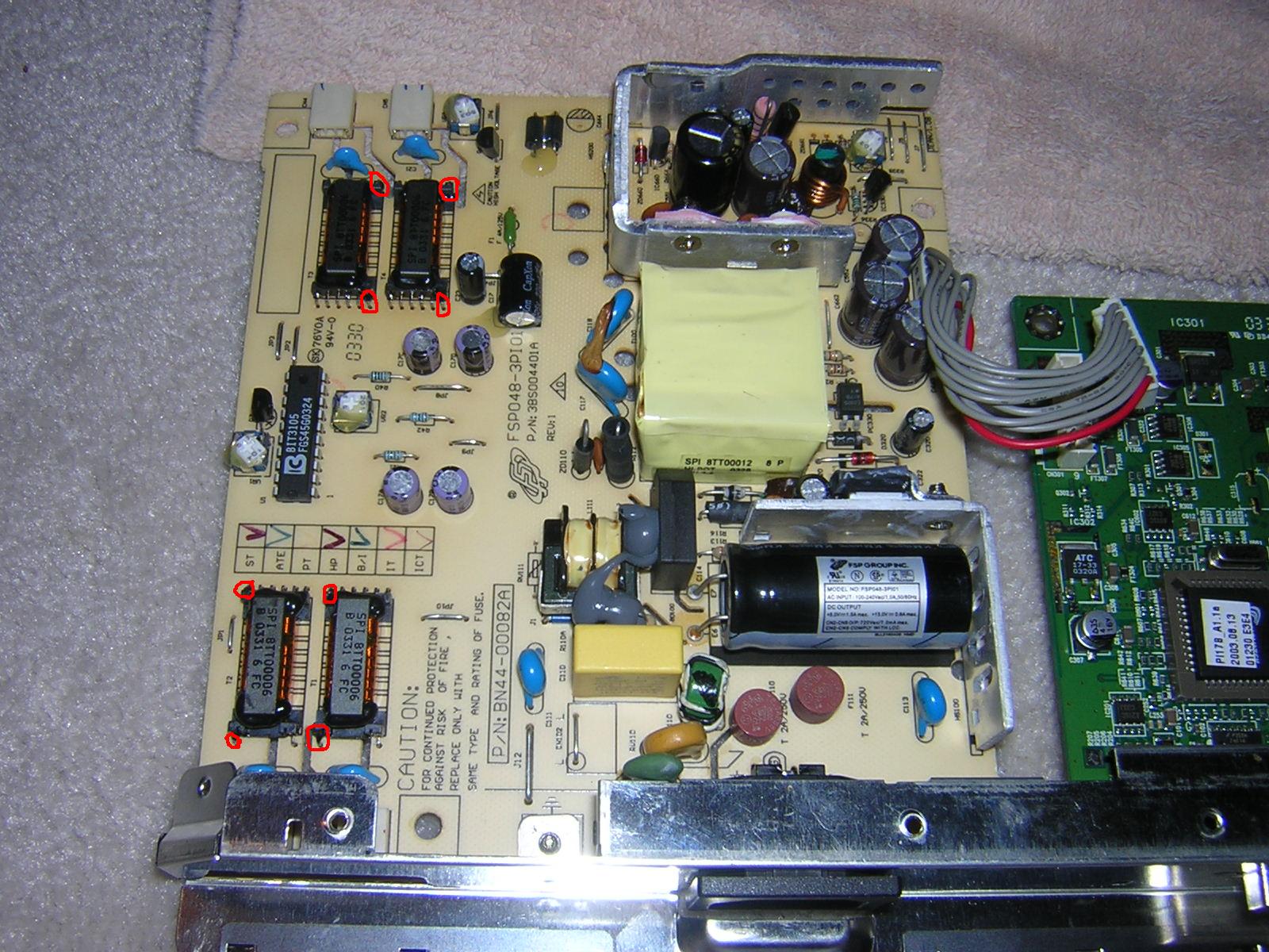

                                Measured transformer:
                                Note measurement on transformer #3:
                                Transformer1: 0.981Kohm
                                Transformer2: 0.975Kohm
                                Transformer3: 5.0Kohm
                                Transformer4: 0.997Kohm
                                Question:
                                These transformers........what am i measuring? I know conceptually what a transformer is supposed to do and how its supposed to look. But the transformers on these inverters always have more leads than simple "input side" and "output side". The points you mentioned in the picture.......what am i measuring?
                                  Question:
                                  You are confusing physical configuration with electrical configuration. Recall, on a schematic a capacitor is always shown with the two leads opposite one another - even a radial cap. This transformer design has one end of the secondary attached to the same end of the transformer as the primary windings. And you are measuring the resistance of the secondary - the high voltage winding.
                                  Fortunately, replacement transformers are available - just search for 8TT00006.
                                  PlainBill
                                  • Welchs101
                                    • Sep 2008
                                    • 979
                                    So based on the measurement values #3 transformer is bad...........right?
                                    I looked up this transformer......only found one site "lcdparts.com" that sells it. Do you know of another place?
                                    Also, any ideas where i can find a datasheet on this thing. Just wondering how you knew that i was measuring the "secondary" resistance.
