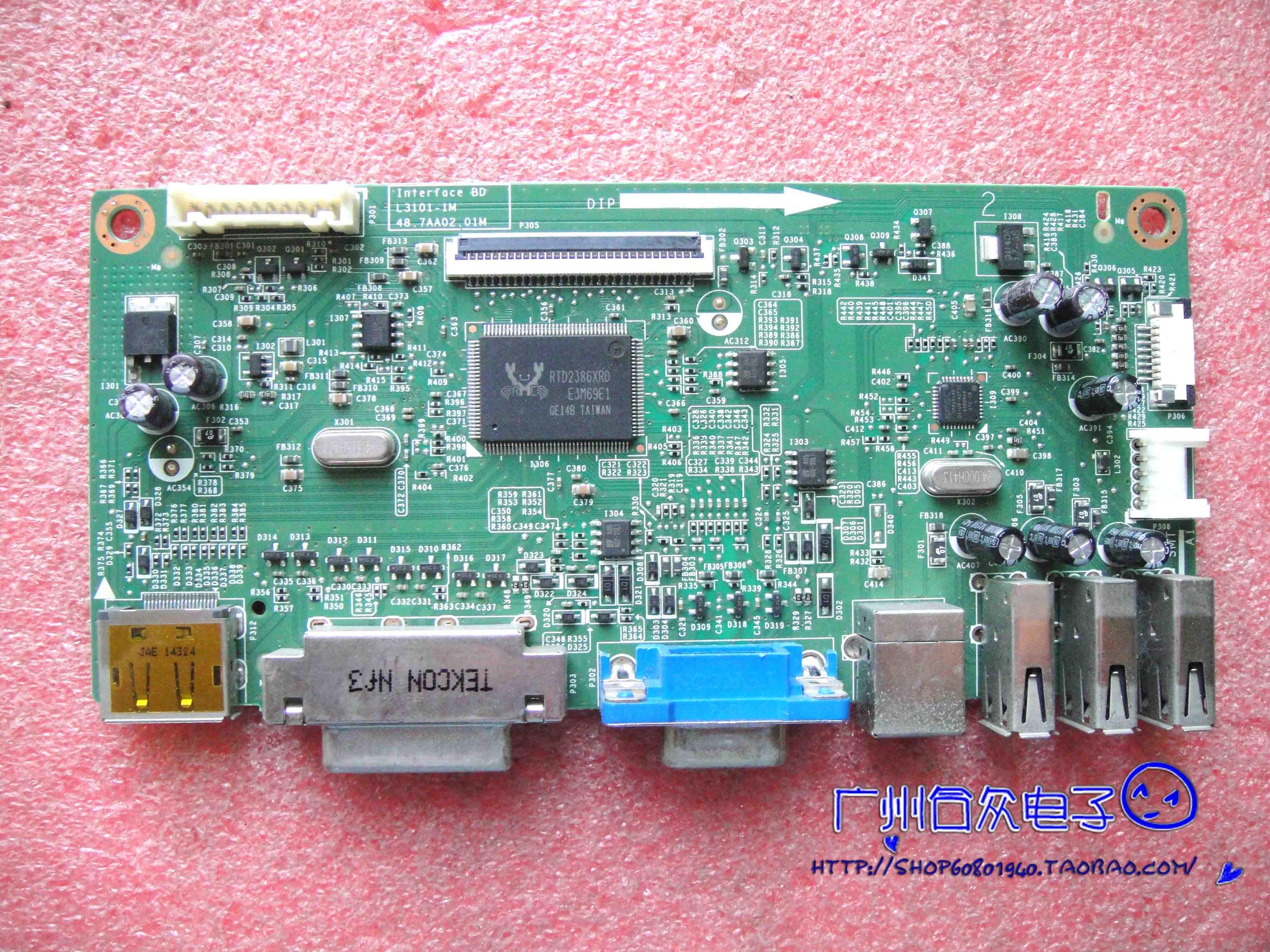

    Boardnumber:
    L3101-1M
    48.7AA02.01M

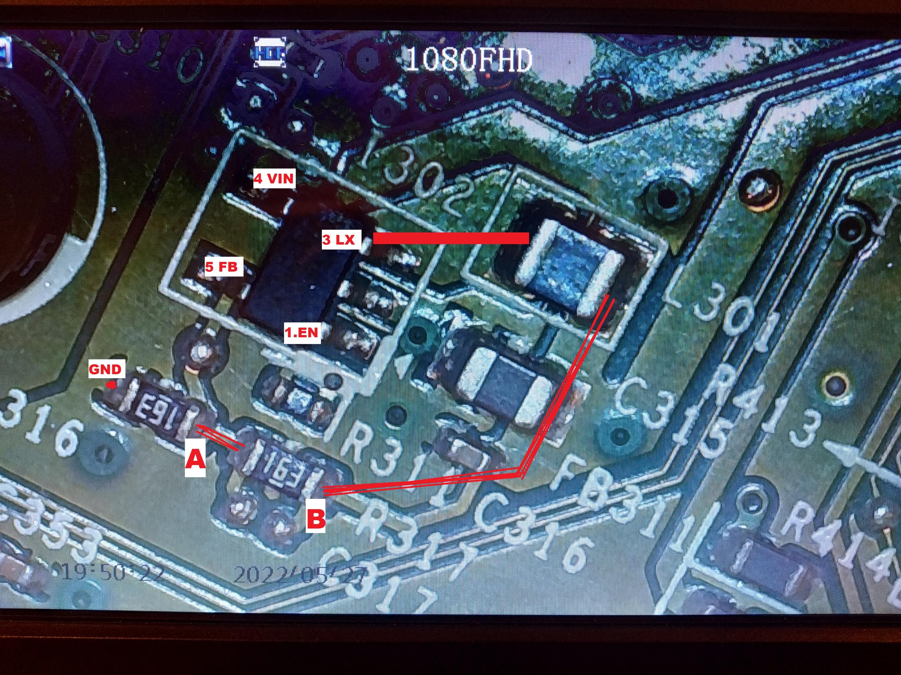

      Find a "1MHz 1A Synchronous Step-Down Regulator"
      According to Datasheet the equasion is good and the output should be 1.2v indeed,
      Because Vout=0.6V*(1+(163K/163K))=0,6v*(1+1)=1.2V So this seems fine.
      So my thinking is like this: If the powerbutton pressing drops voltages to 0 for a second then something else must be not switch on.

        1. Strange thing is that acoring to datasheet the VIN should be voltage higher than 4 Volts, and its is 1.2V also, so how is the regulator even working?
        Is it possible that it is not and the 1,2volt is coming from somewhere else and it only would go up if button is pressed and something gives more power to VIN?
        Also VIN and LX is not sorted.

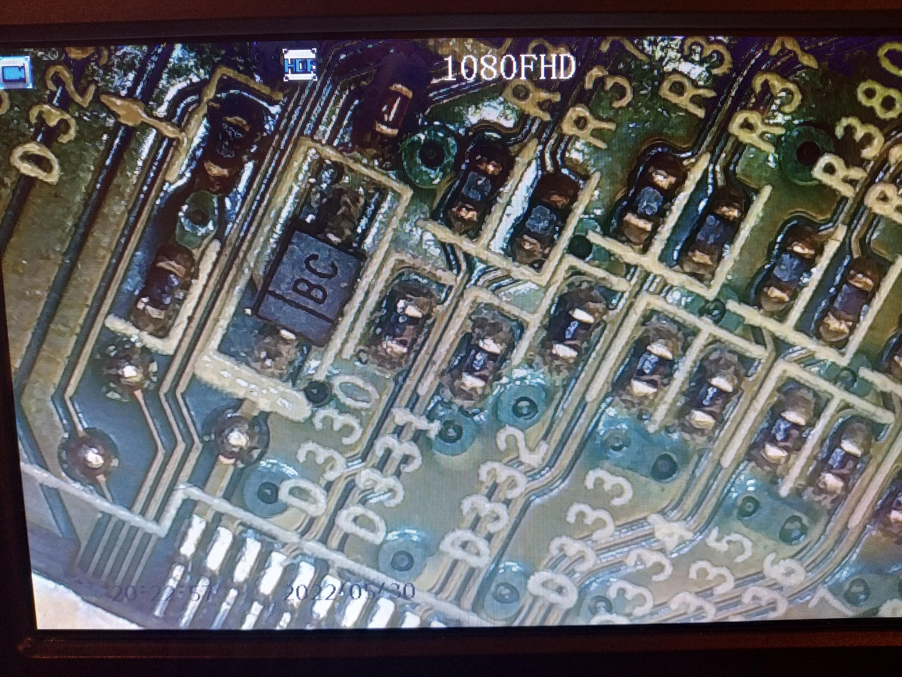

                  So i have checked every component on the logic board and found a bad diode that reads 0.5v and 0.3v in both ways on diode mode.
                  I assume its fault can be the cause of the low power since its directly connected on the input rail of the board.
                  According to the internet it is a "UDZ5V6B" SOD-323 diode.
                  Attached an image (its the one with the mark of BC), please correct me if I'm wrong.

                      That diode is a 5.6 volt 200mw zener diode, they can be found everywhere, Check the voltage across it. If it is across the 5 volt input, it is good, and this is not your problem.

                            Sorry I misunderstood, I thought the 5 volts was present and only dropped when the power button was pressed. Replacing the diode should resolve the problem.
                            If the diode is across the 5 volt input to the main board the diode is likely only for protection If the main board is removed and the 5 volts is not high, you can remove it to test the operation of the monitor, after testing install a new 5.6v zener diode.
