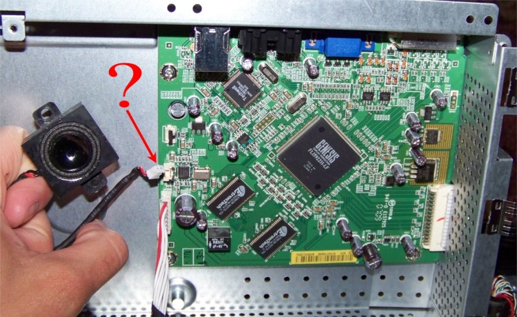

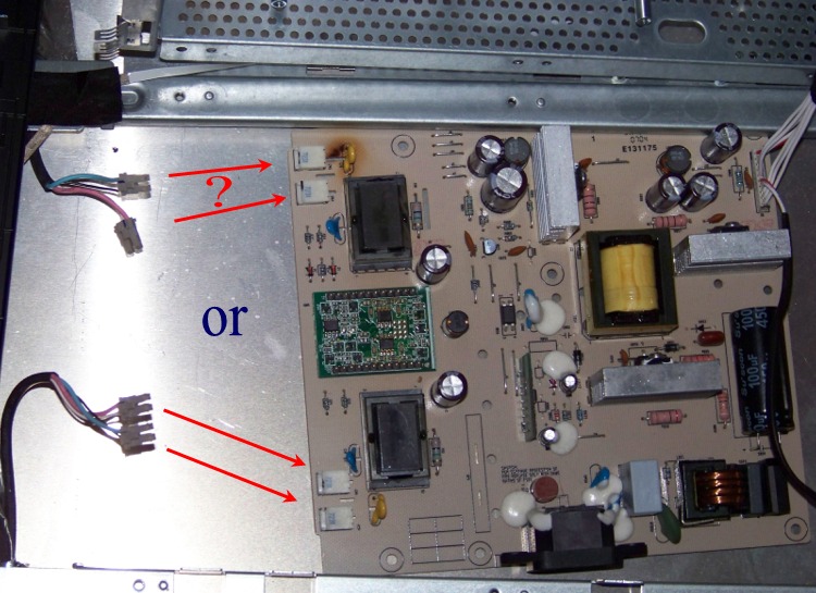

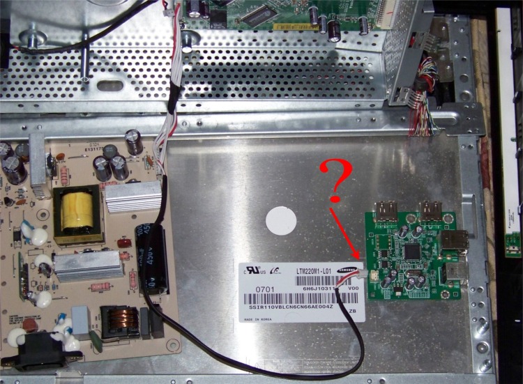

    I had a blown cap and one on the way,with I replaced both(same kind) I finally recieved some caps I have been waiting for to replace all the rest on the Power/invertor board but wanted to make sure I can put it back together. I have most of it figured out. Stuff kinda got seperated so I couldn't remember. My main question in on the 4 connectors for the ccfls to the invertor. What would be the proper order? also there are 2 connectors- one for a speaker(not sure why it has one since there is no sound available for the monitor and a second cable on the invertor board. One cable goes to the USB hub and the other goes to the proccesor/componetn board. Im assuming the speaker goes to the component board and the other cable from the inverter board goes to the USB hub board. I will attach pics any help would be great. I really need to get this thing going it been sitting here for to long mostlly waiting on the cap set and would like to get this in. Thought I would test the 2 caps I replaced first. Since the rest tested mostlly ok(nothing that shouldn't make it not turn on)

    the order of the ccfls doesn't matter
      The reason there is a speaker is for the touch controls. By default, there is a chime associated when a touch is sensed, presumably so you "know" when one has registered. From the pictures it looks like you have it all correct. Good luck with it!

          Thanks for the info on the CFL connectors Anno.
          I was hoping that might be the case

            Thanks for the background on the Speaker. That makes a lot more sense now, and thanks for the reassurance on the correct connections. I didn't want to take a chance, not for how long it has taken to get caps
