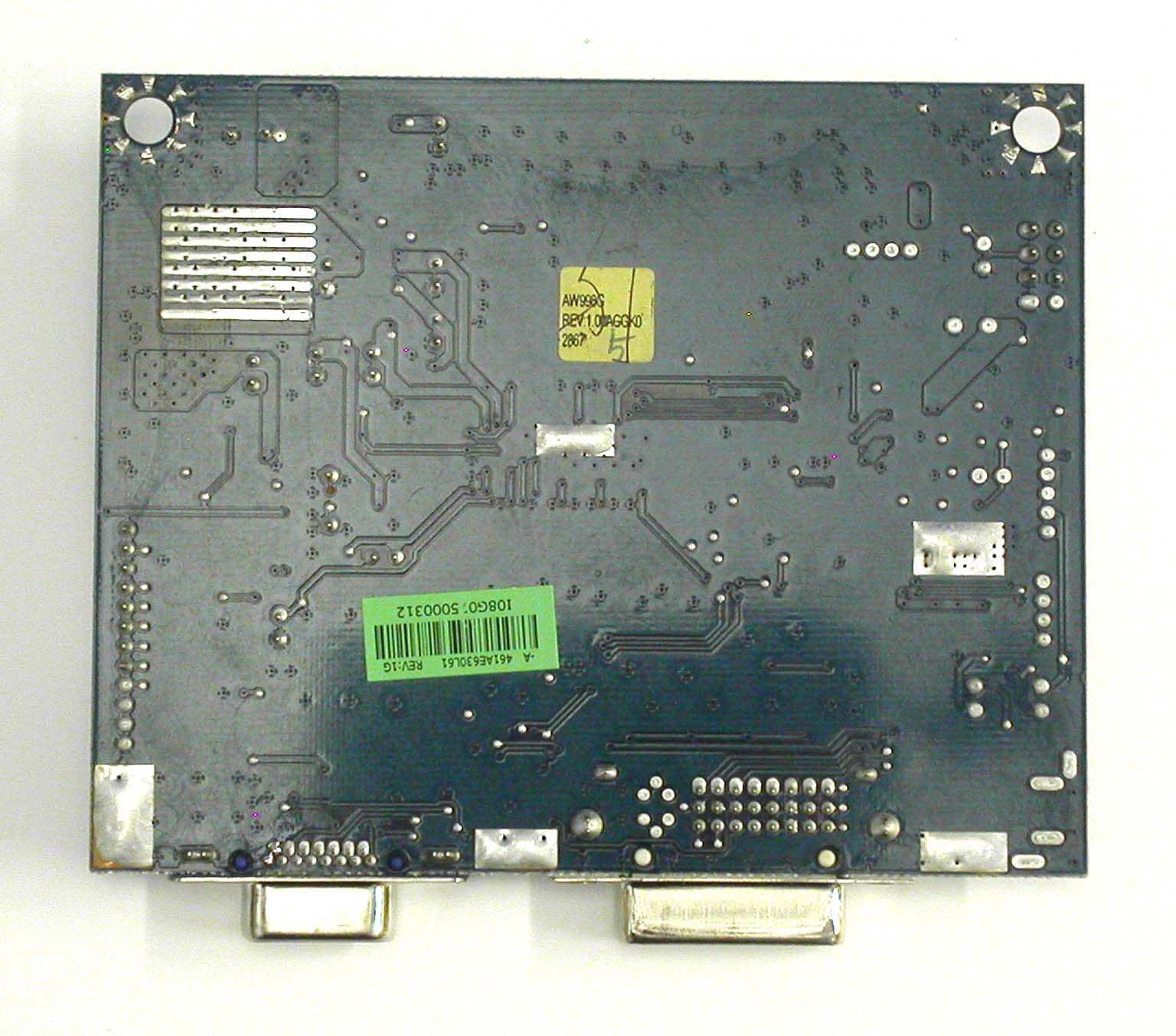

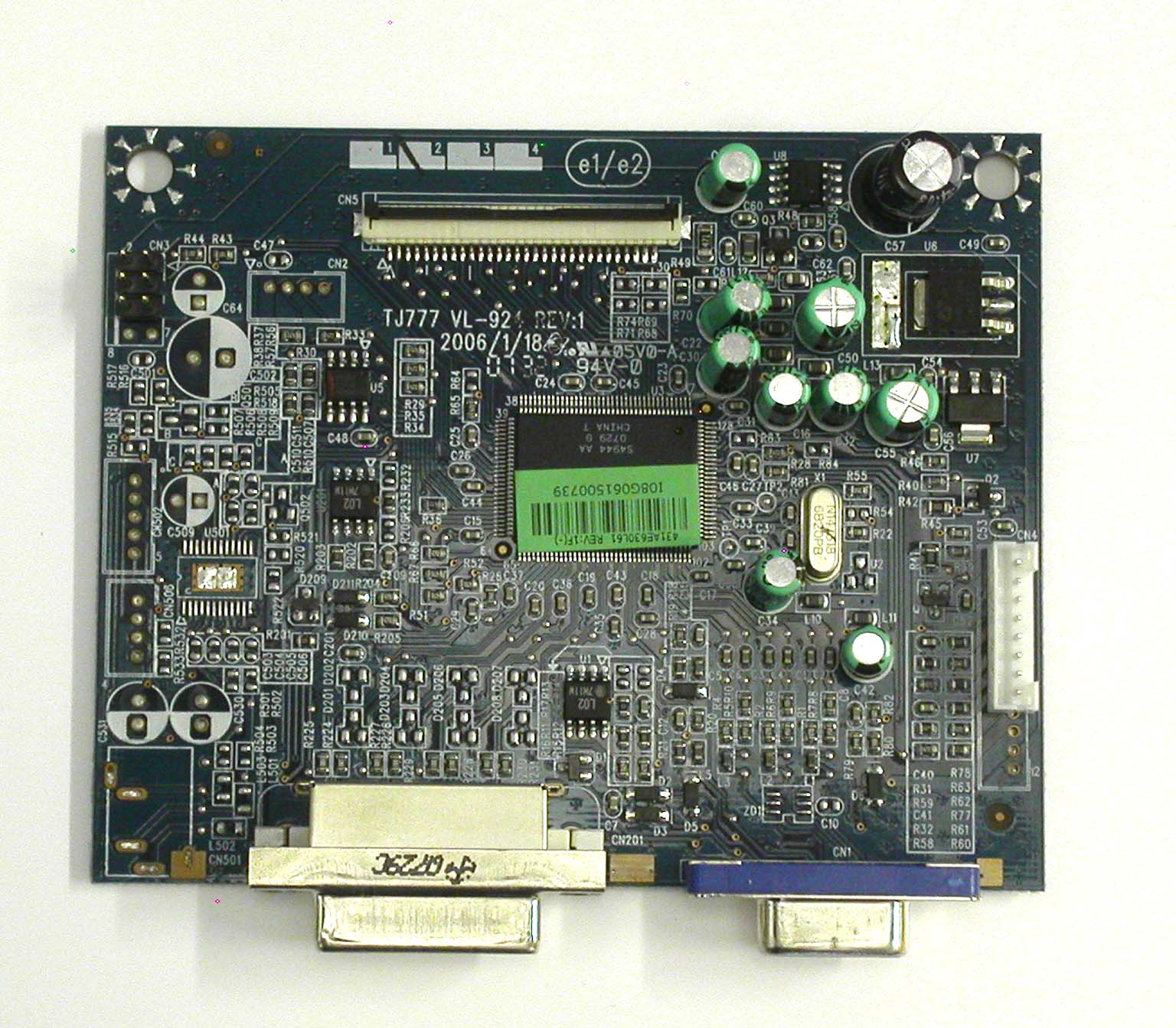

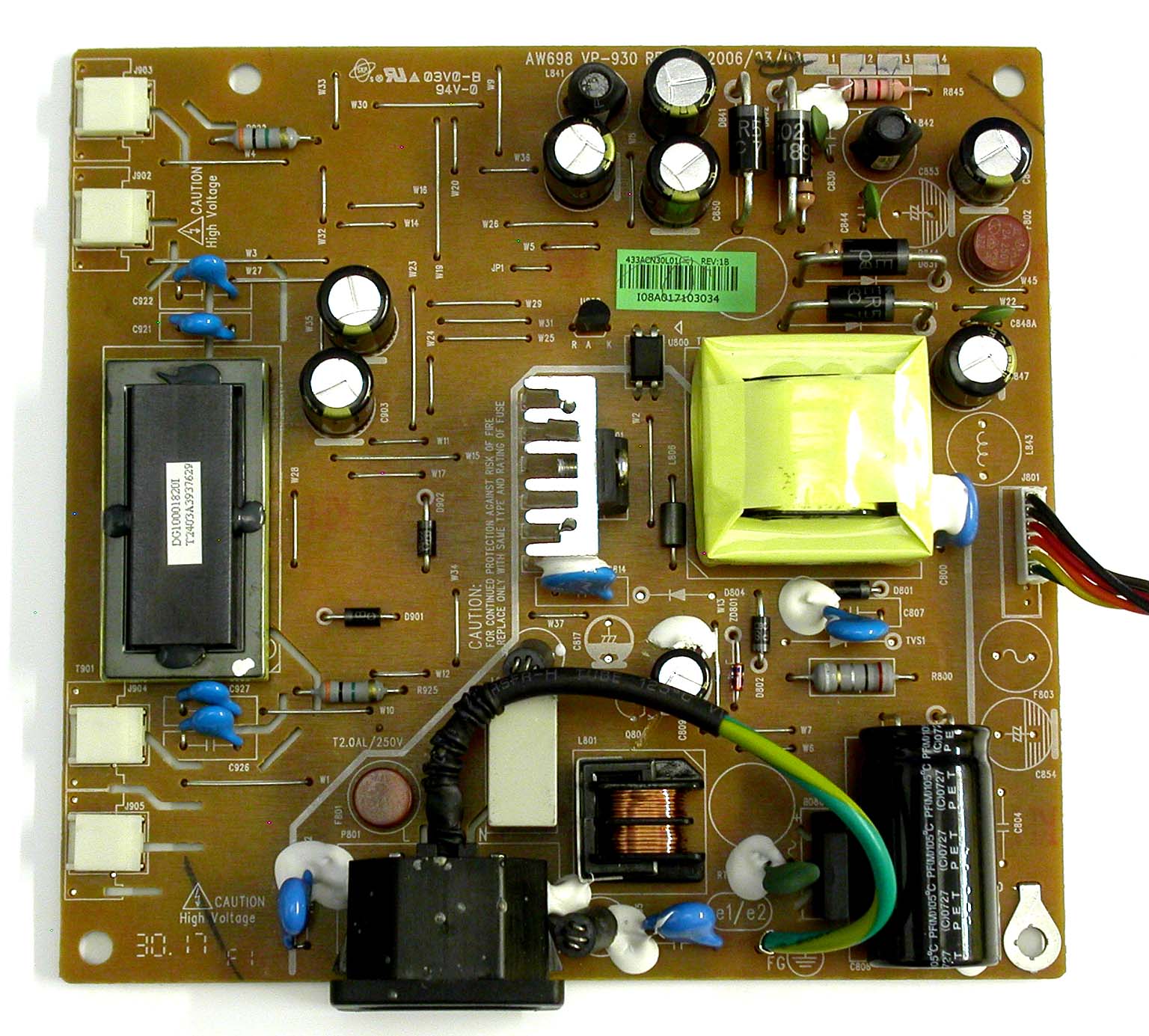

    This power supply is different than other Acer AL1916's - at least ones I've read about. No power light at any time. I've replaced 8 caps with panasonic fm's. Have 164 volts on big cap. Measured output to logic board - top two wires are 5v, others are 0. Measuring across the other caps.
    C809 = 14.57v
    C843,C845,C850 = 21.6v
    C847,C848 = 5.06v
    C902,C903 = 10.84
    Is the logic board bad? What can I check next?

    F802 on the upper right hand corner of the board.
    U6 and U7 are most likely regulators(on processor board) - check input and output voltages. You can find pinout on datasheet of each. Just post what the markings are on each of the 2 components.

      Check and report the voltage on all pins of U6 and U7 on the logic board. Use the mounting pad in the upper right corner, or the - pad (the one surrounded in white) of unused cap C64 as the ground point. Also, what are the part numbers of U6 and U7?

          U6 is APL1084, reading top to bottom I have 5.02v, 3.28v, 0v
          U7 is APL1117, reading left to right I have 3.28v, 1.09v, 0v

              The usual voltages for the control chip are 3.3 and 1.25 volts. 3..28 is well within tolerances; but 1.09 is low. We have been seeing some bad APL1117's lately. When they fail high the processor is destroyed. Fortunately this one seems to be failing low. Just for my peace of mind, are there any more characters in the part number of that one?

                  Characters below the part number = GJ70618

                      I took a look at it, and the best information I have is that that IS a 1.8 volt regulator. It's available by STMicroelectronics from Digikey as 497-6868-1-ND LD1117S18CTR for $.79

                          Placed order Monday P.M. - ordered arrived today - Digikey is awesome. I've not done much SMD work but managed to get voltage regulator removed, new one installed. I tested voltage again and noticed the middle leg only read 1.8 when I pushed down with probe, .5v when I didn't. With this voltage - screen lit up - all white, still no power led. Removed logic board and soldered middle leg while holding down - voltage now reads 1.8v and I have an 'ACER' splash - hooked up VGA - nice picture! Thank you!
