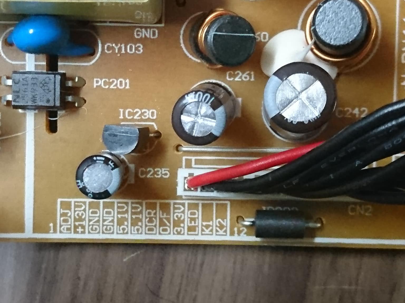

    I have a problem with a samsung 943B, initially thinking it was a power problem i replaced the power board which is a bn44-00082e, i had a flashing of the ccfl lamps and the monitor would not start, i replaced the power board and the problem is remained, thinking they were the lamps I tested them with a ccfl lamp tester and they are all working, at this point I think it is the main board which is a BN41-01172B, my question is, before making a further purchase there is a way to turn on the lamps without the main board to exclude that the new power board is also broken? Of course without the main board the lamps show no signs of life, so maybe I should short out two of the 12 output pins to turn on the lamps, like the guy on youtube did Grazie

    Yes, you can test the inverter with the main board disconnected.
    My guess would be that pin 8 (O/F) on the power supply board is for the inverter On/Off control pin. Pulling this pin up to 5V (so connect pins 5 or 6 to pin 8) should turn on the inverter (and backlights.) Probably best to use a 100-Ohm series resistor between these two rather than a direct connection, though... just in case.
    Pin 1 (ADJ) should just be for adjusting the backlight brightness, but usually that can be left unconnected for testing.
    I'm not sure what pin 7 (DCR) is for, but you can probably leave that one alone as well.
    So connect pins 8 to 5/6, and see if your backlights turn ON and stay ON. They should stay ON as long as pin 8 is connected to pin 5/6.

      No, this doesn't work, I realized that with the main board connected the last two pins k1 and k2 receive respectively 14, xx volts and 5.1 volts I don't know if it can be useful
        Re: Samsung Syncmaster 943B problem
        K1 & K2 are from the button board, Key1 Key2 should only have about 3.5 volts not 14v. k1&k2 connect to CN5 where the buttons connect

            ok I rectify, on k1 and k2 I have 1.80 volts, on pin 8 I have only 3.10 volts, if they must be 5.1 I think they are insufficient

              The control voltages from the main board are 0~3.3v

                what do you advise me to do to make this inverter turn on?
                  Disconnect the main board from the power supply so you don't damage the main board, Then use about a 1kΩ resistor between the +5.1 volts and O/F that should turn on the backlights, if it does not, then connect another 1kΩ resistor between +5.1V and ADJ
                  I think the DCR pin is used on this power supply

                    all clear, except that I did not understand what to do with the dcr pin
                      for the DCR pin, Look at the back of the board where the plug is located, I do not think that the DCR pin is connected to any circuit.

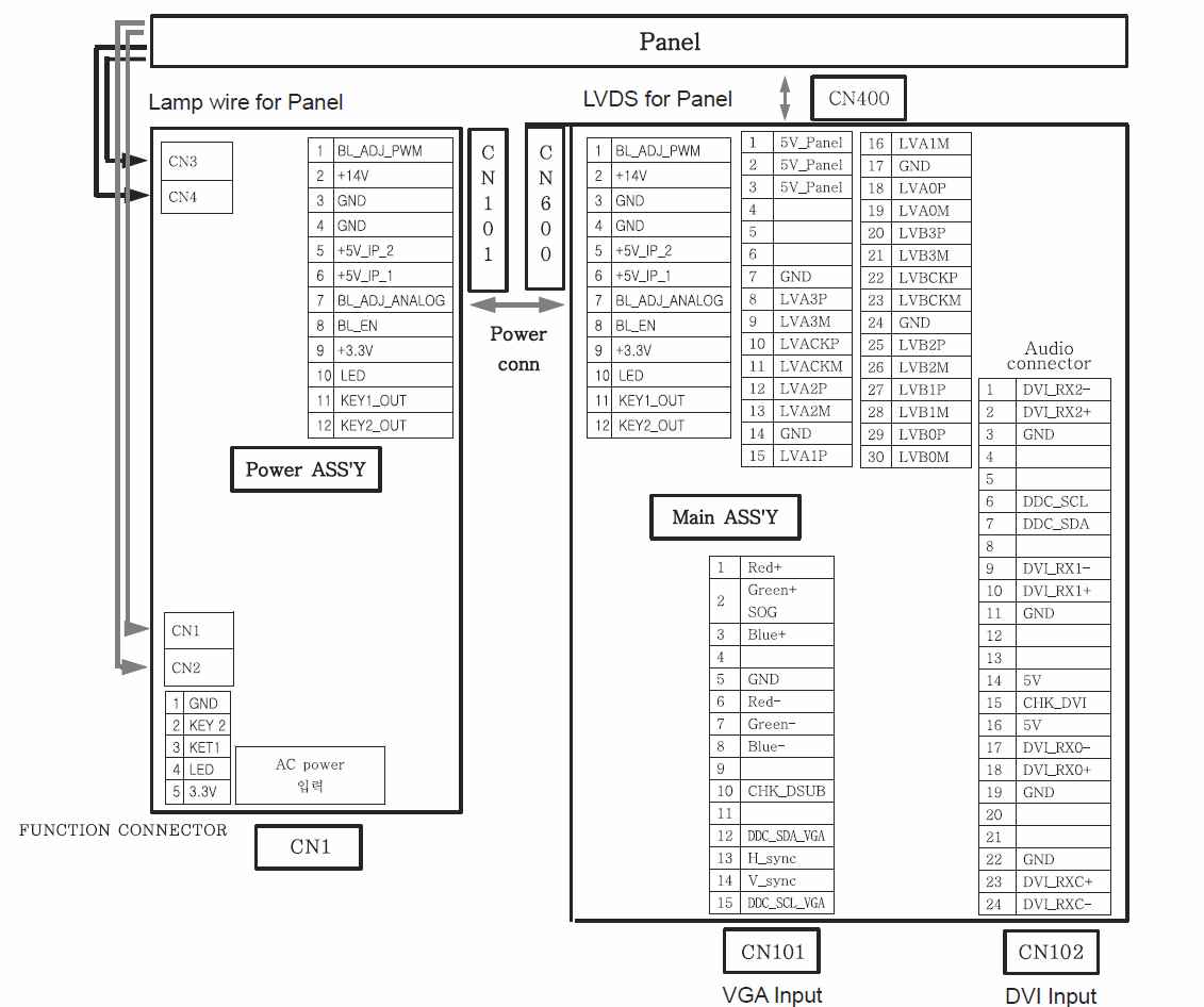

                        Wiring Diagram - Main Board

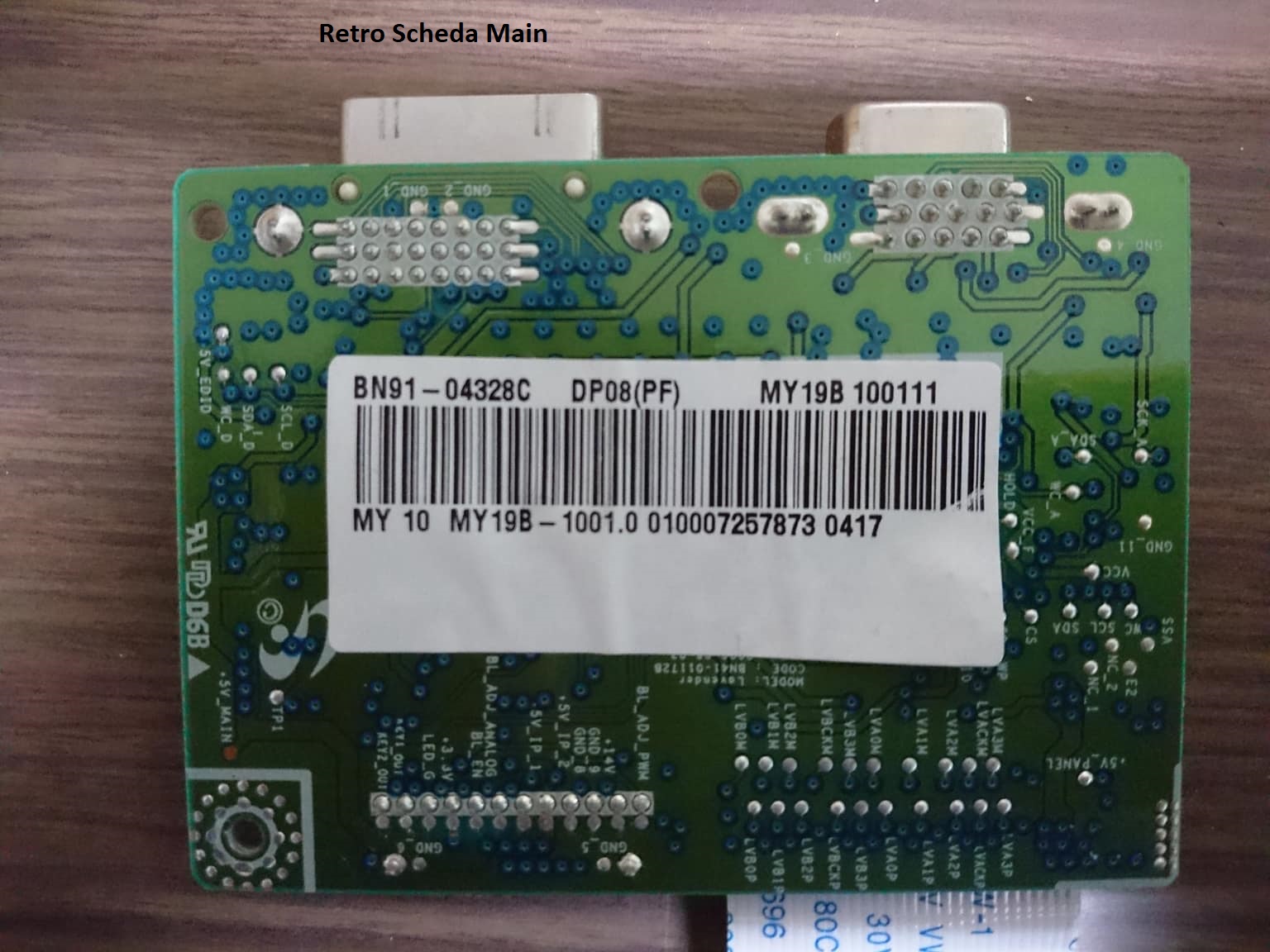

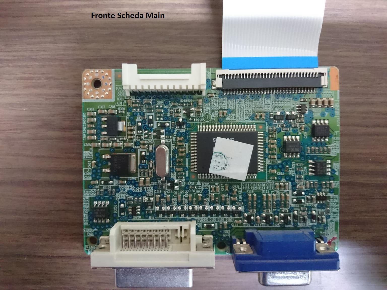

                          Yessss ... they turned on, so the power supply is ok ... now I should figure out what's wrong with the motherboard, assuming it's repairable ...
                            any idea to understand what could be in the main?

                                  I did some tests on the main, all the voltages are ok, except for pin 8 which theoretically should receive 3.3 volts but only 3.10 arrive, based on the lotas scheme what could I control?
                                    pin8 is o/f which is a control line to turn the power supply on and off 3.1 volts is fine. 0.2 volts is not going to make a difference.

                                        As you can see there is not much to the main board, if the regulators are ok, it may be a firmware issue? but I think the boards are quite cheap to replace.
