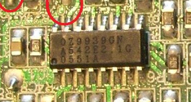

                          What is the part number of IC1 - the 16 pin IC in the inverter area? Perhaps it will be possible to determine what is triggering the shutdown.

                              Thank you very much for your comprehensive explanation to my questions PlainBill. It's always great to learn new terms and things.
                              PlainBill
                              That would be great, to me this is beginning to look like rocket science.
                              IC is (attached):
                              OZ9939GN
                              A542E2.1G
                              0551A

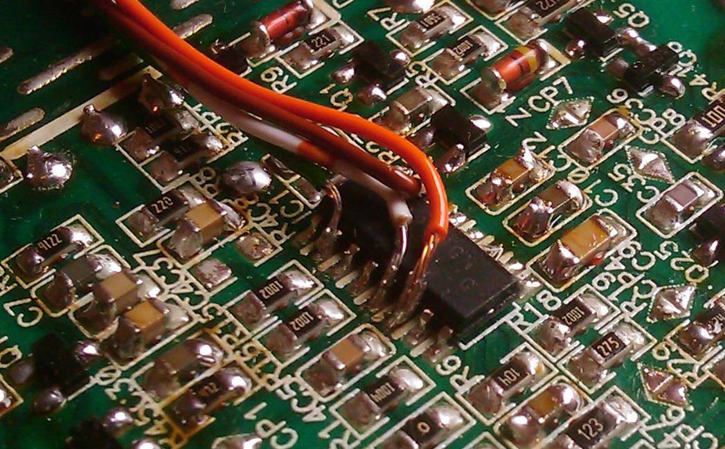

                                  Cowabunga!!! We have a winner!!!
                                  We're going to try working on this a little bit differently. Hopefully you can access IC1 while the monitor is in operation. The datasheet for the OZ9939GN is located here. This design appears to have both voltage and current protection, so let's monitor pins 5 and 6 to see which one changes and causes the shutdown. Use pin 14 as the ground point.
                                  If you can't reach those points while the monitor is working, solder fine wires (wire wrap wires would be excellent) to the pins and run them to an accessible point. (Avoid high voltage points like the inverter output and the AC input).

                                    PlainBill
                                    Thanks PlainBill. I did as you suggested and measured also voltage from pin 2, which seems to stay at 4.98V when monitor is on.
                                    Here are the results on pins 5 & 6. Seems that I get overvoltage at some point if I understood this correctly? What could cause this sort of peak?
                                    Powers on 20% brightness (Or=Orange/Ow=orange/White):
                                    Ow 5 ISEN: 0.52 V
                                    Or 6 VSEN: 0.52 V
                                    Set brightness to 90% (at 15 mins on)
                                    Ow 5 iSEN: 1.23 V
                                    Or 6 VSEN: 0.84 V
                                    (30 mins on)
                                    Ow 5 iSEN: 1.23 V
                                    Or 6 VSEN: 0.84 V
                                    (Lights go off at 40 mins)
                                    Ow 5 ISEN: 0 V
                                    Or 6 VSEN: 0 V
                                    Turned off and on again, lights turned on immediately:
                                    Ow 5 iSEN: 1.23 V
                                    Or 6 VSEN: 0.84 V
                                    (Lights go off 13 mins)
                                    Ow 5 ISEN: 0 V
                                    Or 6 VSEN: 0 V
                                    Turning on gets these peak values and lights go off immediately
                                    Ow 5 ISEN: 0.83 Vpeaks
                                    Or 6 VSEN: 2.11 V peaks
                                    Suddenly turns back on:
                                    Ow 5 ISEN: 1.23 V
                                    Or 6 VSEN: 0.84 V
                                    (still 15 mins on)
                                    Ow 5 ISEN: 1.22 V
                                    Or 6 VSEN: 0.85 V
                                    Lights go off... turning on gets these peak values and lights go off
                                    Ow 5 ISEN: 0.47 V
                                    Or 6 VSEN: 1.85 V
                                    Couple of minutes off, and here we go again (15 mins on)
                                    Ow 5 ISEN: 1.23 V
                                    Or 6 VSEN: 0.83 V

                                      Excellent job of testing, thanks for the data.
                                      Forgive me, I haven't read the complete thread. Please verify this - the CCFLs suddenly turned off, then back on without any action on your part?
                                      That is very interesting, and would really limit the number of possible causes. The OZ9939 uses a standard technique for regulating the outputs. The current through the CCFLs' return lines are measured, and the total current fed back to pin 5. It adjusts the output drive to maintain a constant CCFL current, based on the brightness setting. If a return line is suddenly shorted to ground, it appears this would not cause a fault condition.
                                      The output voltage is also monitored. These are 'ored' and pin 6 senses the highest voltage across any CCFL. If this rises above the threshold, the inverter shuts down and stays down until the control input is cycled to off, then on.
                                      It appears the ONLY way the CCFLS could go dark, then come back on again is if the voltage at pin 10 drops below 1 volt, then rises above 2 volts.

                                        I was reading electrical characteristics of this IC chip, I noted that ISEN is on it's Max level (1.23 V) all the time (except when shit happens) while VSEN is not even close to it's minimums (2.78)? see page 4. I might be wrong though, these are the things I don't really understand.
                                        I quess my next step is to measure pin 10. Should I check preset voltage at pin 7 too?
                                          The voltage at ISEN is normal. The inverter is a constant current source, so the current will stay at the regulation point. If you reduce brightness on the monitor, the voltage at ISEN should drop.
                                          Go ahead an check the voltage at pin 10. I suspect it will be either well above 2 volts (on) or below 1 volt (when turned off from the front panel). I am also interested in the voltage at pin 7. I had expected to see Vsen much higher.
