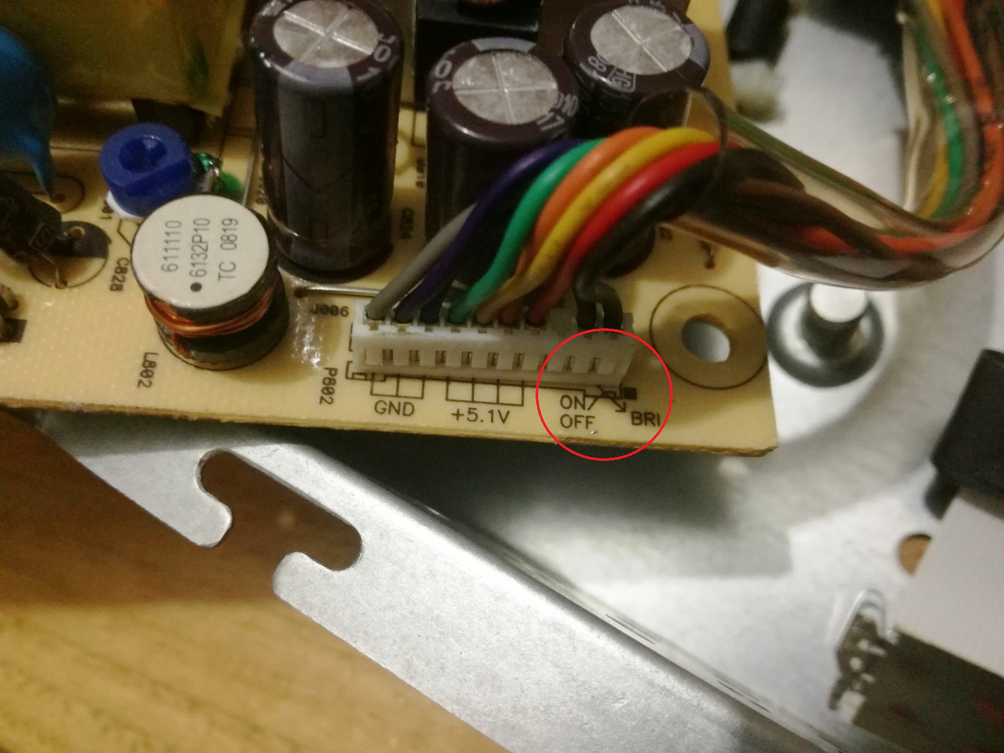

    Originally posted by budm
    See picture for the B+ for the LED driver board.
    You still need to locate the BL_ON signal and the Dimming signal to control your LED backlights.
    Thanks for your post. Tomorrow I'm have free time to fix the screen.
    Just tell me is it necessary to remove the mosfet's?
    Isn't BRI mean brightness (dimming signal control),
    and ON/OFF its bl_on signal?
    Is it BRI first or second pin?
    Thanks again
