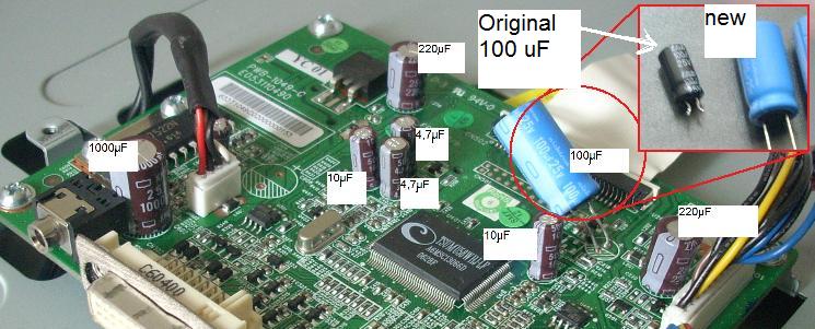

      Originally posted by seanc
      I spy another cap, has it been changed?
      There are 3 caps in this board I have not changed. One you spotted is on another side of big transformer with it's buddy and then there its the small one near big caps (first image). Maybe they need to be changed too?
      I also changed one cap from logic board (or whatever it's called). There was a 100uF 25V cap I could not believe was what it said because it was so small. So I replaced it with nichicon that had same values but size much bigger (3rd image). There is also 1000uF 25V cap on the board which I suspect can't be what it says. It's so tiny.
      The twirling sound is back and it may come from that choke (L106) under schottky. How can I identify what kind of replacement I may try?
      I did some timings today. With brightness set to 35 it operated 2 hours and five minutes. I restarted it immediately and it worked for another 25 minutes. Then it went to 2 secs to black and needed about half an hour in peace. Backpanel was in place to keep heat inside.

        That is the one (with blue arrow) I was asking about hiding underneath the heat shield in the earlier post.

          You might as well change the other 3. Non bulging caps may still be bad. I personally can't justify spending $50+ for a ESR tester as this is a hobby, so changing 50 cents caps is more $$$ justified even though I hate blindly changing things.
          I have NEC 1700V that goes 2 seconds to black and the logic board has seven Capxon 680uF 25V 105C caps that are 10mmx12.5mm. This size is very hard to find so I believe a cap can be 1000uF and 25V and be very small.
          BTW, what is the diameter and height of the 100uF 25V cap in mm? Let's see if we can get a proper size fitting one instead of that sideways blue one?
          Do you have a magnifying glass to double check all the solder joints around the L106 area?
          Originally posted by CapBlown
          There are 3 caps in this board I have not changed. Maybe they need to be changed too?

              Sorry I misunderstood you (and thanks seanc). Now I checked from below and board is divided into 3 sections. That cap is within AC 220V section so I figured out it's probably irrelevant as I get 5V and 14V even after problem occurs.
              I agree and I think I will. I may change all caps on logic board too. I think total cost will be less than $5.
              Original 100uF was 12,5mm x 8mm but somehow I think bigger is better so I don't mind if I need to bend their legs

                From what I read here on the forum, it is important to match the original cap specs in terms of ripple, uF, and voltage. Size doesn't matter IF you have the room for a bigger cap. AFAIK, bigger doesn't mean "better".
                Just a quick glance on digikey shows multiple 100uF 25v caps that are around the size of the original.

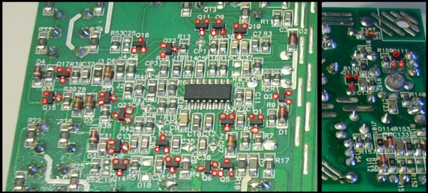

                  On the non circled red solder joints, do they look okay?
                  P.S. In attached image red ones resoldered, green ones replaced.

                    I think I've resoldered most of them several times already. Now I tested to change L106 to another side to reduce it's heating. That did not help either. I noticed from this picture that R42 seems to be disconnected by CP6. Could this be manufacturing defect.

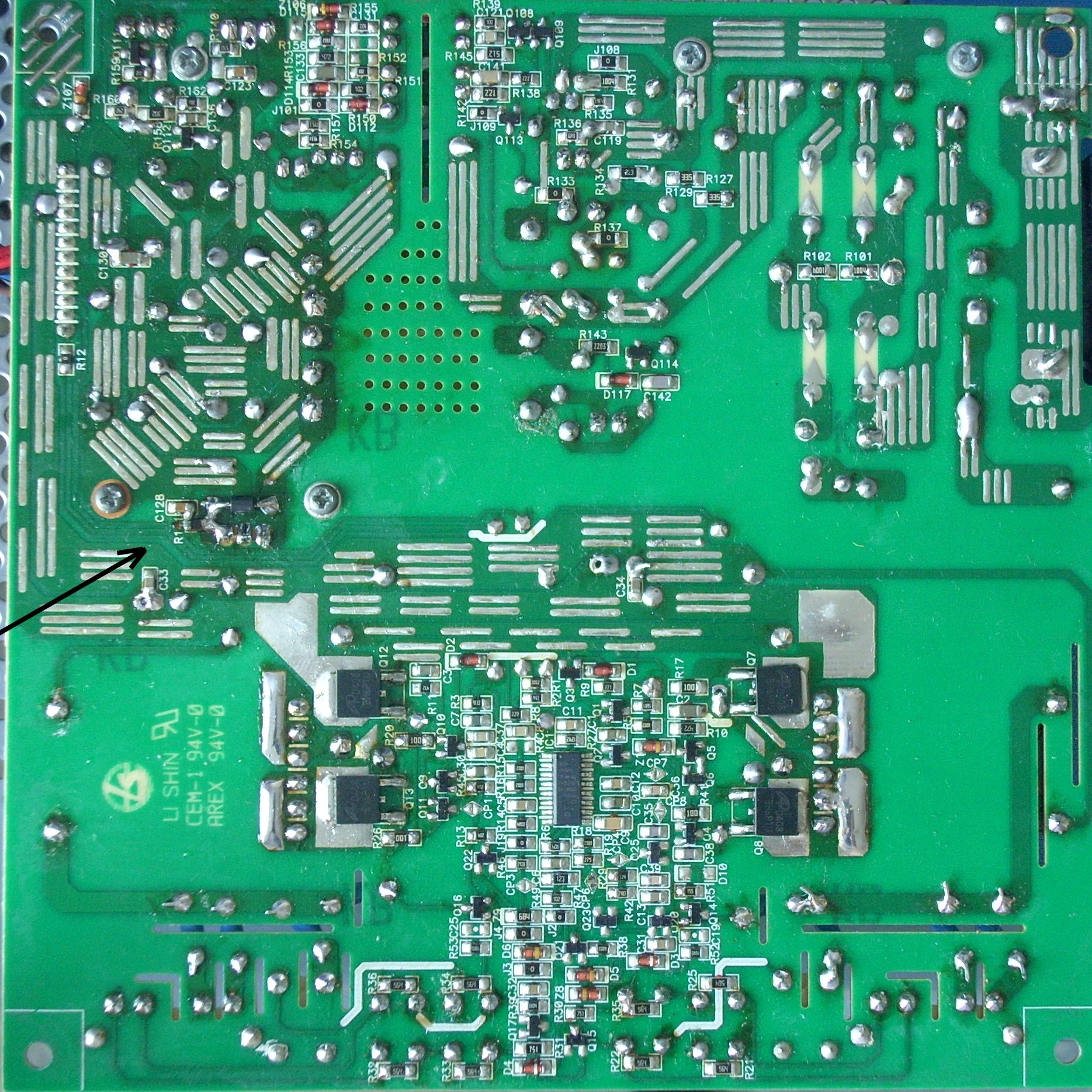

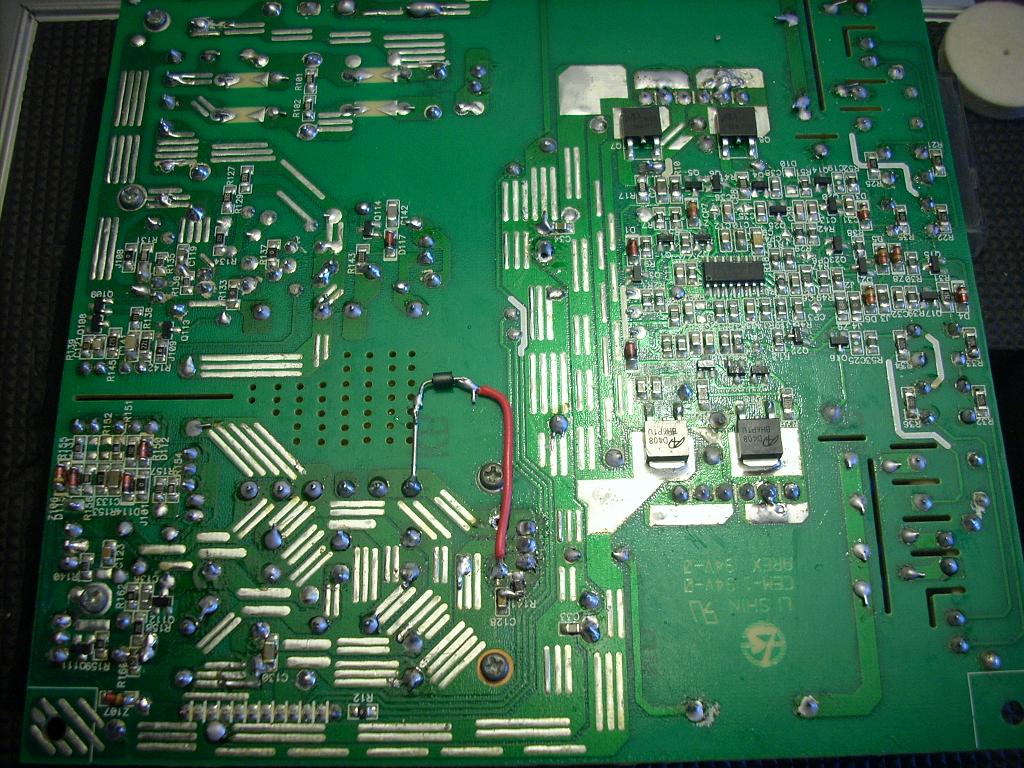

                                To help people with similar problems with HP w20: Here is the image of what I resoldered, some of these did the trick. Total of 60 solder joints

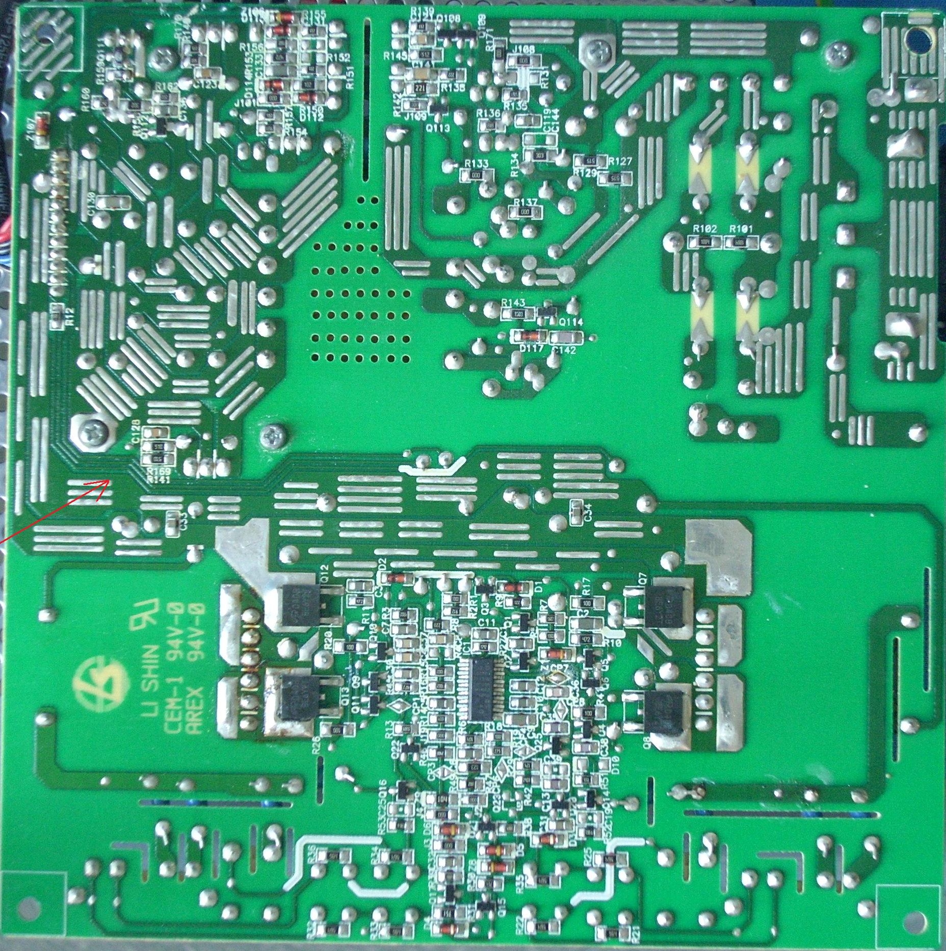

                                  It looked like I got this monitor fixed. But no, the problem came back. Luckily I got similar monitor so now I'm able to compare working one with this problematic one. Currently monitor stays on for about one hour and then 2 secs to black starts.
                                  I could really use some directions as I really have no idea what to do next.
                                  So far I've found out that:
                                  - Problem is certainly within the inverter board. Changing board from one monitor to another switched the problem to there too and after using good monitors inverter board on failing one I'm sure that CCFL's are allright.
                                  - All caps have been changed.
                                  - Both shottcky's have been changed.
                                  On working monitor I have REV 03 board and failing one is REV 02. There are some desing changes so I put images of both ones here. Maybe some wiser man could take a look at them and make some suggestions for me what I could try out next. Is there anything I could measure?
                                  P.S. I noted that under schottky mbr20100ct there is a "big" change in resistance near that small cap. Rev 2 board gives 50 ohms from cap to schottky's anodes (2 x 100 ohms on top of eachother) and rev 3 board only 25 ohms (2 x 50 ohms side by side). I wonder what's the purpose of that as other parts on another side of board are identical.

                                        Thanks Alexanna and Aruba. I've done heating / freezing without any success.
                                        I wonder if some component(s) in the sense circuitry is bad/wrong or failing after enough heat is generated.
                                        Problem is that I have no idea what or where is sense circuitry.
                                        or am I looking at it?

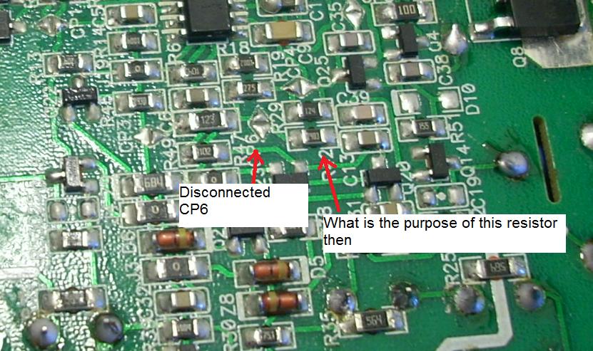

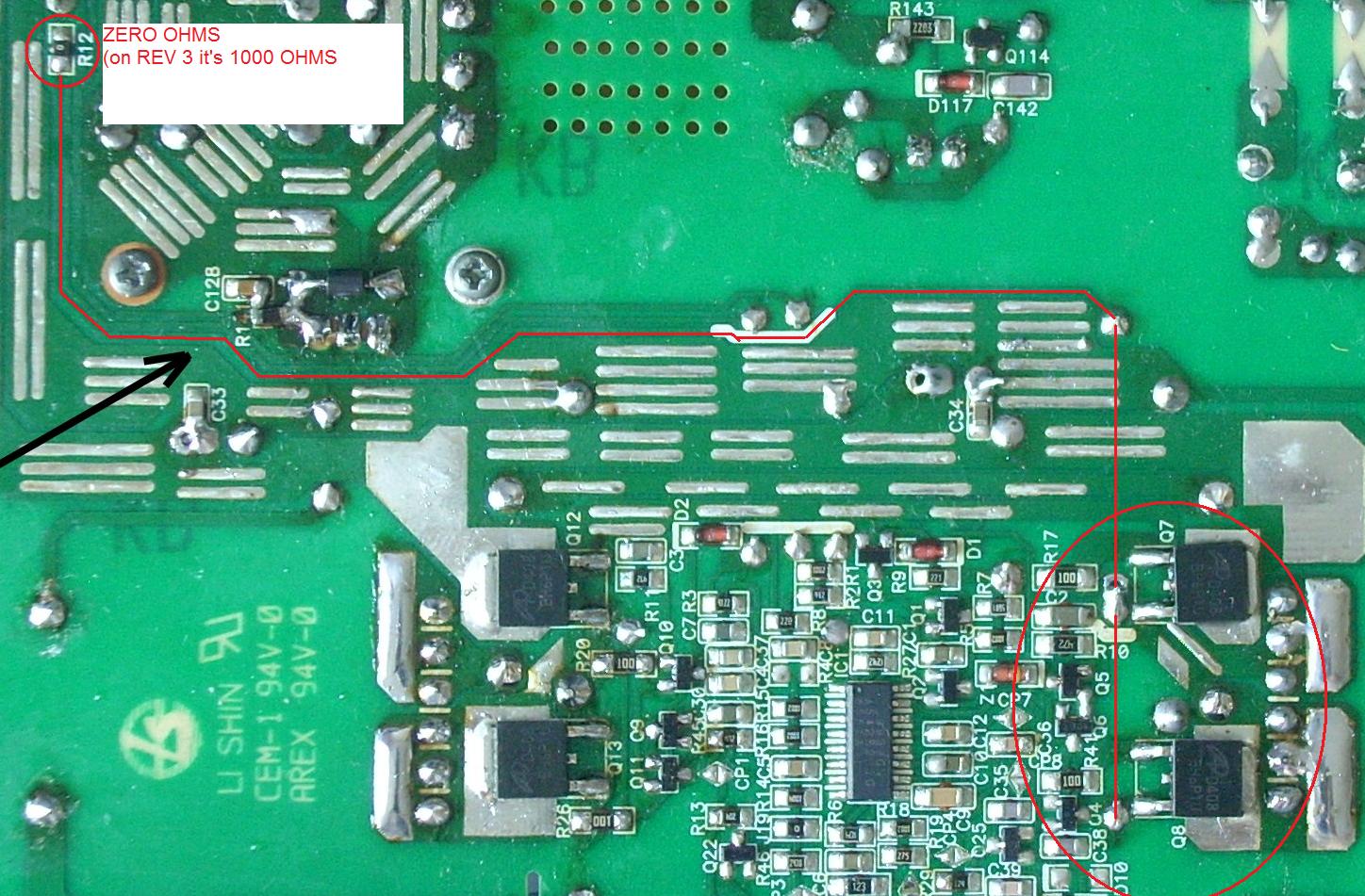

                                        I also wonder why R12 - 0 ohms have been changed to 1000 ohms on that line going to logic board in REV 3 board.

                                          On the rev2 to rev3 question, it looks like there was a functional change needed on
                                          the rev2 boards and was reworked into them. The rev3 boards has this "rework" all
                                          layed out neatly with etch on the pcb. To know the reason why they did this is going
                                          to be hard to find out unless you can get hold of the service bulletin or ECO
                                          (engineering change order). This change is not your problem at this moment. This
                                          monitor was working x years before it failed. What you need to find out what has
                                          failed and replace it/them and first have a working monitor. Then you can go and
                                          investigate (if you want to) what this change is between rev2 to rev3 and decide if
                                          this change affects your specific situation. Changes are sometimes specific like you
                                          only need this change if you are operating the monitor in 35-40 degree C ambient.
