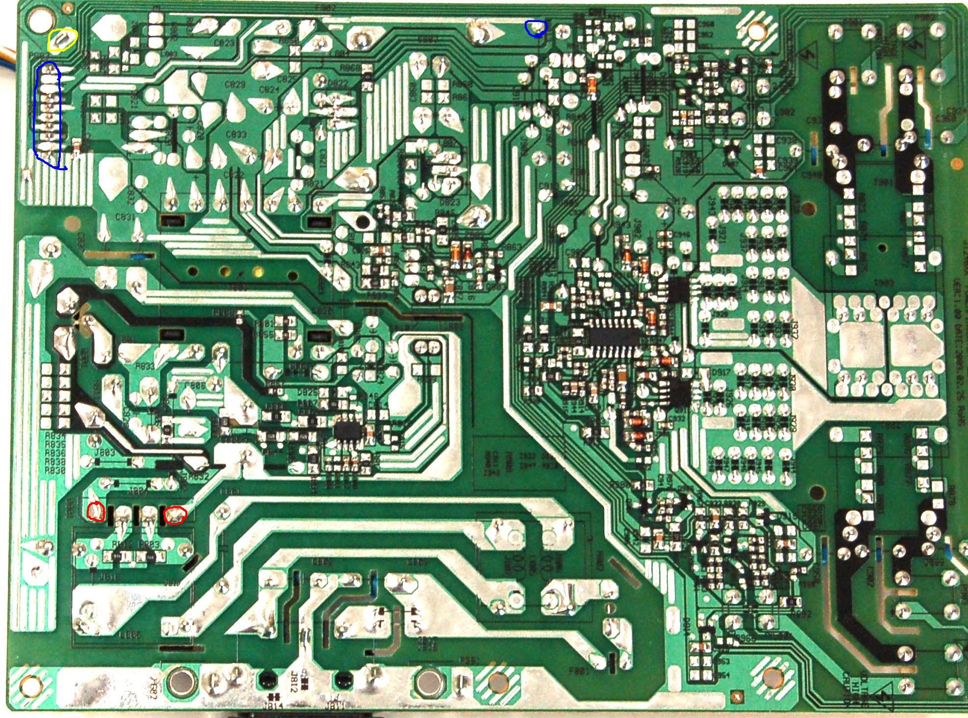

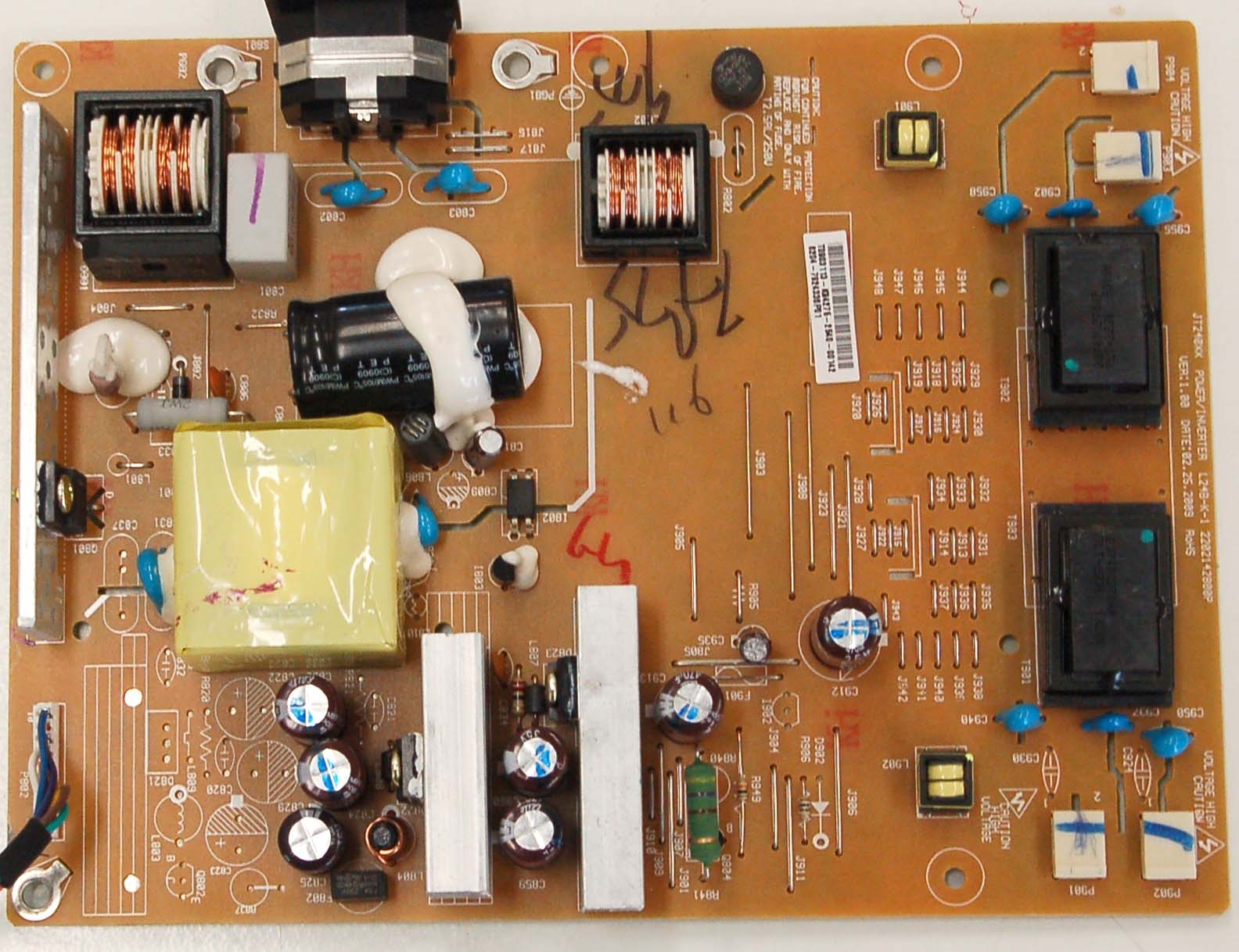

    Dear friends,
    I have this monitor, iiyama ProLite E2407HDSV
    It came on but nothing on the screen, I have checked all the caps on the both inverter and psu board and the entire caps look ok no bulging or leaking as far as I can see.

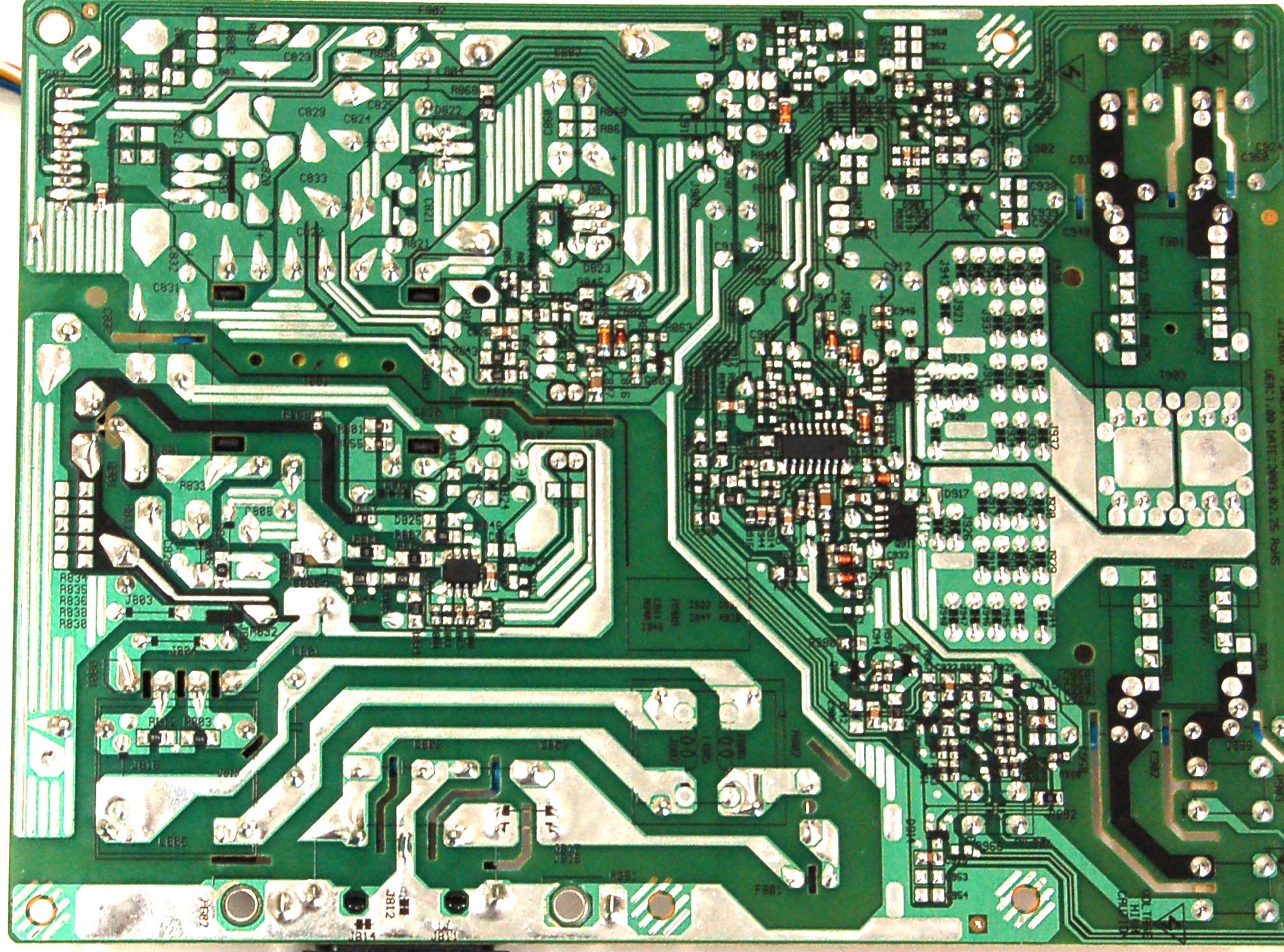

    Re: iiyama ProLite E2407HDSV
    This are pics
      Originally posted by tama4tama
      This are pics
      Thanks for the excellent pictures. They make it much easier to help.
      Red circles in lower left: With monitor plugged in, CAREFULLY!! measure the DC voltage between the two points. Should be about 1.4 times your AC line voltage.
      Yellow circle in upper left. Ground point for following tests. Measure the DC voltage on the points circled in blue. Also note their is one more half way across the board to the right.
        Thank you Plain Bill, I am back to ground zero, before I could do the testing the fuse has blown, I replace it and gone again so by the troubleshooting I found that the power mosfet 2764I (Q801) has shorts between all the legs, I have google it but I did not find it. Please is there an equivalent part to use.
          It's an AP2764I-A The datasheet is available, and the parts are available here.
