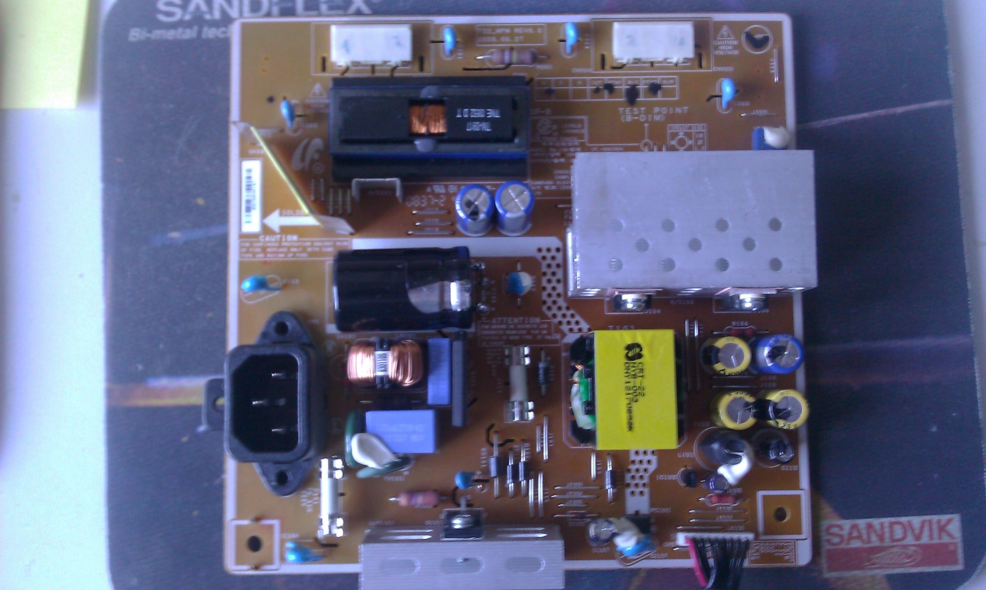

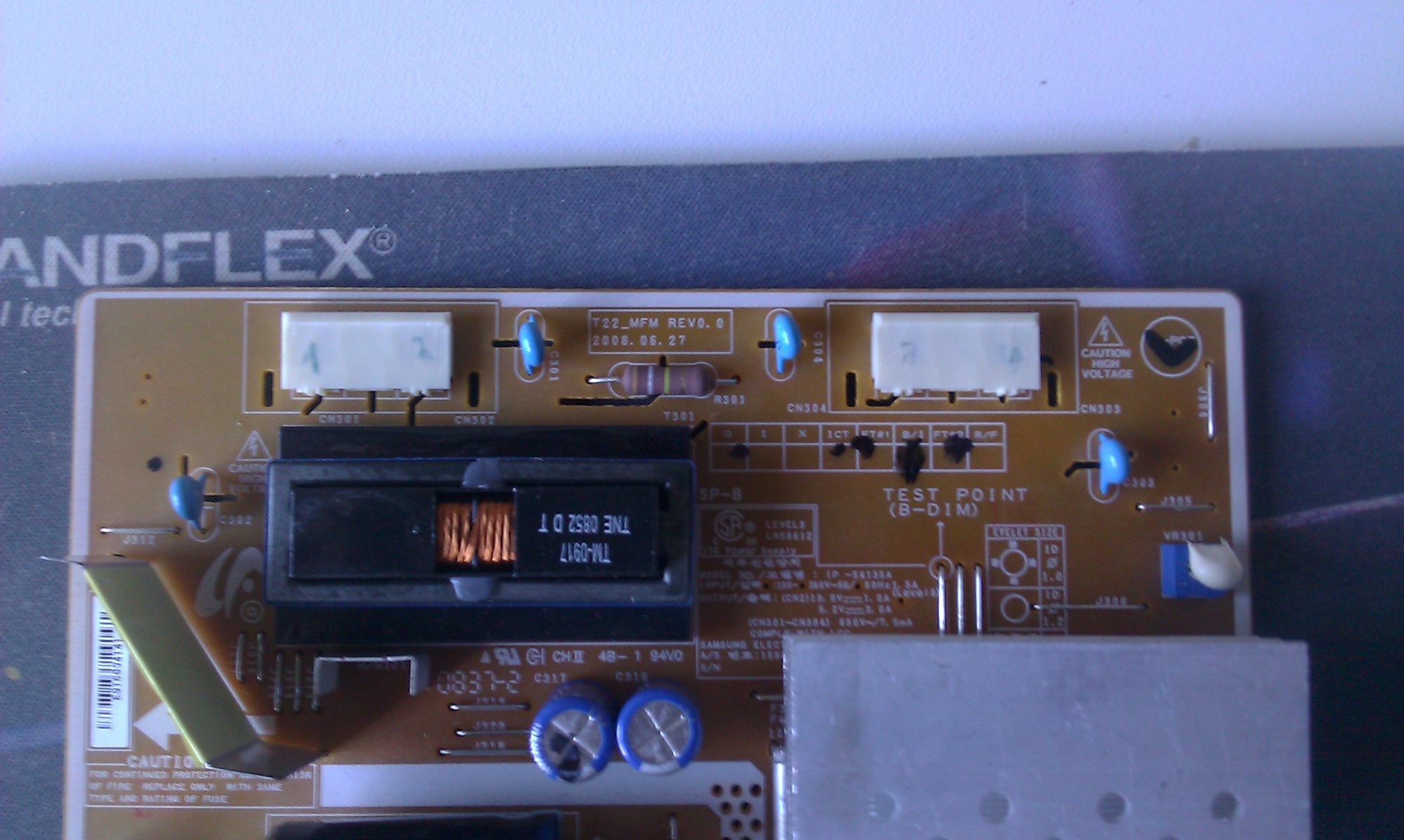

    Sorry to bring up an older thread. But has anyone found a solution to this?
    Burn marks in the same place on mine, except my monitor is a T260, but same looking board.
    I have resoldered most of the major components hoping that might fix the problem.
    But same 2 seconds on then off.
    I have a new transformer on the way, thats the next step.
    Other than that, all the capacitors look ok, doesnt mean that they are though.
    Cheers
    Dribbles

          If anyone has this problem in the future, it was the transformer. Unsoldered, resoldered the new one,
          put it back together, All is well

                model: 2233bw -
                I have a 2 seconds then black problem after replacing an AP4506GEH ((Push/Pull Mosfet dual channel N/P) to-242 SMD 4 + 1 legs.)
                With 2x TO-220 packaged MOSFET with similar ratings (30v rdson 0.28ohm/0.36ohm) and connecting the D legs together to make a dual mosfet.
                The very reason i did go this desperate path is because couldn't find AP4506GEH or anything similar (several mosfets with same package mentioned in this forum) in the Thai semiconductor market.
                The least is that the MOSFET tweak did work. However, I will post photo of the charred board and circuit pattern around the AP4506GEH, and offcourse the driver mosfet is burnt as well.
                After reading the above posts, I can only think of the transformer gone bad. But isn't there any way to revive this end transformer? lets say by chilling it in a freezer and injecting epoxy glue to it afterwards? i saw some aircon engineers did it with such coils here in thailand.
                My only releive is that it does light up for 2 seconds. I reflowed many points and changed 2 capacitors..
                Still have to measure the transformer. Anyone know where i can buy this?
                I'll up some pics tommorow. Cheers!.

                    Any advice please T240 classic two second on off. Have replaced caps and transformer. If I switch the monitor on and off a number of times the screen will come on however to get it to switch on again i have to cycle on/off a number of times. Have wasted too much time on this please any advice or help.

                        I had the same problem (switch off after a few seconds) ;swapping with a CCFL of recovery I finally found that it was the top CCFL (CN304) : during disassembly I overview the wire was stripped and insulation damaged .

                                    Solved! Cold solder in CCFL!!!
                                    To check necessary disassembly LCD.
