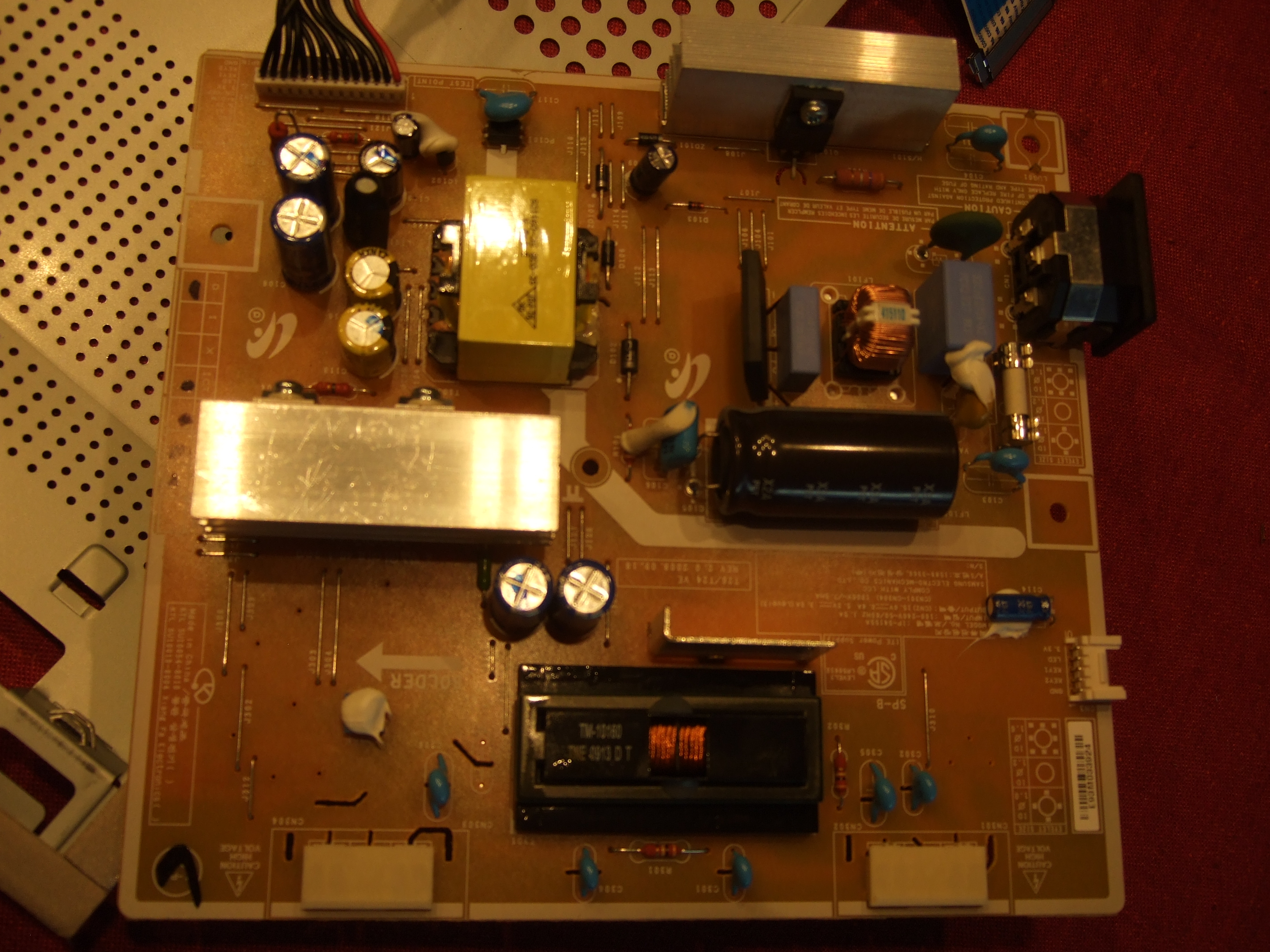

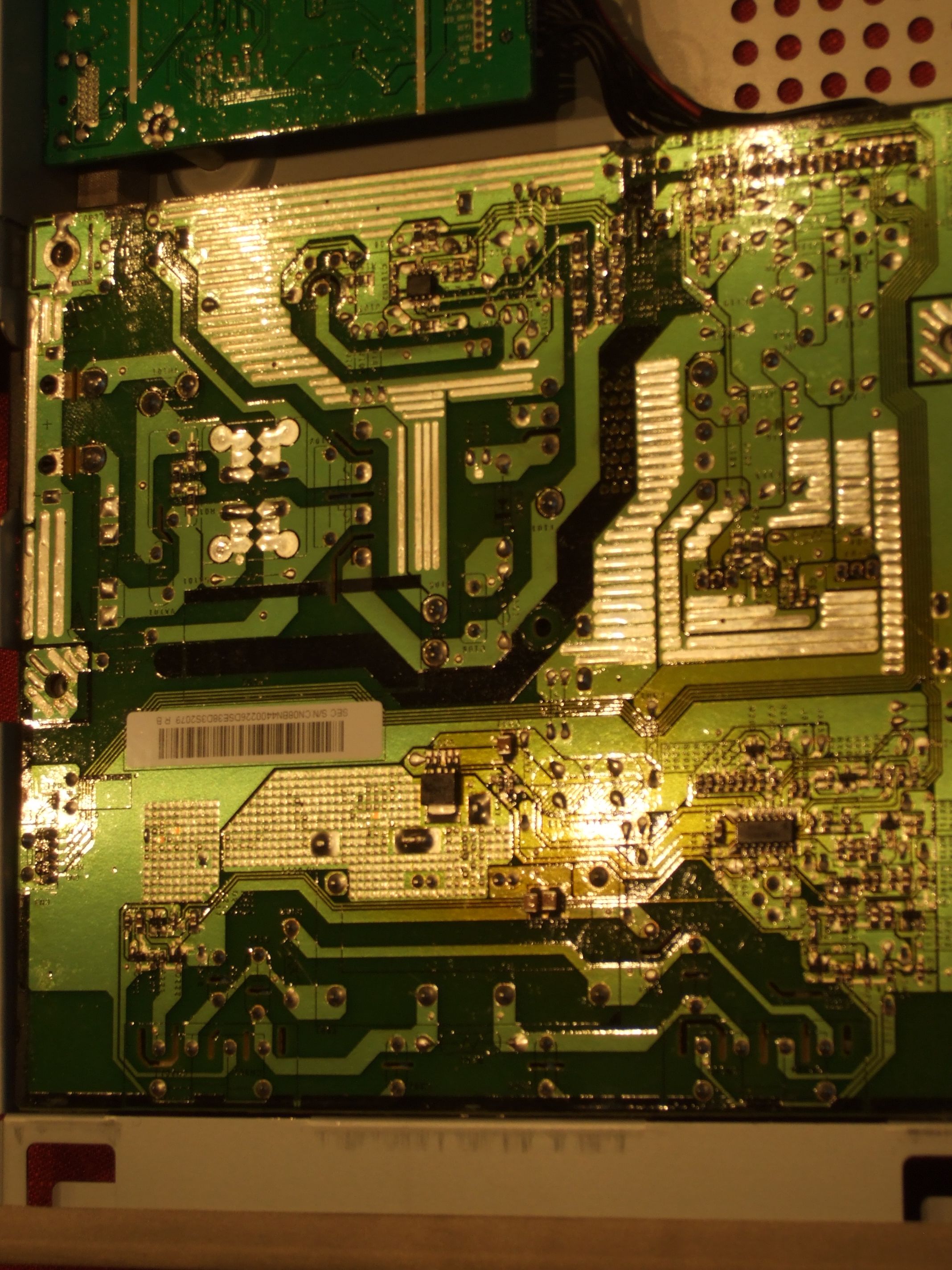

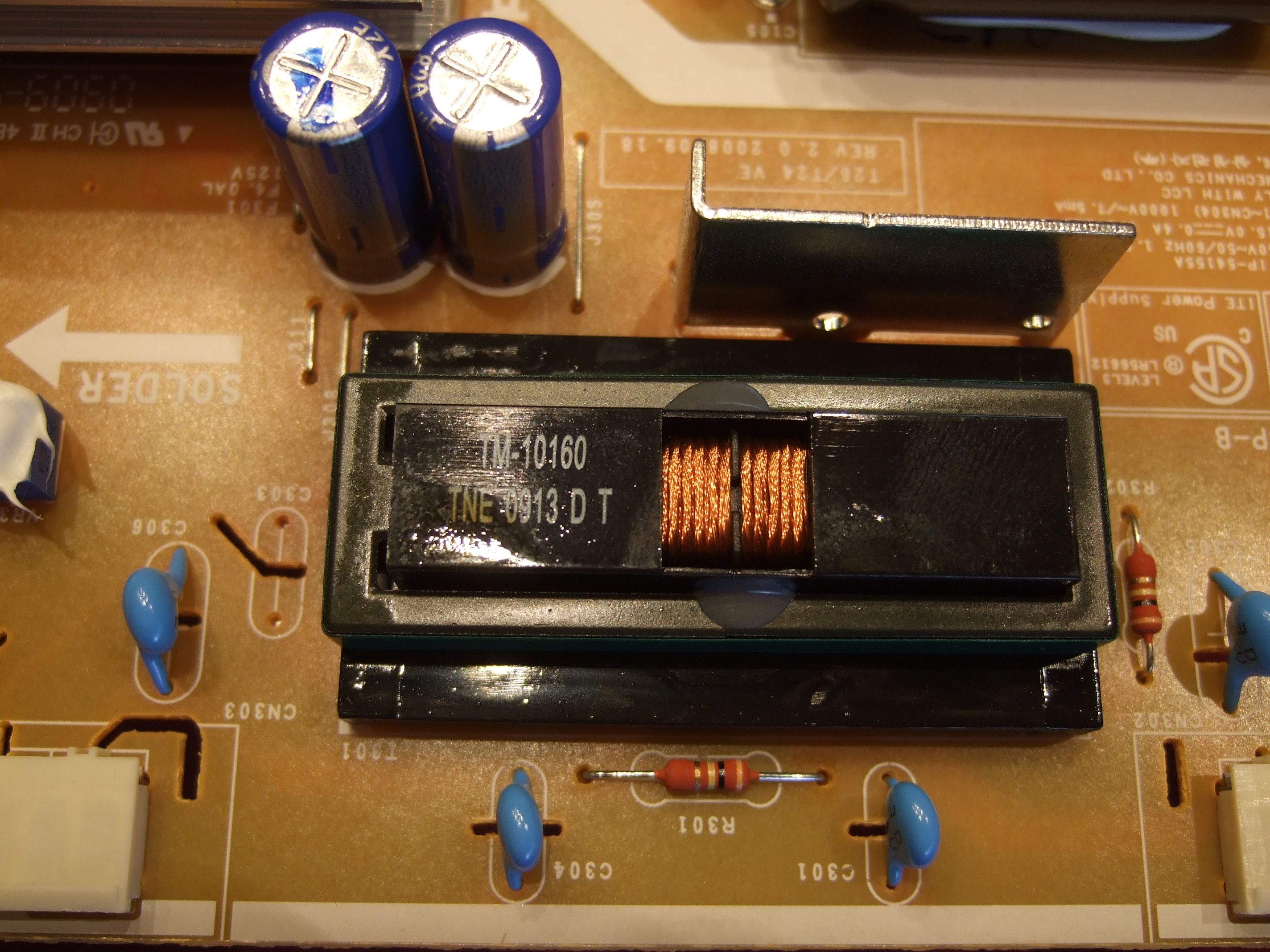

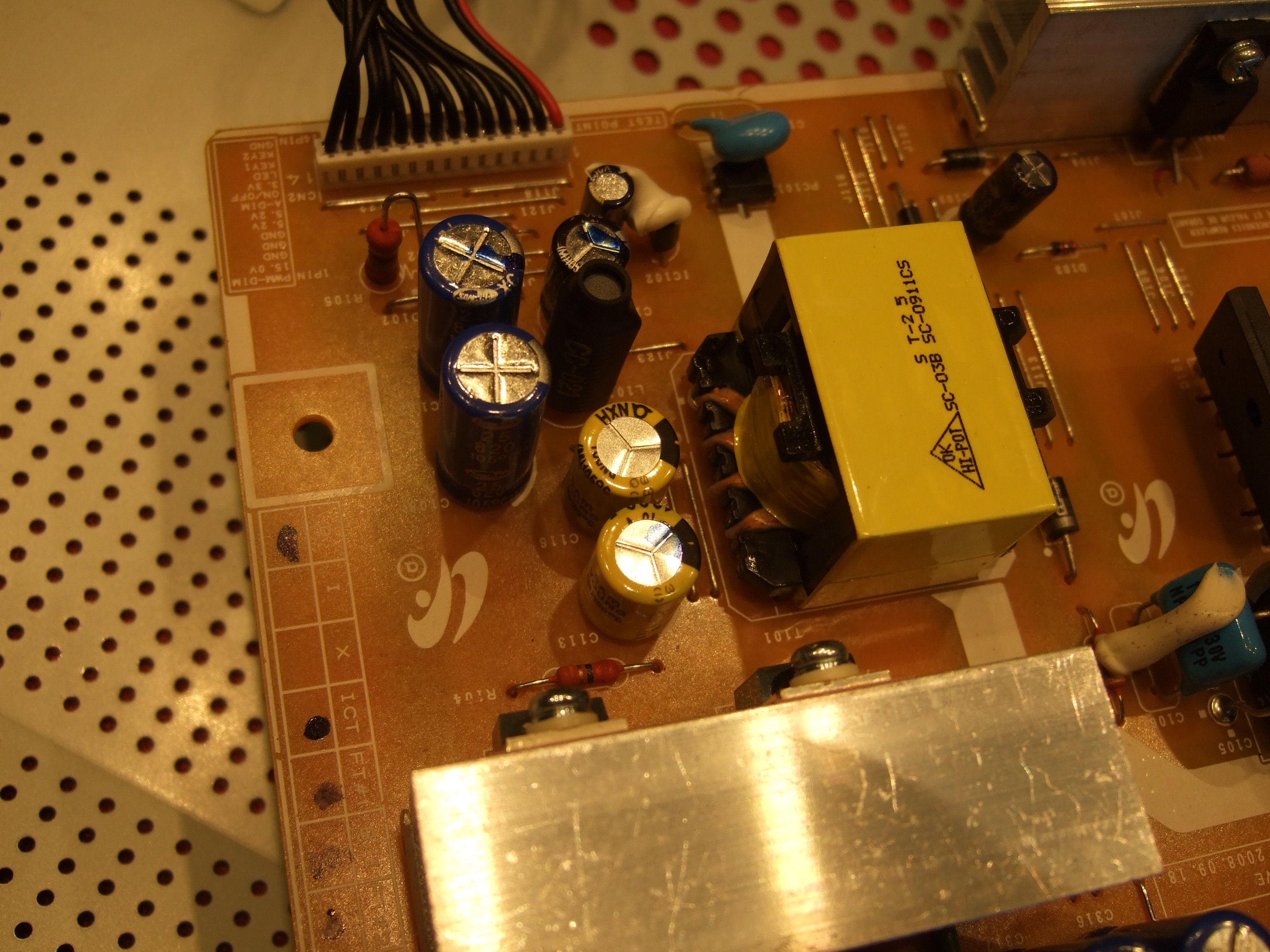

      Here are now some pictures from the main board .
      I have measured the resistance of the secondary inverter coils:
      That one nearer to the AC plug has 880 Ohm, the other one 930 Ohm (the inverter still on board).

        Pictures are not really clear enough for trouble shooting ( probably not enough natural light)
        That looks to be your problem- they should be within 3% .I usually end up buying from ebay China - takes a long time but a lot cheaper.
        FIRST desolder the transformer and test again off the board..

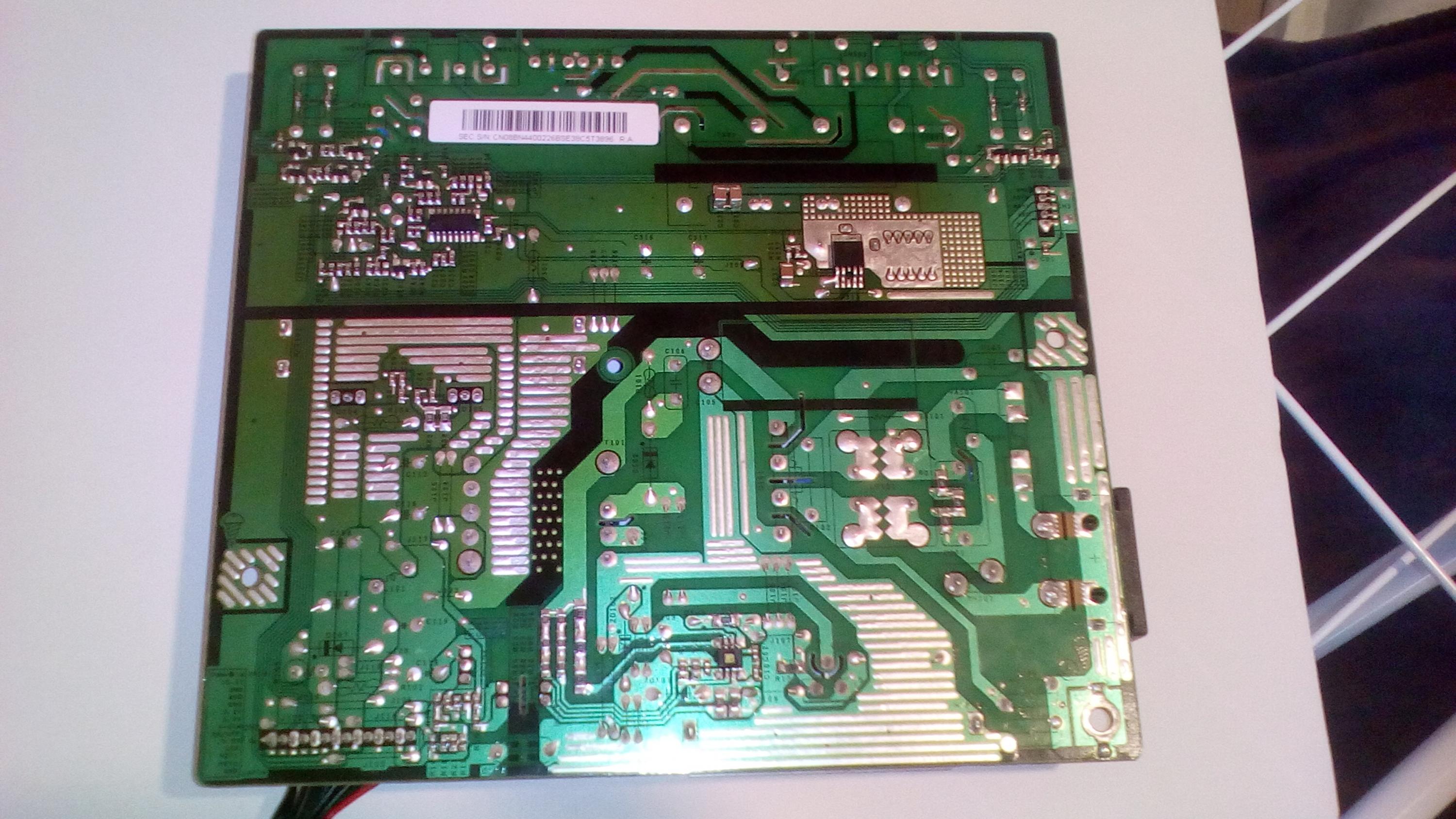

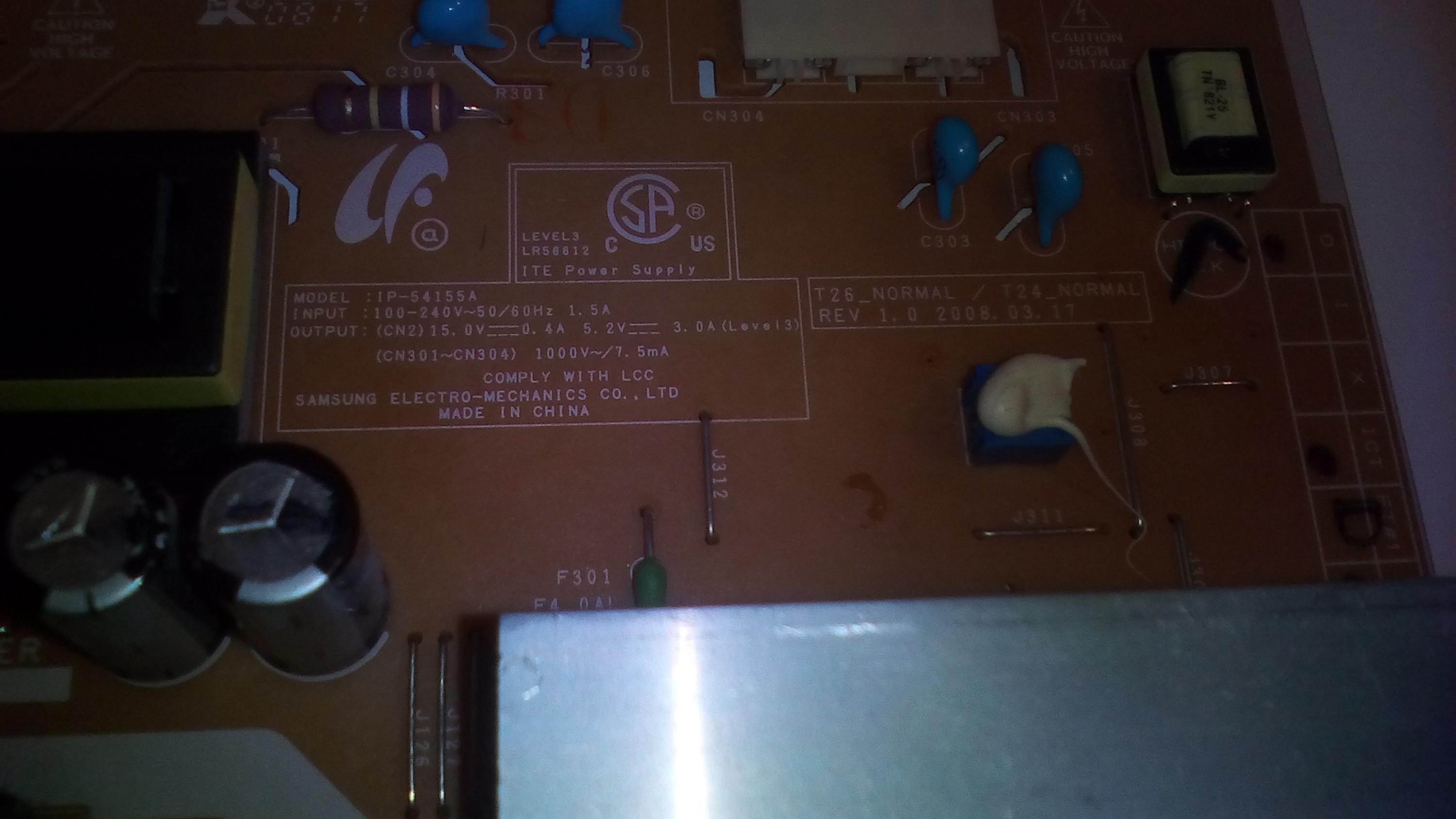

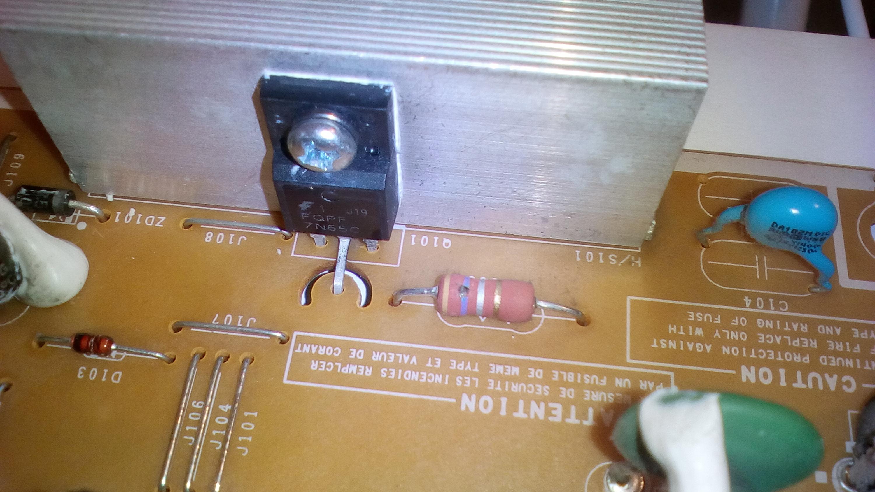

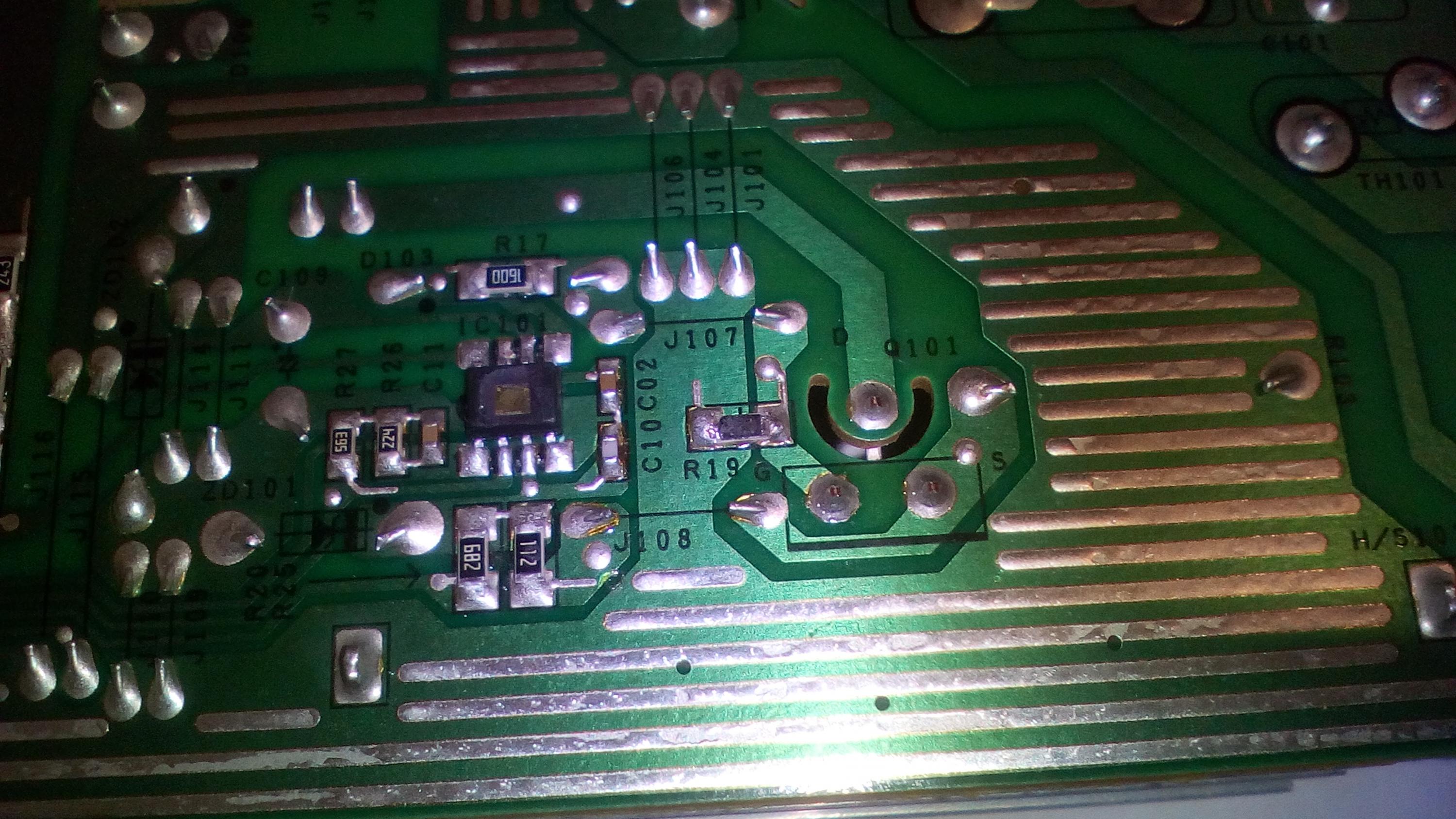

            Good afternoon. I have a monitor Samsung T240 with power supply JP-54155A, REV 1,0 from 2008.03.17
            Burned:
            Q101-7N65C
            R103 - 0.37 Ohm
            D103
            R19 - 10кОм, face value found in the photos of the forum
            IC101 - I do not know which one.
            Tell me where to download the scheme or the name of the chip.
            Attaching photo. Thank you very much in advance. Attaching photo.

              #66
              Re: Samsung SyncMaster T240 - 2 seconds then black problem
              Found
              https://cdn.badcaps-static.com/pdfs/...c8dc5a9678.pdf
