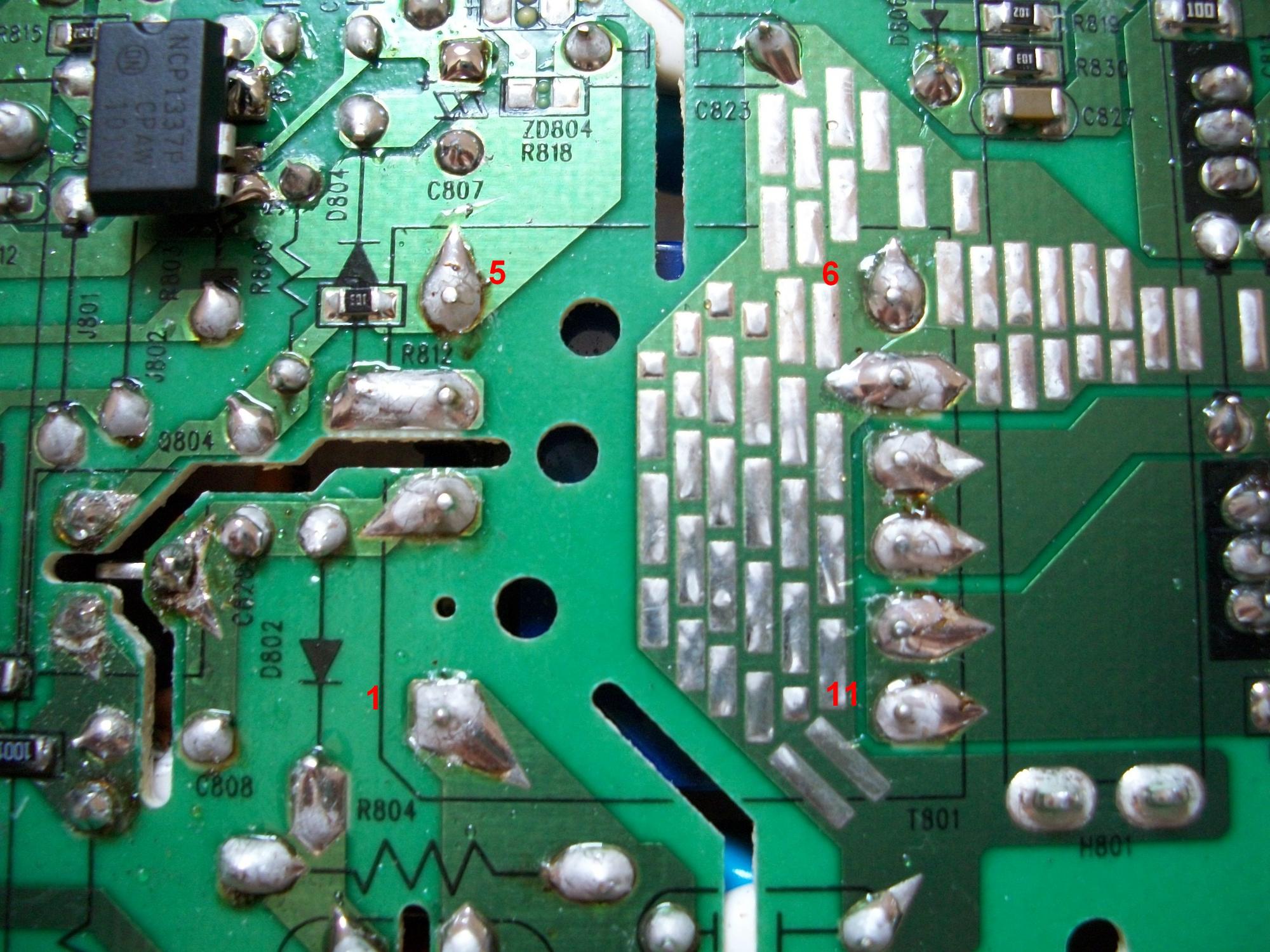

          #64
          Re: emachines e19t6w inverter powersupply help
          Originally posted by jselvatici View Post
          The diagram says that the transformer has 8 pins, but here it has 11 pins.
          I see the main voltage input, but hard to identify which pins are the right output voltage.
          Just one thing, I have 308Vdc going to Pins 1 and 3 take a GND as a reference. Pin 4 I have GND. Measuring in the other side, no reading at all, looks like a bad transformer... what do you think? Shall I remove it from the PCB to take a better look?
          Tks!

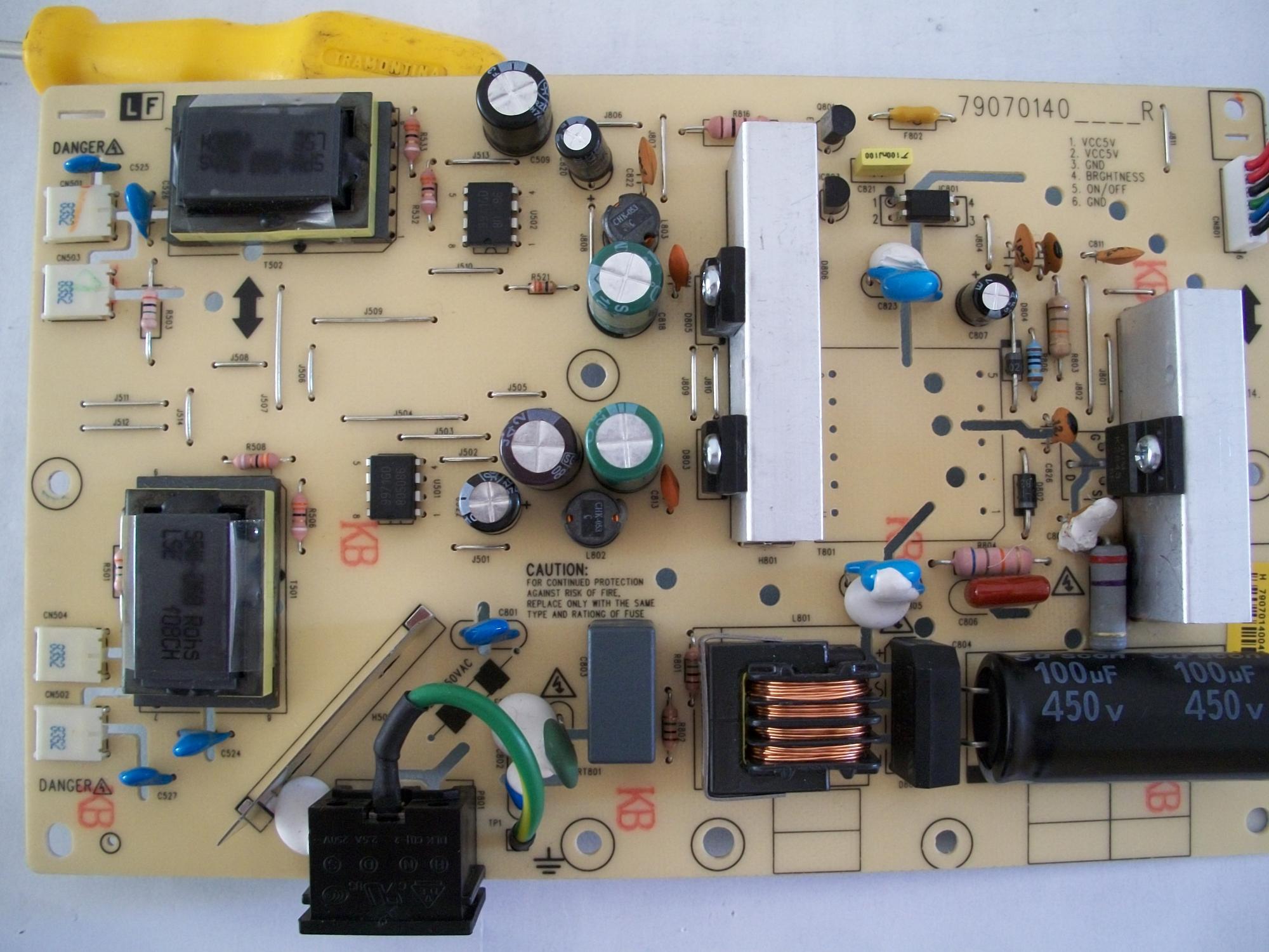

                #67
                Can I get a focused shot of the front board? The one that you posted earlier at
                https://www.badcaps.net/forum/attach...7&d=1282712985
                is too fuzzy to read the board designations.
                --- begin sig file ---
                --- end sig file ---
                  #68
                  Here we go...
                  I'm goingo to work now, so I will not be able to take any picture for few hours..
                  But let's keep moving...
                  tks a lot!

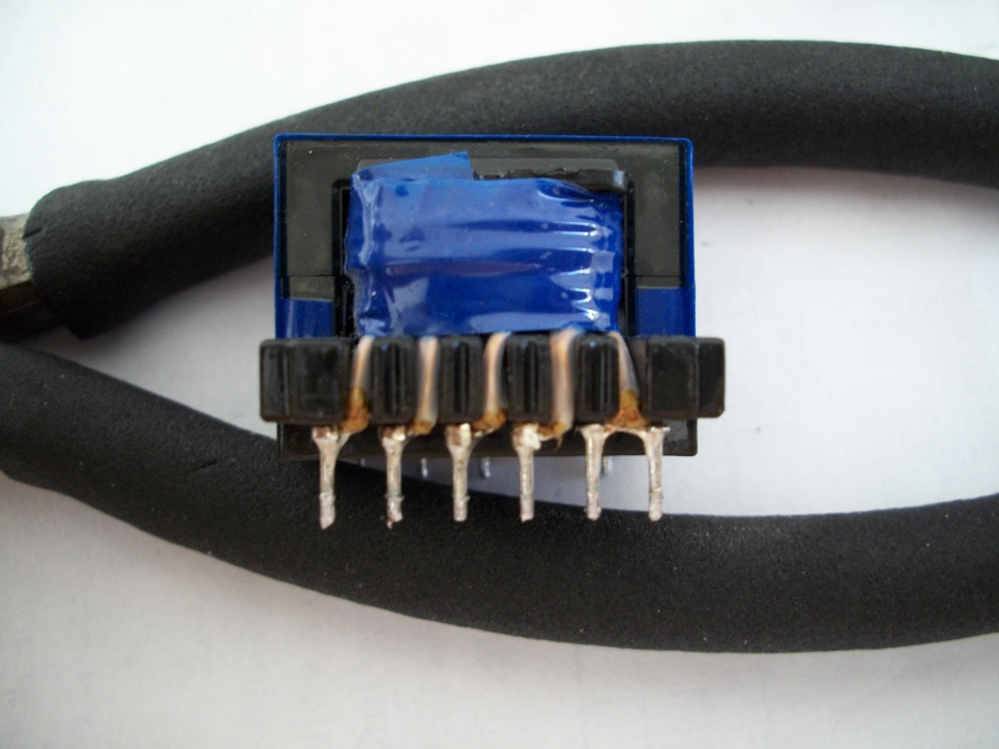

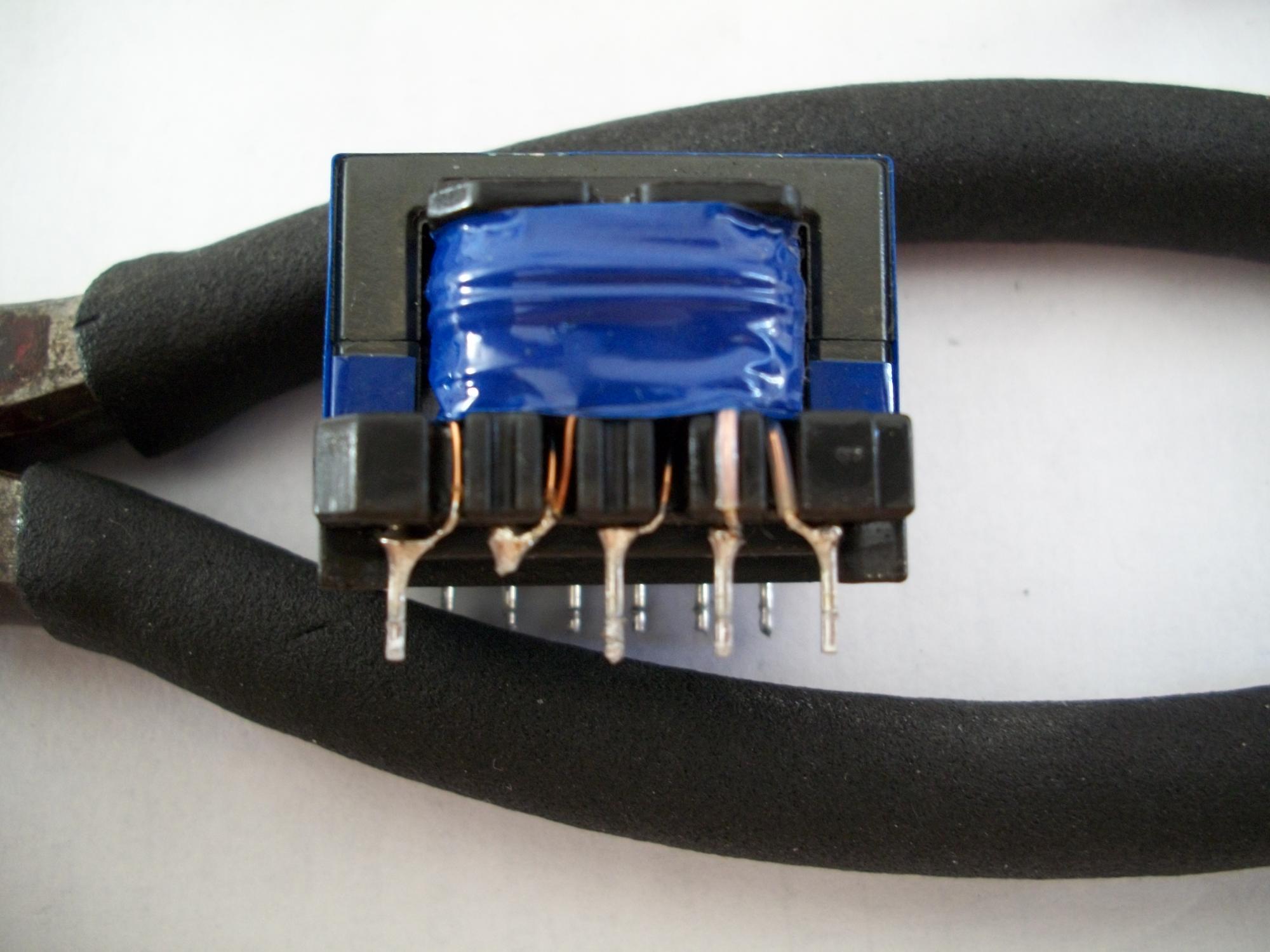

                                    #77
                                    Test pin 8 and 9 on the transformer. They should be shorted according to the schematic. You should get a reading of less than 1.0 ohm.
                                    Let's take this side as a secondary, all the pins (6 , 7 , 8 , 9 , 10 , 11) are shorted and they measure less then 1.0 ohm between each other.
                                    When the transformer is installed in the PCB, it shorts 6-7 than 8-9 than 10-11. (see picture available)
                                      #78
