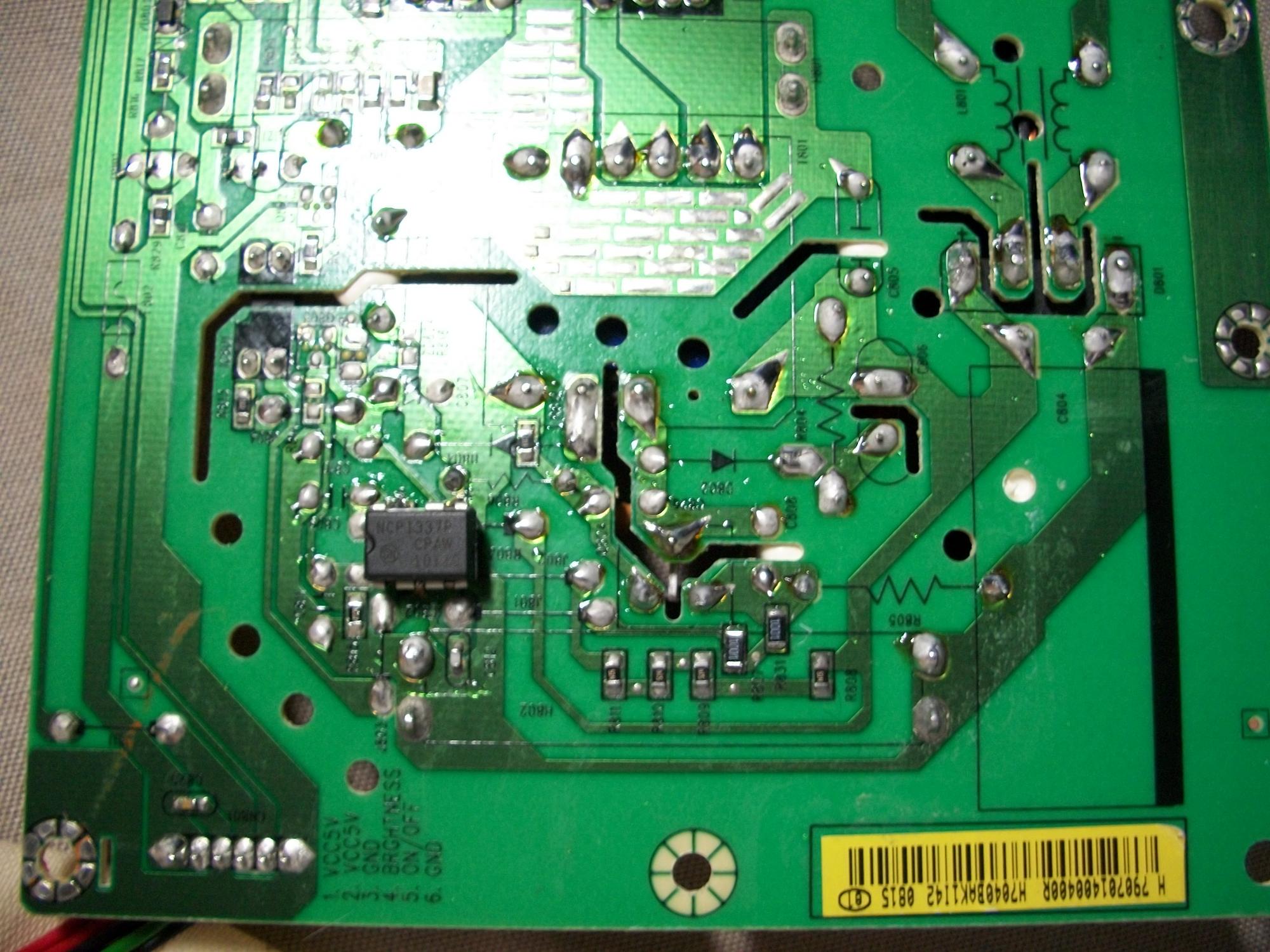

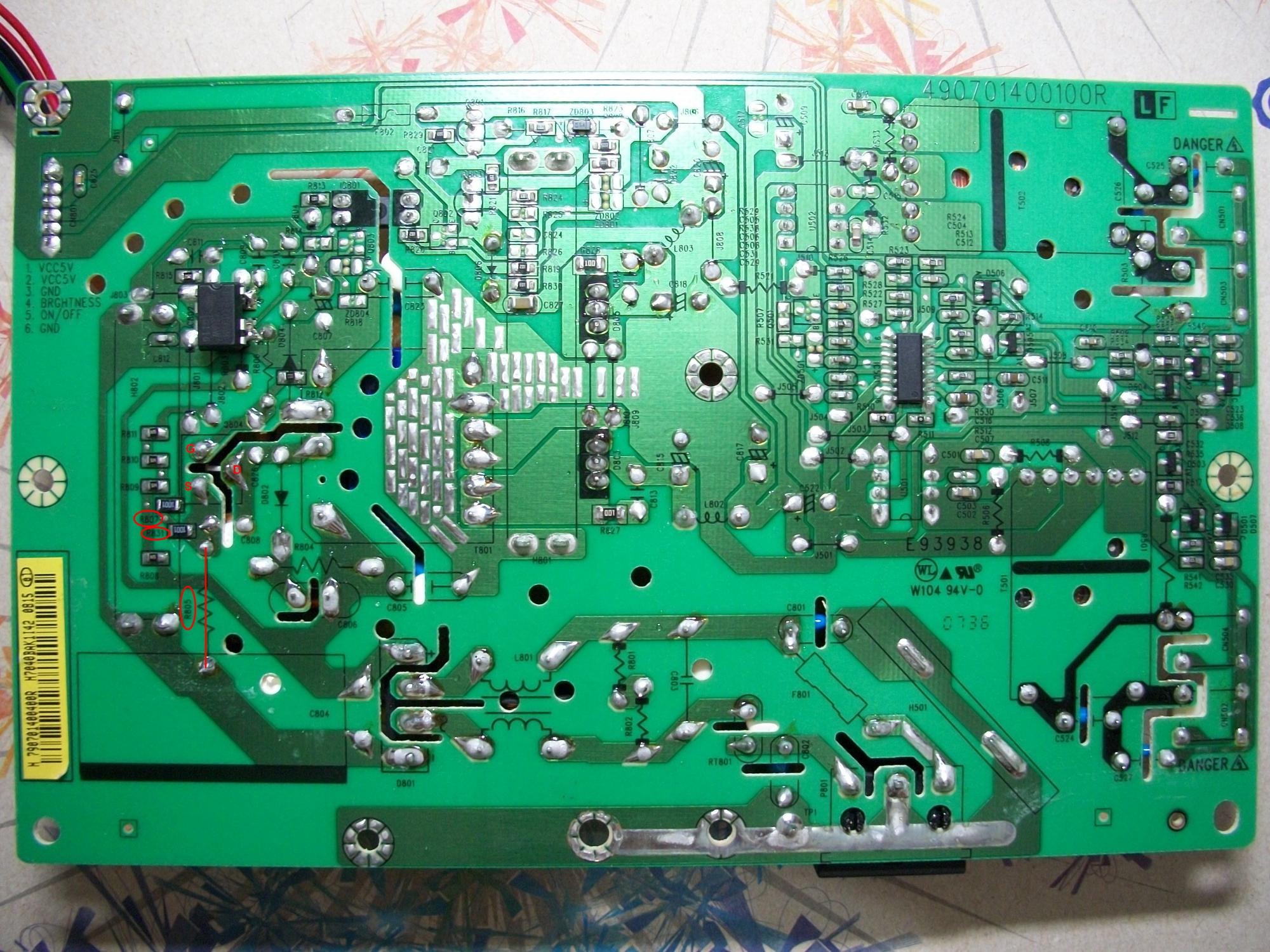

        On the back side of the board, there is a chip right next to the connectors (right below the connector - upper right hand corner on the backside photo). I can't make out the designation, but it looks like a 5 legged chip.
        What is the part number or writing on that chip?
        BTW, can you get a focused picture of the backside? Take the board on a sunny day (which shouldn't be hard in Brazil), put your camera on macro mode and flash off.

            NCP1337
            It's a 7 pin IC
            I have replaced it, because it was cracked (very easy to identify).
            I will post the pictures. I got those.
            Yeap, here is almost 3am.
            tks for your help.

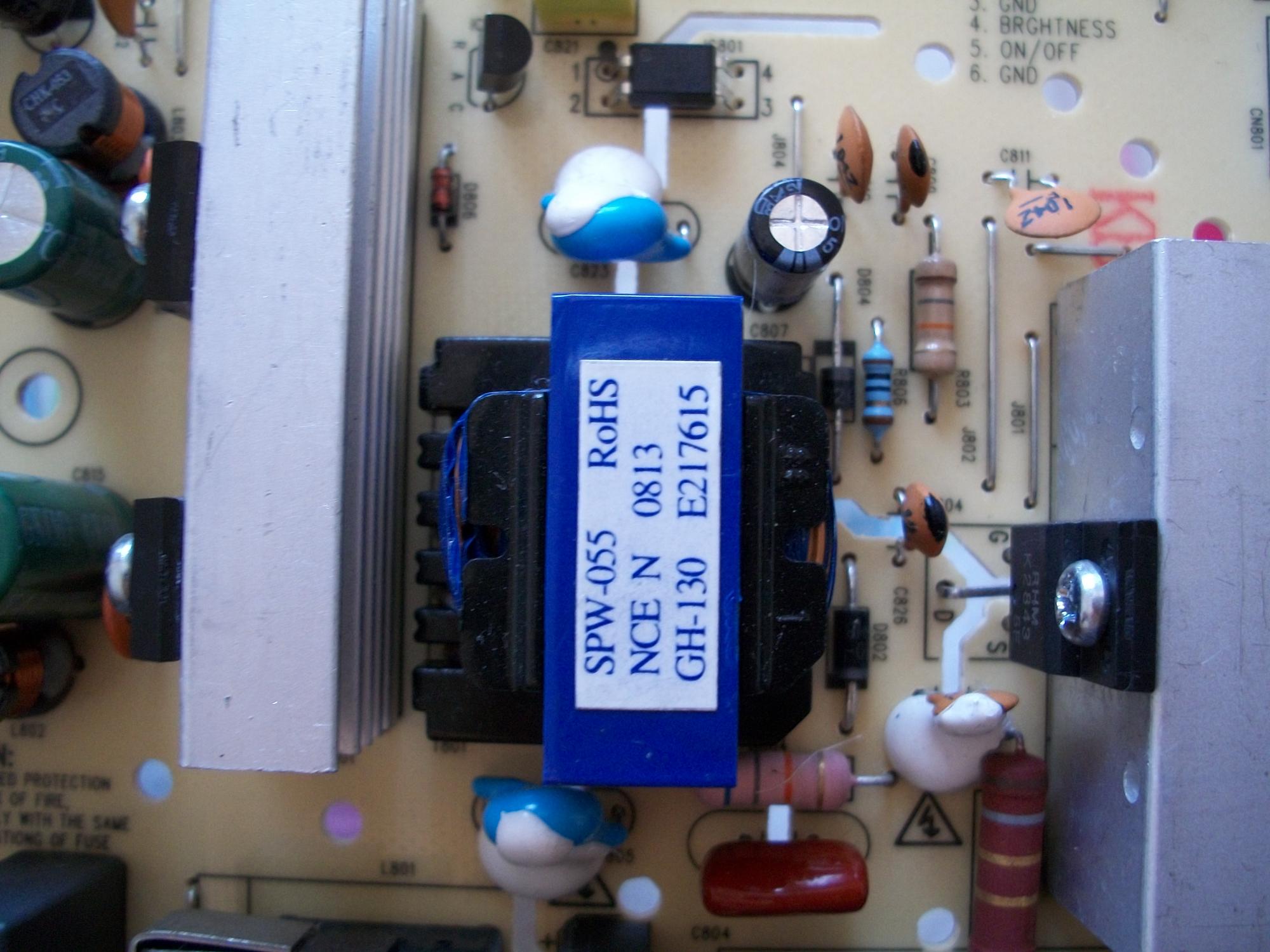

              1) The datasheet for NCP1337 is at
              http://pdf1.alldatasheet.com/datashe...NCP1337PG.html
              You will need to download that and refer to it for voltage measurements. Pin 4 is your ground. Please list voltages for all pins.
              2) Did you replace NCP1337 before you posted here or after? It matters to know when you replaced it.
              3) Was the original IC that was cracked also a NCP1337?
              4) What is the value of the capacitor just above the transformer (SPW-055 Rohs)? Who makes it?
              5) There is a yellow "jeanbean" fuse next to the 79070140 number. Please measure that fuse and make sure it is 0.3 ohms.
              6) If possible, can you check for 5V DC with the logic card disconnected from the power/inverter board? I have one LCD where the 5V DC and 19V DC secondary voltages are stable and present ONLY IF the logic card is disconnected (implying a short somewhere).

                -> Taking the Pin 4 as ground, the voltage is Pin 1= 0VDC Pin 2= 0VDC Pin 3= 0VDC Pin 5= 11VDC Pin 6= 0VDC and Pin 8= 275VDC
                -> I replace it after the problem. The only thing is, the previous component was SMD and I couldn't found SMD, so I installed a normal one.
                -> Yeap, part of it was off.
                -> The blue one says "JN222M 440~X1250 400~Y 17DC
                -> The "electrolitic" says 47uF 25v.
                -> It has 0.3 ohms.
                -> I did this measure before and there's no 5V there.

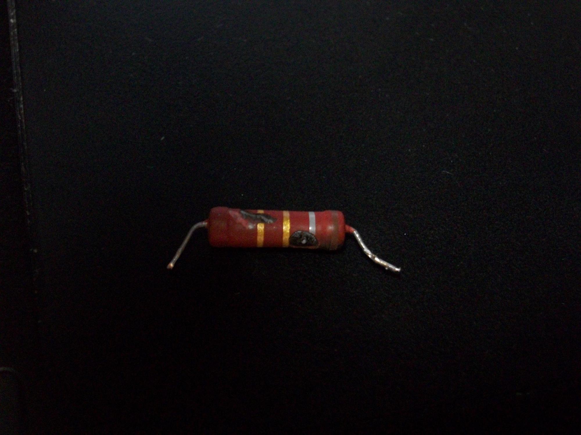

                Now I have another problem. During the measurements one resistor blows out. And this was replaced before because it was open, so something is in short and is blowing the resistor. It's the last picture.
                After it blows, I turn off the power. Should I power on again?

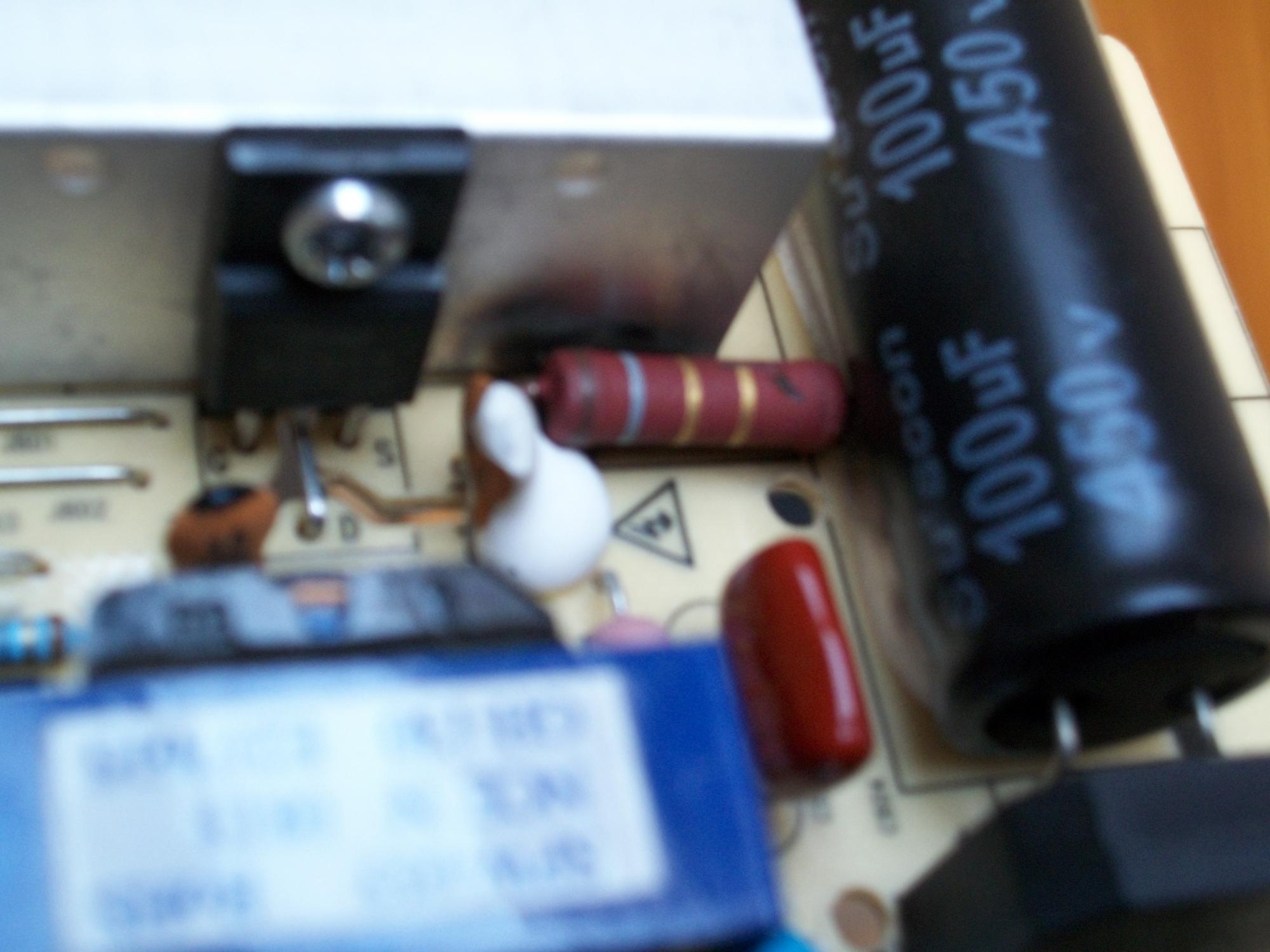

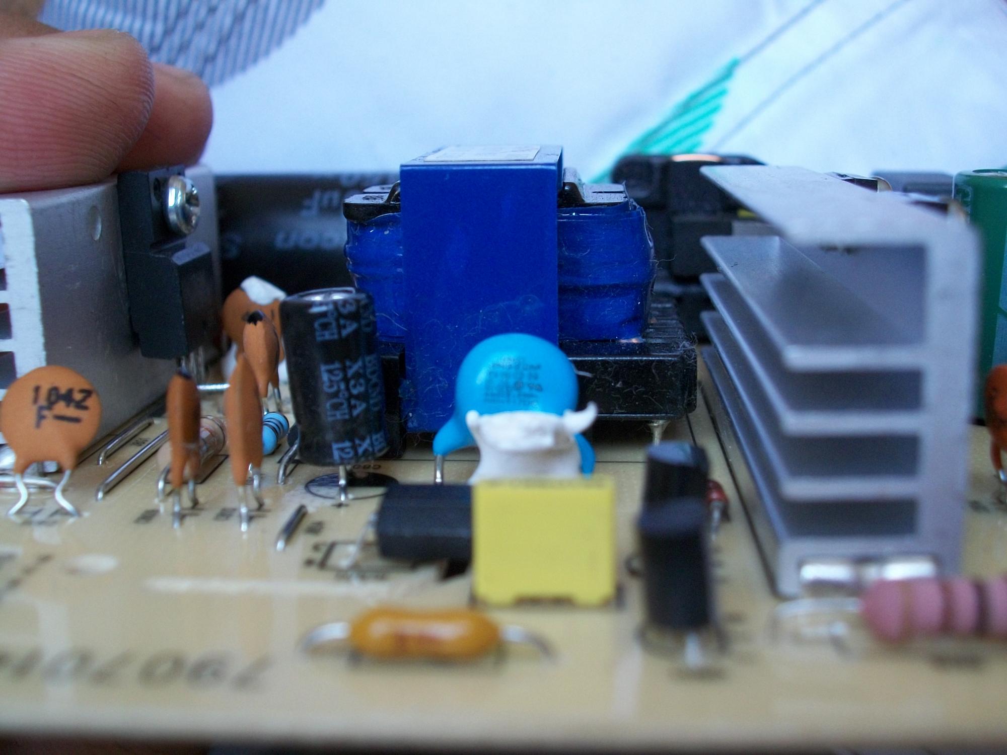

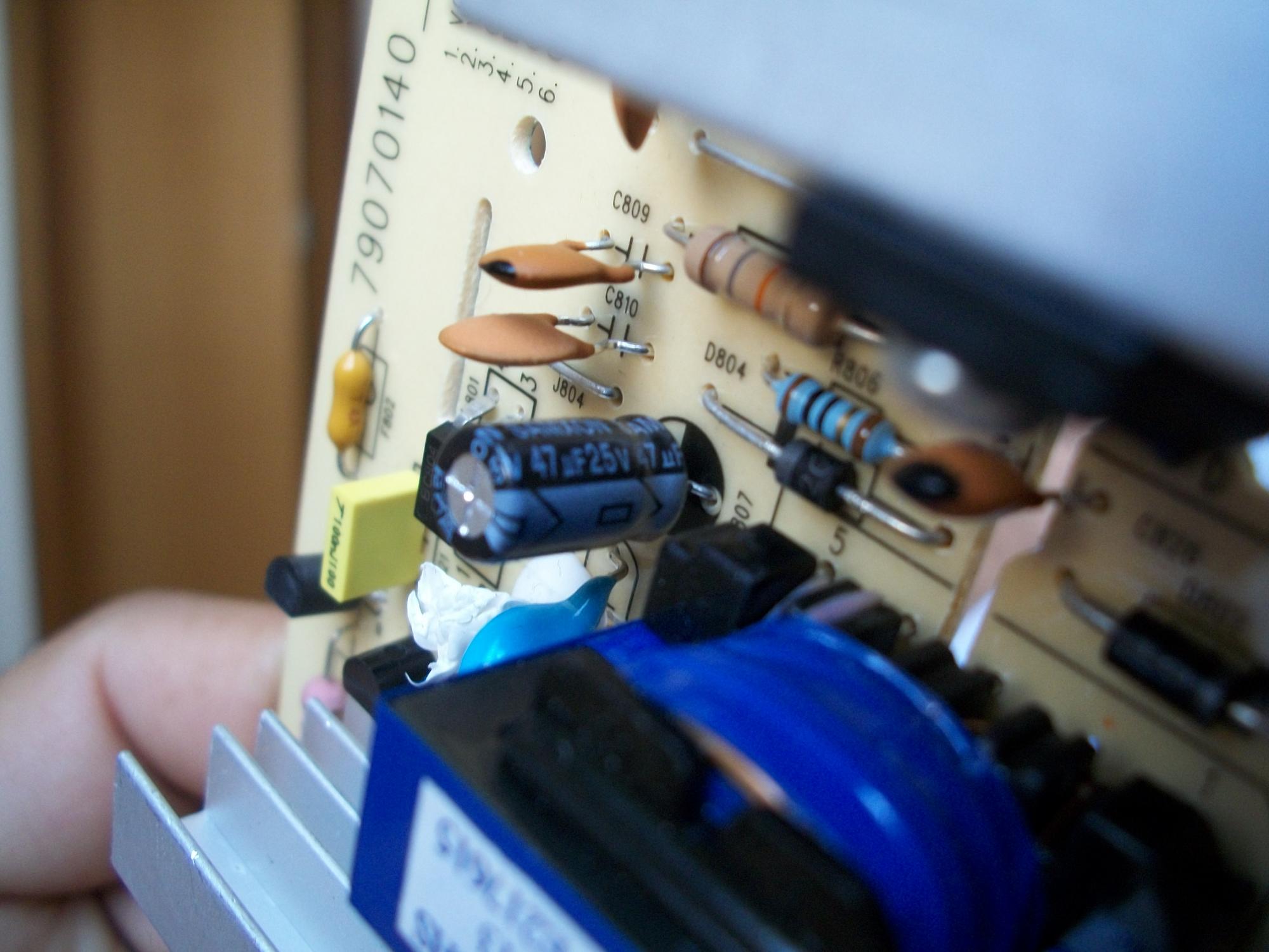

                  1) Okay, please disclose everything else that you found BEFORE you posted. Letting us know about the bad NCP and open resistor is something we need to know. Was anything else replaced or found wrong?
                  2) I'm assuming you are talking about the big red resistor just above the main filter cap that is blown/open?
                  3) Still waiting for clear focused pictures (especially the backside). You will have to trace the big red resistor pins on the back side to see where they connect to. If they connect to a diode or FET or transistor, test those in circuit for shorts. For diodes, use the diode test on your multimeter.
                  Here is an example of someone (without schematics) can trace out a circuit.
                  https://www.badcaps.net/forum/attach...6&d=1281189035
                  Notice how clear and focused his photo is.
                  4) Do not power on anymore until we find the cause of the resistor going open.

                          Hi, I'm back... I could not wait until get home to still working on this, let move...
                          -> yes, since the problem begins, I replaced the NCP1337, the resistor (R805)(looks like a fuse-resistor), the FET that is marked with S G D, and 2 SMD's resistor (R807) and (R831).
                          -> Exactly! The original one was a very low resistance, I don't remember now the value. Also, the FET that I installed now is an alternative of the original. (I don't remember the FET code now).
                          -> well, now I have my FET all shorted. The resistor that you talk about goes from the negative right after the rectifier to the "S" of the FET.

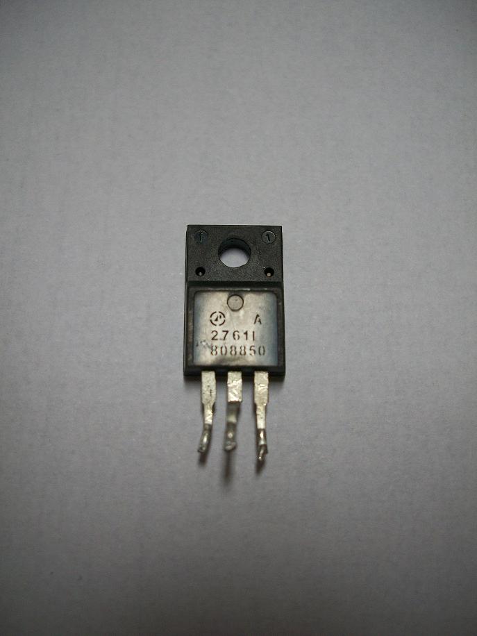

                                • jselvatici
                                  • May 2010
                                  • 25
                                  #56
                                  Re: emachines e19t6w inverter powersupply help
                                  This is the FET that I changed because it was all shorted.

                                    -> I dont know if I can trust on reading because part of it came off, so it reads 1k5ohms. Picture available
                                    Yes, that resistor looks dodgy. I would probably replace it.
                                    3) Retest NCP 1337 for short.
                                    -> testing the NCP1337, using Pin 4 as a reference I got to Pin1= open Pin2= open Pin3= 2kohms Pin5= 2ohms Pin6= 205ohms Pin8= open
                                    Sorry, I made a mistake here. I don't see anyway to properly test this PWM. I'm helping 5 or 6 people at once and I got confused with another thread. Too much sun yesterday!
                                    Let's assume the PWM is okay for now.
                                    The good thing about your board is that there are very few components on the top side. If you can test every component in that section, it shouldn't take more than 10 or 15 minutes to measure the diodes, resistors, and FETs.
                                    One other thing to do is to "backtrace" the two 5V rails to see what the path looks like. That way, you know what to measure for secondary voltages.
                                      Sorry, I forgot to write this yesterday.
                                      If you haven't replaced this cap, please do so with a low ESR one like Panasonic FM or Rubycon MCZ series.
                                      This cap might be used to help the SMPS power supply start up to provide 5V DC.

                                          I have to wait to buy one like that.
                                          IF the parts are inexpensive, maybe get 2 fuses? At some point, this board may be unrepairable if it was damaged by the storm (power surge?). There may be PCB or internal board damage that is not fixable.
                                          PS. Don't forget about the 47uF cap.
