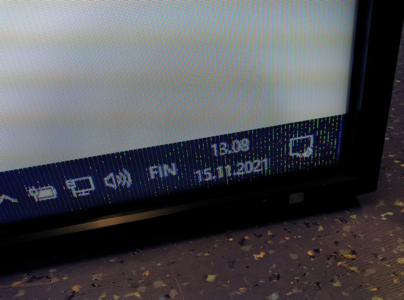

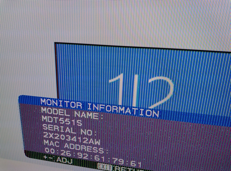

Mitsubishi MDT551s professional display picture fault
  • Xenon-Codex
    • 186
    • Finland
    What could cause this vertical striping, is there similar t-con board like in the cheap TV's? We only changed some cables while it was no on.
    Mitsubishi MDT551s.
  • Xenon-Codex
    • 186
    • Finland
    Re: Mitsubishi MDT551s professional display picture fault
    It got fixed when I took it apart, and twinkled the cables going to the T-con, which is an LG 6870C-315D. Looks like normal tv-part.
