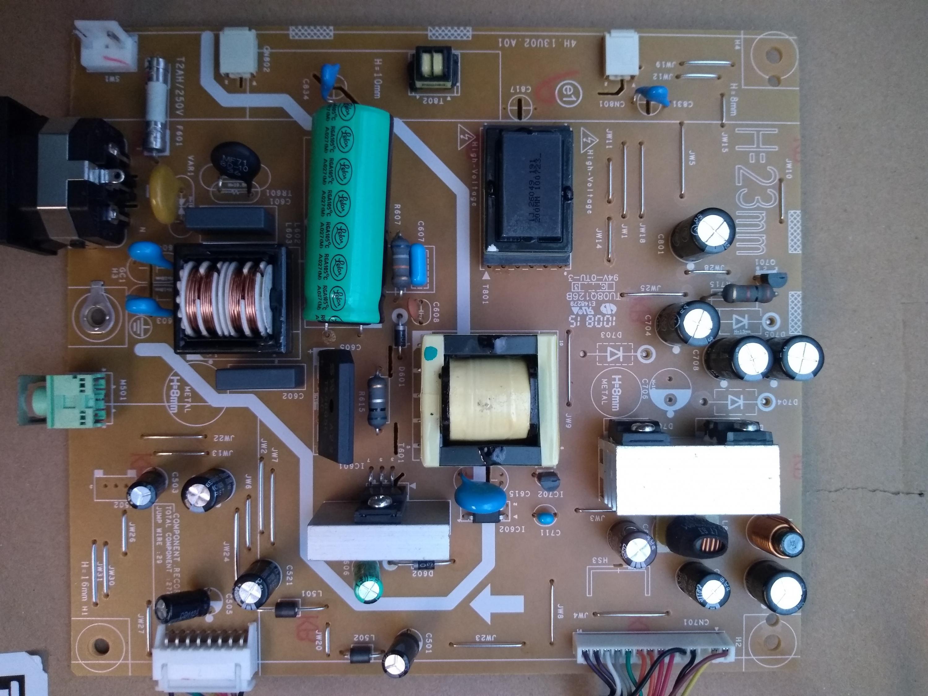

    I just broke the factory seal on a Dell (Philips) monitor that was manufactured in July of 2010.
    I decided to check the power supply board (see image) before I even powered up the monitor for the first time.
    The following is a list of the electrolytic capacitors. Are any of these more urgent than the others to replace?

    I did later power up the monitor, and it does work fine. The best parts are the two nichicon parts (C707, C708) on the secondary. Even though they are all unused, they are all 11 years old.
    This power supply board is not very commonly available on the used market, so I'd like to protect it from the old capacitors causing the failure of other components. Should all of caps be replaced?

    I think yes to be in safe side. In a 11 years old capacitor the electrolyt could harm the body it self. The cost of set of new capacitors including big one ( i guess 120uF 450V) are nothing compare to the value of "new" monitor. Did you visually checked the capacitors on video board too?

      I would probably do a complete recap myself only because if the quality of the capacitor are in question and because it sat in storage for so long and you probably do not know what conditions the place where the storage took place

        dont spend a penny on ANY monitor until you get it to display an image.
        panels fail a lot and you wont know till you try it if the bonded cables have failed and put lines on the screen!!!
        specially on 2010 ish DELL crap - i have about 8 of them that work and have binned atleast 4 with bad panels.
        incase your wondering, i dont buy monitors - i recover ones that companies throw out during upgrades.
        i would never risk spending even the cost of a beer on a dell monitor!

          yeah... i wouldn't spend a cent on a dell either, unless i have something kicking around in my parts bin. just run it like that until it dies.
