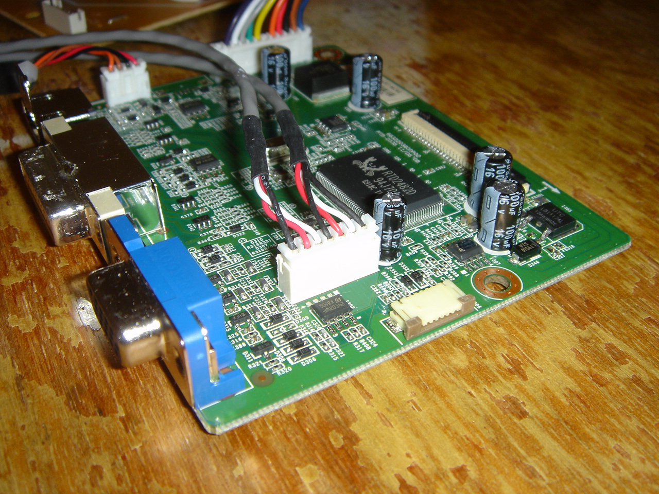

    I recently open my Acer 23" monitor and noticed that that have about 5 Su'scon caps which are on the list of bad caps. What kind of replacement caps should I get for video cards? I've read from another post that polymer caps works well with video cards so I did a search on digikey and found: Will this work?
    http://search.digikey.com/scripts/Dk...D The caps are
    4x: 100UF 16V Dimension: 6mm Diameter by 11mm Height
    1x: 10UF 16V Dimension: 4mm Diameter by 11mm Height
    Please help me find high quality replacements. Any help would be appreciated thanks.

    Just a minor comment on nomenclature... video cards are what you put into your computer to provide the data signal out to the monitor. The photo you've provided is a picture of the logic board (some call it the mainboard) of the monitor itself.
    Are you having a specific problem with your monitor, or are you trying to pre-emptively avoid issues? While polymers will work, they will be more expensive than electrolytics and I don't think they are a direct rating replacement. Hopefully the resident experts can expound on this further.
    Have you also checked the power and inverter pcbs for caps to replace, or does this monitor run with an external power supply (in which case, you should check the power brick)?

      Yes this is the logic board off my Acer 23" LCD. I am pre-emptively trying to replace these caps on this board to avoid further issues along the road. As most of the caps on my power supply blew out and are being replaced with Panasonic FM. I have never dealt with logic board before therefore I need help on caps that would work with logic boards. Sorry didn't know imgavenue wasn't allowed, but I clearly selected that it wasn't adult content so I'm unsure why the pop up occurred on your computer.I apologize for that.
        These will work fine:
        https://www.badcaps.net/store/produc...roducts_id=101
        and
        https://www.badcaps.net/store/produc...roducts_id=102

              So as long as the caps are low ESR they should work? So if I use Panasonic FM or FC, they should be fine? I thought Panasonic FM & FC are only good for power supply.I uploaded image using the built in hosting of this site. Sorry the "manage attachment" button just slipped my from eyes...
