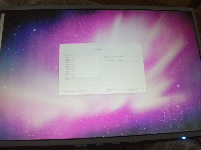

            OK, I'm back with a new problem. My sceptre originally was a 2 seconds to black and finally found I had a bad ccfl - Anyway, I put it all back together and fired it up and... worked except the colors on the screen were all washed out. There is no color saturation, looks like the brightness was pushed up 200% and the type on the screen is out of focus and hard to read. Hard to take a picture showing it because it looks like I was using a flash. I was sick of this monitor and put it in the basement. I decided to fix this or throw it out.
            Thing is I have been all over this monitor, the power/logic bd and I replaced the ccfl. My worry is that it has something to do with the one leg on the ic I pulled up and then re-soldered. I re-seated the cable connections hoping it could just be one pin not connecting...
            so, again I am here asking for any help or direction
            I put some screen test colors on the monitor and it appears to me that the problem is with the black, which is grey. The other colors Cyan, Magenta and Yellow are bright and vivid

              #66
              Re: Sceptre X22WG-1080p monitor not staying backlit, Please Help!
              For anyone trying to help me, the pin I'm worried about is the #16 pin from the BIT3193 it is the MODSEL output "to set the output polarity of the low frequency PWM controller" does anyone think this could be my problem?
                That solder pad for 16 looks nonexistent.
                Trace pin 16 and solder pad to the next component and see if it's getting continuity if not you will have bridge it.

                  #68
                  Yes, I wanted do that today, I have to find a good magnifier and see where the trace goes. It's been a while but I must have checked it when I re-soldered it... I will post when I am able to test it.
                  OK, checked the pin and it has continuity to, looks like J1 next to it. Phisicaly it looks good but I'm not sure if I could have damaged it when I unsoldered it and then soldered it back down - I know some components are more sensitive to heat than others.
                    try soldering it again perhaps you got a cold joint.
