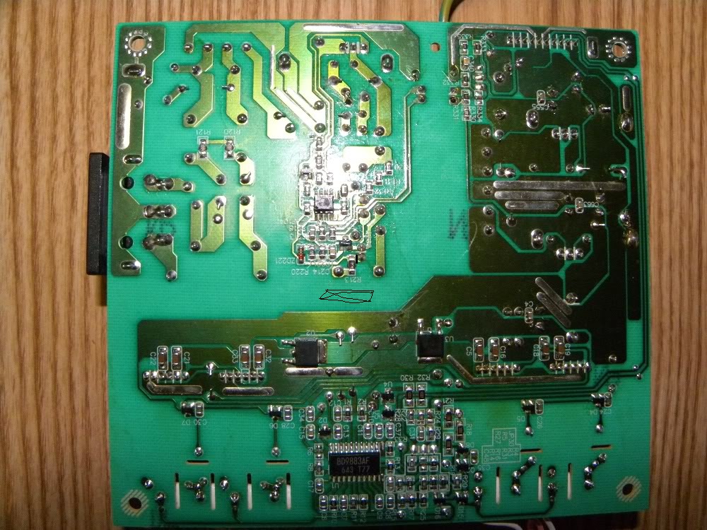

    • SupeR
      • Mar 2010
      • 5

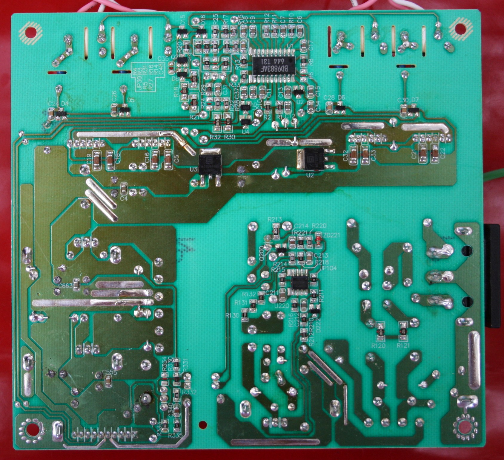

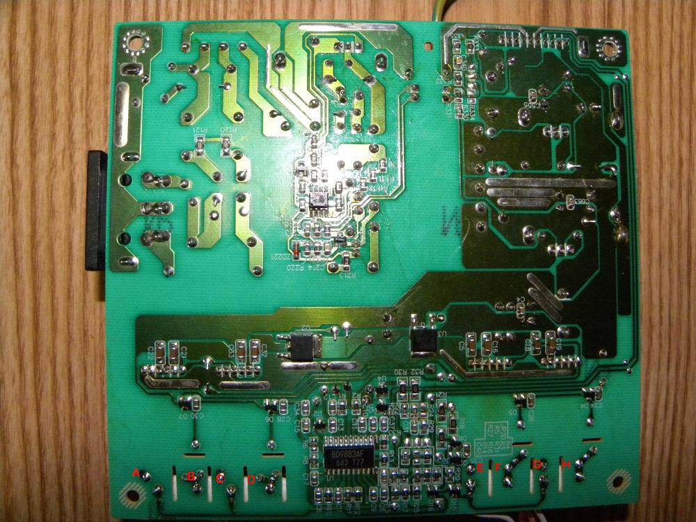

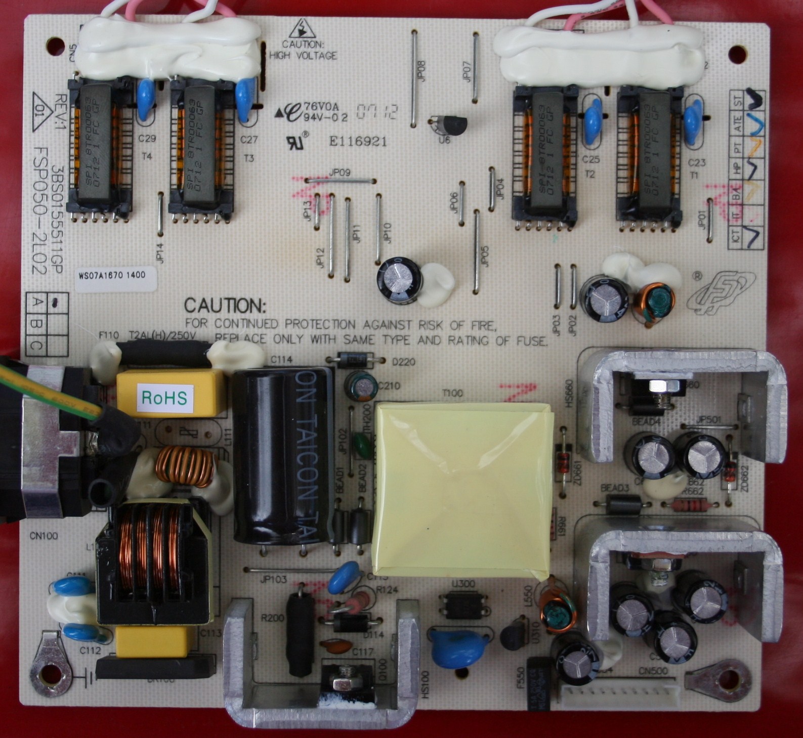

      Re: Sceptre X22WG-1080p monitor not staying backlit, Please Help!
      Bottom of Inverter board
      [/IMG]
      Top
      [/IMG]
        Should I replace the big Taicon cap and the small green one next to it?
          Neither is the cause of the problem you are having. I would recommend replacing the small electrolytic cap if you get this working. That cap performs a very important function and if it fails your monitor won't work.
          I've marked up the picture of the bottom. Measure the resistance from point A to B; C to D; E to F; and G to H.
          The large IC on the bottom appears to be a BD9883AF; please verify that.
          If all transformers read the same I will ne a better picture of the bottom; especially the traces below the transformers.
          PlainBill
            Ah shoot, I don't believe i have anything to measure that with...
