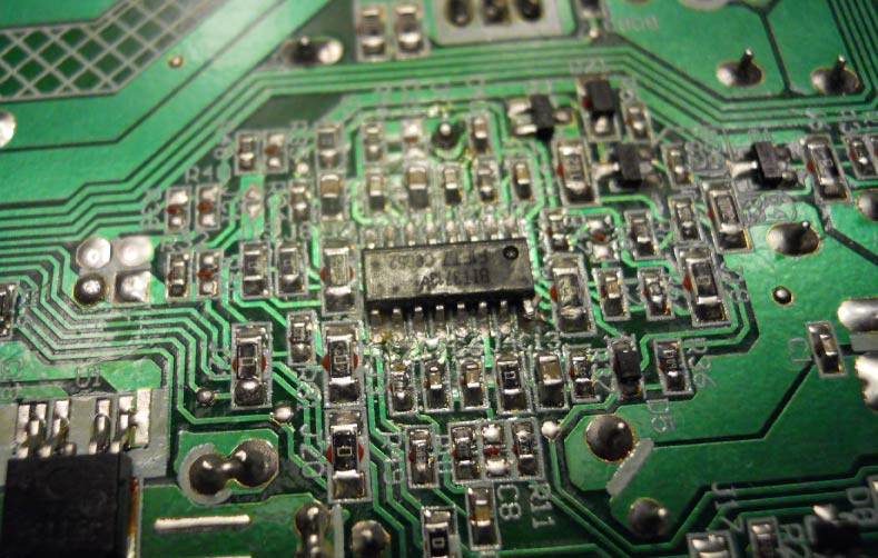

    that was tough, those pins are so small- got a new reading
    10-16 = 59.06
    Does this mean something else is causing the short and the IC is good? Should I re-solder the pin?

          None of those readings suggest the BIT 3717 is shorted. BIT 3717 could still be bad in other ways though. If you rub the chip, does it feel bubbled up?
          Can we a slightly zoomed out picture (like the one in post #32) with resolution as close to 2000x2000?
          Hold off on resoldering the pin back in.

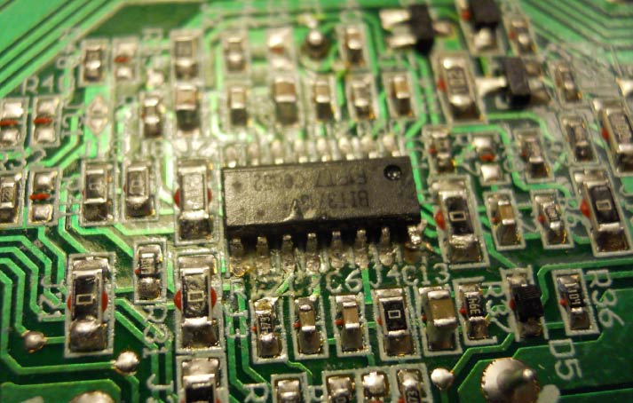

              #46
              Re: Sceptre X22WG-1080p monitor not staying backlit, Please Help!
              That's odd, I also missed that post, I didn't re-test but I can when I fix the 16 pin. Here are some more pics. I didn't notice it until I was really looking close. Yes, 2 sec to black with each connector except for the third one, which gave me one sec at full, 1second at half brightness and then off. Also the CCFL I used was from a used 15" LCD, but measures 12.5"

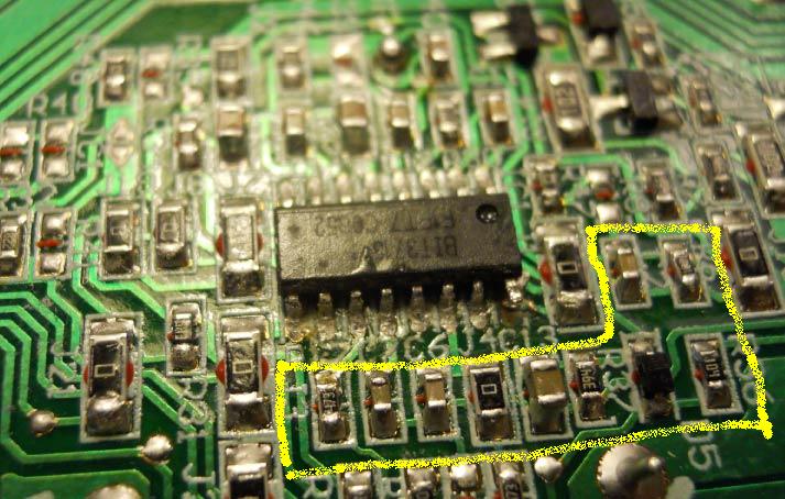

                Okay, resolder pin 16.
                With power off and lcd unplugged, test each one of the components in the yellow box.
                R components should be tested with ohms measurement. The multimeter should give you a reading close to the markings.
                C components should be tested with capacitance. If you don't have a capacitance function, use ohms. Any reading under 30 ohms suggests the capacitor might be shorted.
                D components should be tested with the diode test function. Put your red probe on one side and black on the other. Record measurment. Reverse probes and repeat.
                After these measurements, you can try alexanna's suggestions.

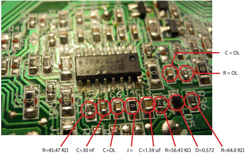

                  #48
                  I couldn't get a reading on two caps and a resistor, I've tested over and over, switched leads and same results. I can't believe three component went bad at once? Also didn't know what to do with the J- Jack connector.
                  Note this pic I drew on is the old one with the pin not attached.
                    J is jumper. That is why it says 0 for 0 ohms.
