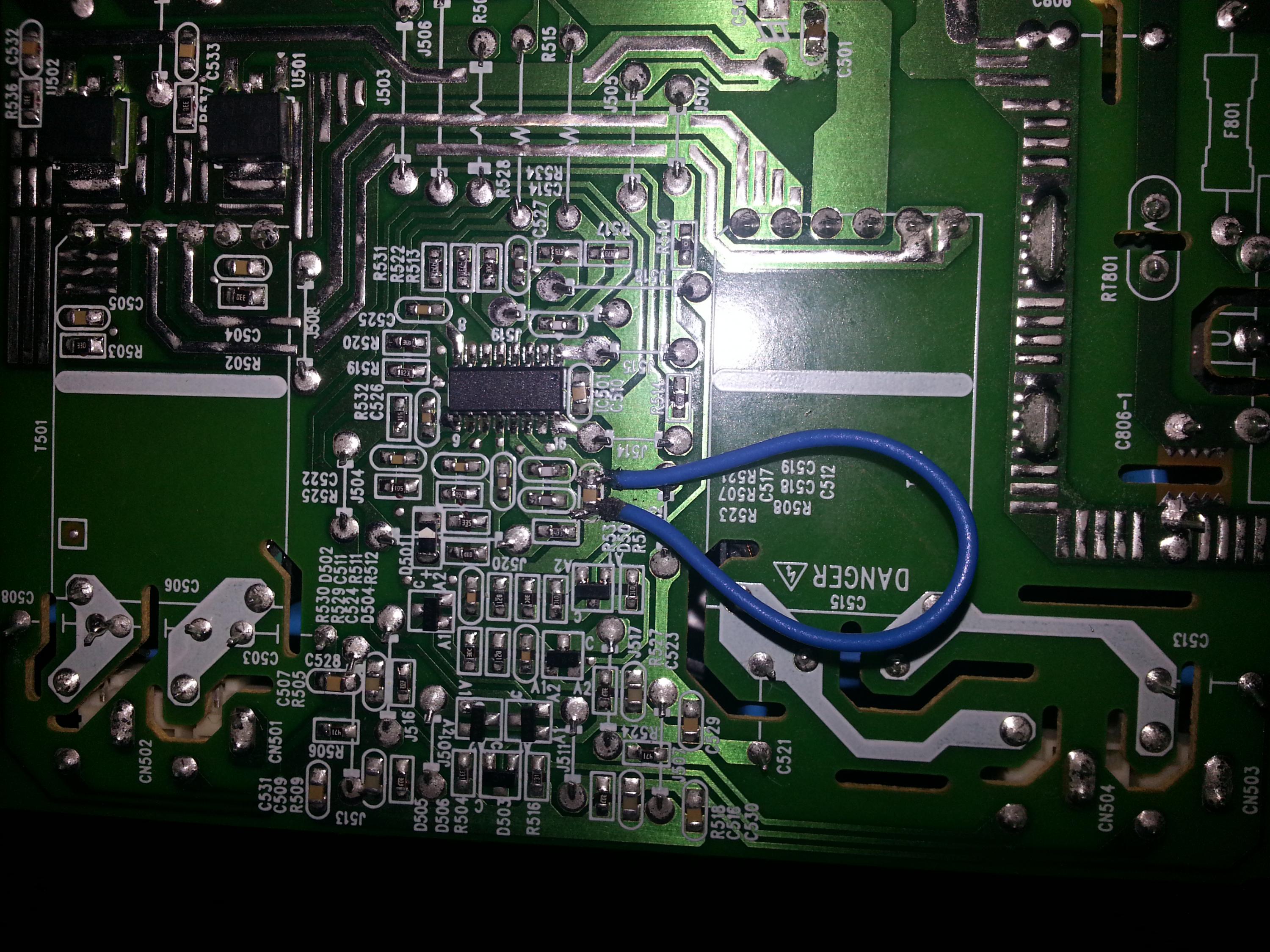

    Well I prefer don't do that that is not a a permanent fix.
    • selldoor
      Slow Learner
      • Dec 2010
      • 7870
      #82
      Re: 2 dead monitors, blueh h94w and amw x1700ds
      OK - how about soldering a jumper in place just to see if it works?
      That would help in deciding what is working and what is not.
      Whatever happens if you use a wire jumper it could easily be removed.

              #86
              Just noticed on your jumper picture just above the jumper there are 2 zero rated resistors
              R514 and R510 - can you test those as if they were a fuse. (no Power to board)

                #87
                I have 0.003 with the multimeter on 200ohm on the two resistor.

                              #94
                              stj - he is French so whilst English is good he doesnt always follow unless it is spelled out.
                              He has two inverters mentioned - the one in the set and the "test" one which he has used to verify that each bulb will stay on for 5 minutes - so I reckon that proves they are ok.
                              The set inverter is on the power supply and pictures are in earlier post (transferred from
                              his offsite)
                              https://www.badcaps.net/forum/showpo...1&postcount=43
                              Hope you can spot something I am out of ideas.

                                  Take your point - we did try shorting out the timer on the driverIC to give the lamps longer to come on but it didnt work
                                  Test inverter has only one connector - when he uses it he can see a picture.
                                  so he could get a cheap 4 connector inverter and wire that in somehow.
