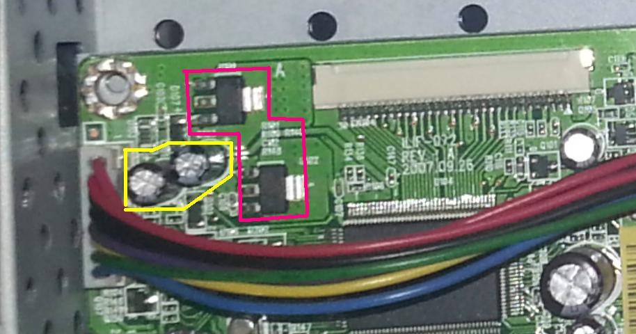

              Ok - Put it all back together and set your meter on 20vdc and switch the set on.
              First put the black on a ground screw and with the red probe test the voltage at each side of the 4A yellow fuse.
              Next switch it off (You may need help with this) you have to put black probe to ground and with the red probe test on the on/off pin WHILE you turn the monitor on and for about 10 seconds after or until the light flash on then off again.
              On the back of the power supply is a 16leg IC IC 501 what is the part number on it
              And another test - a difficult one as you will be in high voltage area.
              Dont let the probes slip or touch anything else.
              There are two small caps top left corner of the power supply board .
              Find where they are on the underside and test the voltage (meter on vdc200)
              as you switch the set on.

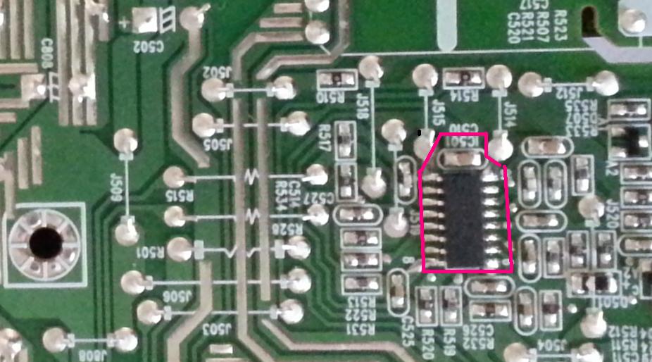

                "On the back of the power supply is a 16leg IC IC 501 what is the part number on it" can you be more specific? I can't find this component.
                • selldoor
                  Slow Learner
                  • Dec 2010
                  • 7870
                  #68
                  Re: 2 dead monitors, blueh h94w and amw x1700ds
                  "I have 140 for the D805-1 and 2 and 97 for D807-1 and 2"
                  and with the leads reversed?
                  3.2volts on the fuse? - I will look into that.
                  Those voltages seem a bit low What are the ratings on the caps.
                  "On the back of the power supply is a 16leg IC IC 501 what is the part number on it" can you be more specific? "
                  Cant be more specific than that !! IC501 is the board designator and there is ONLY one 16 legged IC ??
                  i Clue - its on this picture http://img11.hostingpics.net/pics/15...0716195947.jpg
                  Just above the two mosfets.

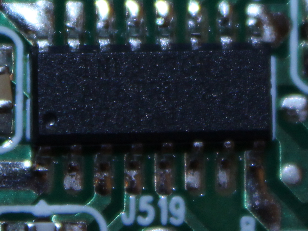

                          • flosers
                            • Jun 2014
                            • 63
                            • France
                            #73
                            Ah ok sorry
                            To be more specific the fuse have in output and output 4,78V
                            INN837GN
                            76PNHYZT
                            075IAI
                            I'm not sure of what Is write on this component because it's write verry little.

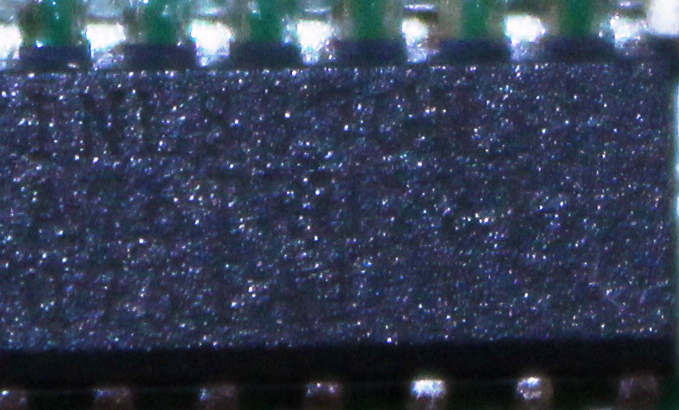

                              #74
                              I read INL88 on the component thats all. If someone have better eyes X)

                                #75
                                Try wiping it with IPA - isopropanol alcohol. may bring the letters up

                                      #78
                                      I take it you mean worse now- I am still working on it but am out a lot today.
                                      I am on a laptop will try on a big screen.
                                      Now think its is I or 1 NL 83
                                      Posted as a bitmap to keep the quality for now

                                          #80
                                          Easy to see when you know eh? INL837GN
