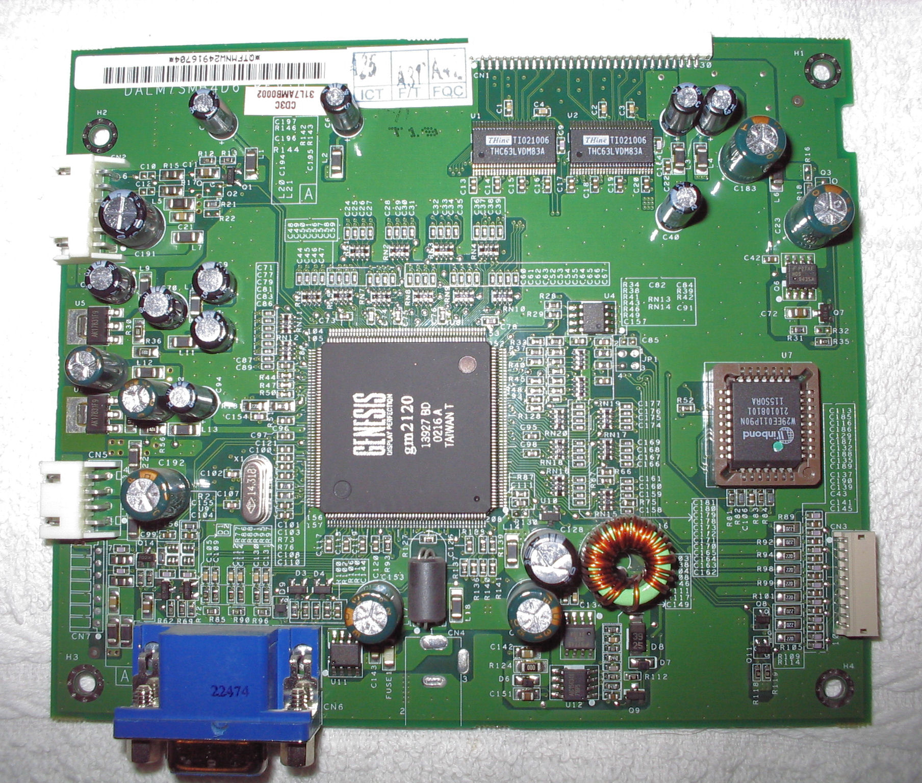

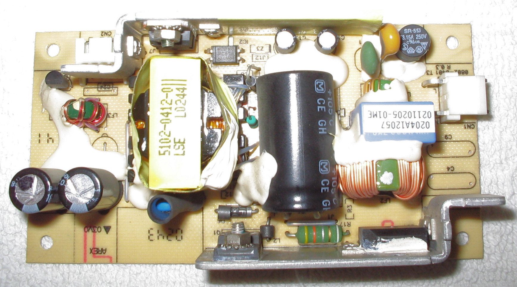

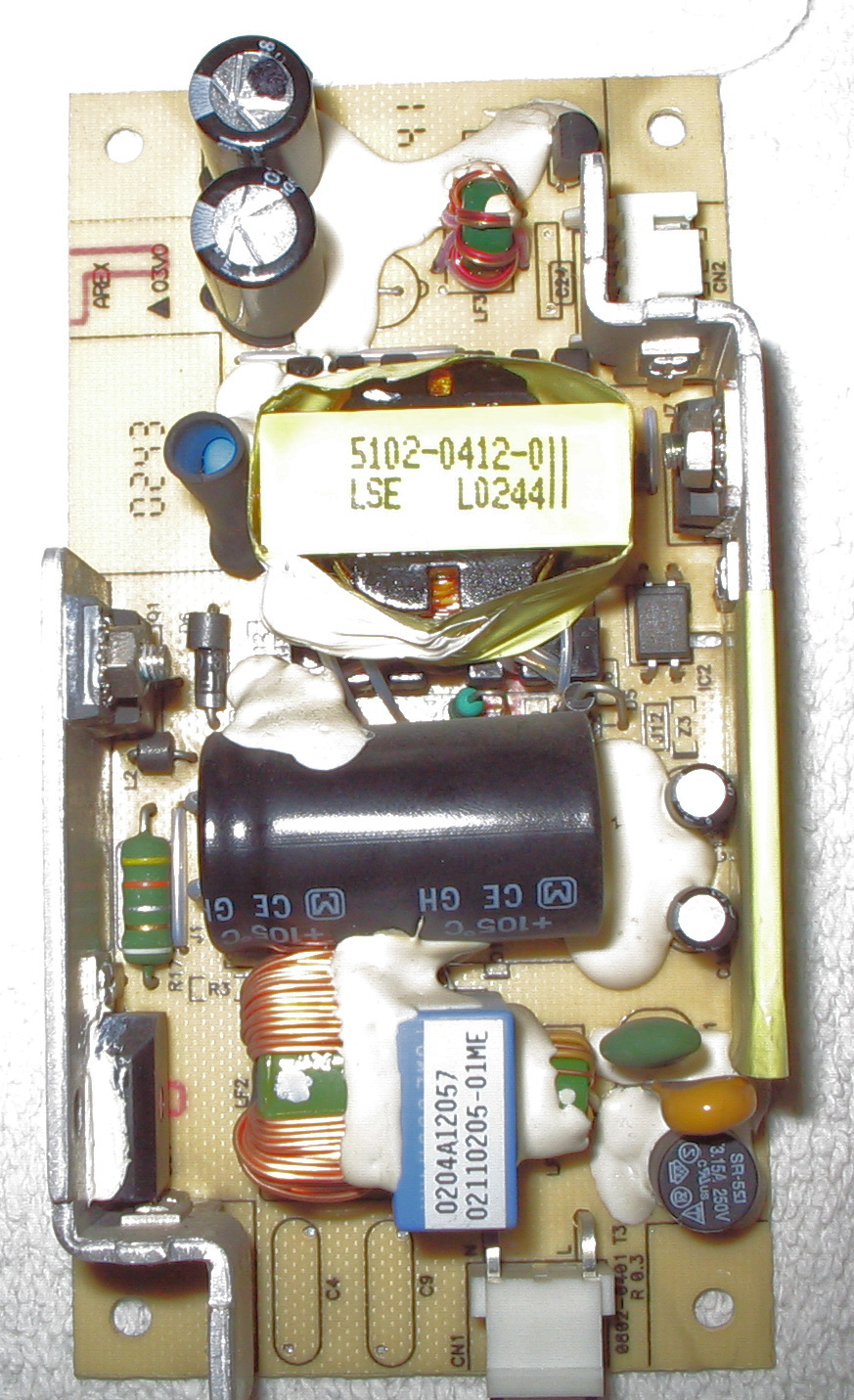

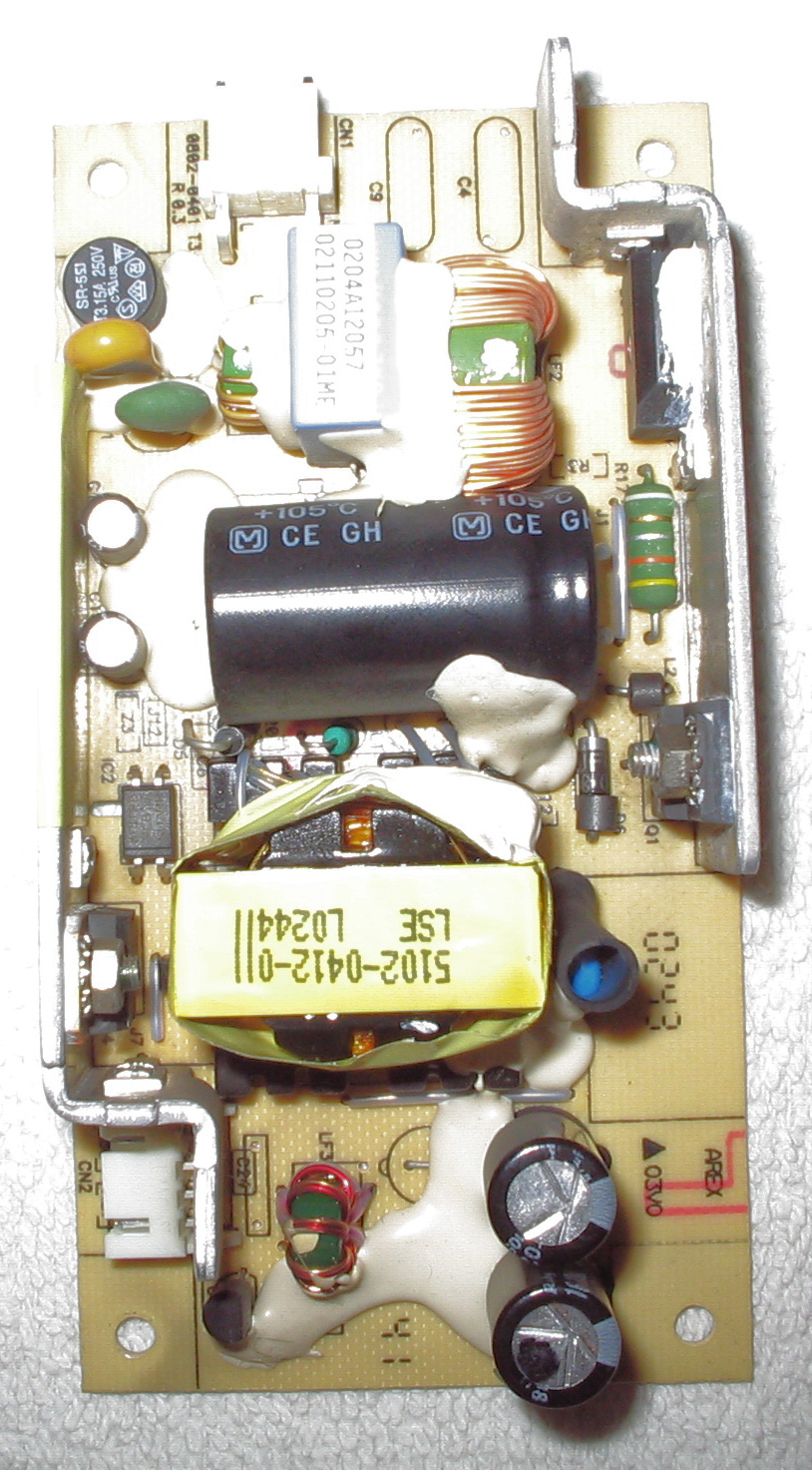

            Okay. Bear with me I have a horrible camera and horrible lighting. I'm calling PB the Power Board and it has 4 Rubycon YXG's. LB will be the Logic Board and it's all Teapos and 1 Rubycon YXG. IB is the Inverter Board and it has 2 Sanyo's.

              Pictures are good enough. I've seen a lot worse.
              First step: Measure the voltage at CN2. Judging by the connector on the logic board, this is a single output supply. I don't see any indication of the rated output voltage, but would expect 12 -18 volts. Of course, you can keep fiddling with it until the monitor does start up. If there is no output voltage initially, replace the two small electrolytic caps at the end of the very large cap.
              Next step: If there is output voltage, on the logic board there are two voltage regulators between CN2 and CN5. One of them is U5. What are the voltage on all three pins of those regulators?

                Re: Gateway fpd1730 Problem
                  Originally posted by pdog_phatpat
                  I have 12 volts coming out of the power board. The regulators are U5 and U6. So, looking at the picture with the vga connector at the bottom, from top to bottom pin: U5: 5.05, 3.33, 2.08. U6: 5.05, 2.49, 1.24-1.25.
                  So I would assume that U12 and the FET driectly above it step the 12 volts down to 5.0. I'm not sure if there is a 1.25 volt supply on this board.
                  Were these readings taken with the monitor hooked together? If so, was it working?
                  I'm about of ideas. The only thing else I can suggest is recapping the logic board and the power supply. It may be a long shot.

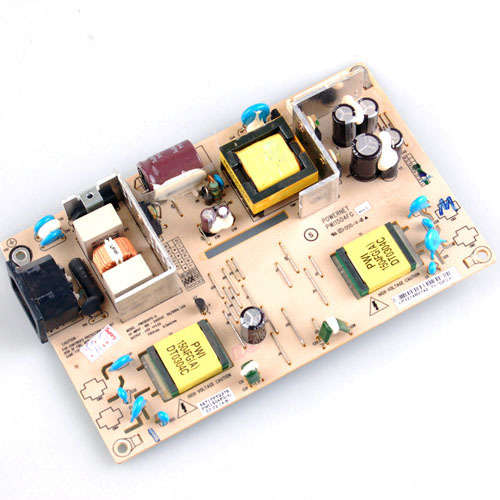

                          I own a Gateway FPD 1730 with the power board being a Powernet PWI1504FG. I replaced all the capacitors with the exception of the 0243. I got my hands on another similar board. I replaced the 2 capacitors on the video board (this monitor has only 2 boards), to no effect.
                          Any suggestions are welcomed.
                              Here is the copy of the board in question.
