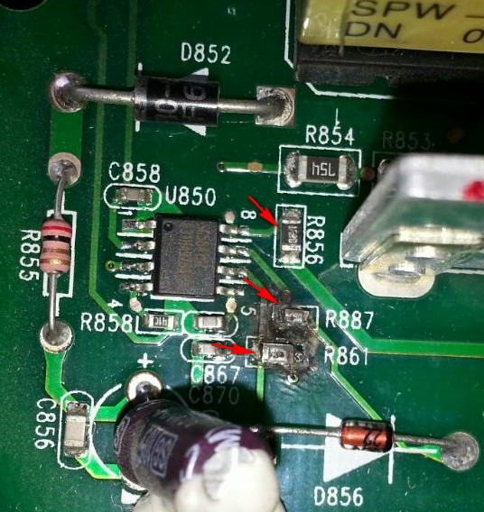

    Originally posted by Rtech View Post
    R856 is 15Ω R861 is 470Ω...cannot find the other resistor, check the number...also I am away on holiday today,so hopefully someone will help with other values if necessary.
    thanks for the reply,
    Here a pic of a burnt parts... the number hmmm
    btw.. Thanks a lot for the help.

        Originally posted by smason View Post
        Hi all, this will be my first attempt at repairing an LCD monitor. I haven't done much repair work in a long time, so I'm dusting off my gear and hoping for the best... Monitor is a Dell E196FPf no backlight. Image is visible on the monitor with a flashlight so I suspect just the inverter, or maybe a bad lamp, though none of the 4 come on at all, even at power up... 2 caps in the inverter section are bulged and have relatively high ESR (2 ohms) other than that no obvious visible signs.
        I have a similar situation to smason in the OP quoted above. I have 3 E196FPf monitors and all show the same symptom - the power indicator shows green and stays green - no blinking and no amber. After a quick web search that turned up this thread, I decided to disassemble one - sure enough, it has 2 bulging caps in the inverter section shown in smason's close-up pics.
        We've done a bit of minor cap repair to some older model car dashboards, but nothing really like a computer board. Before I dive in, any pointers - things to do, not do, watch out for, buy, etc.?
        Thanks in advance for any help.
