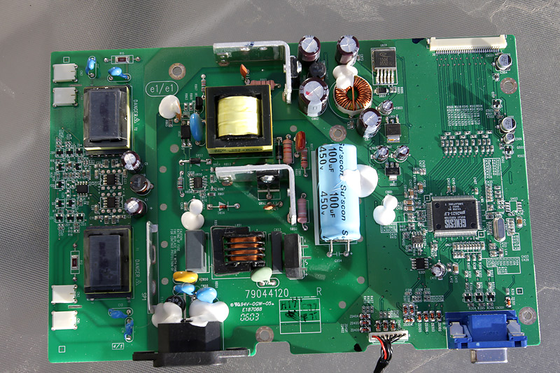

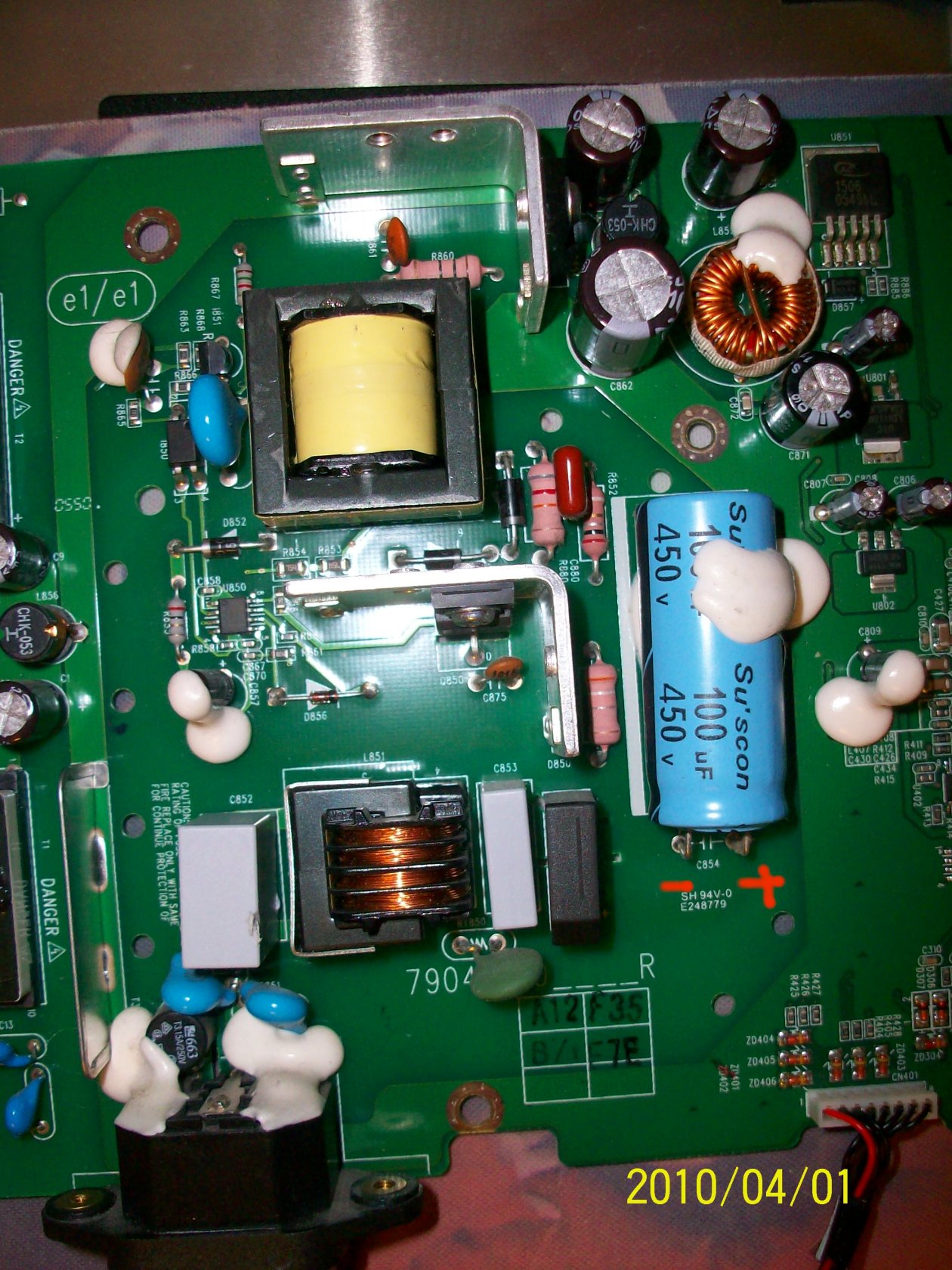

    Hi all, this will be my first attempt at repairing an LCD monitor.
    I haven't done much repair work in a long time, so I'm dusting off my gear and hoping for the best.
    Equipment available:
    My old trusty Fluke 77 DMM, Capacitor Wizard ESR meter, Hitachi scope, and a Blue ring tester is on it's way soon.

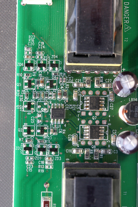

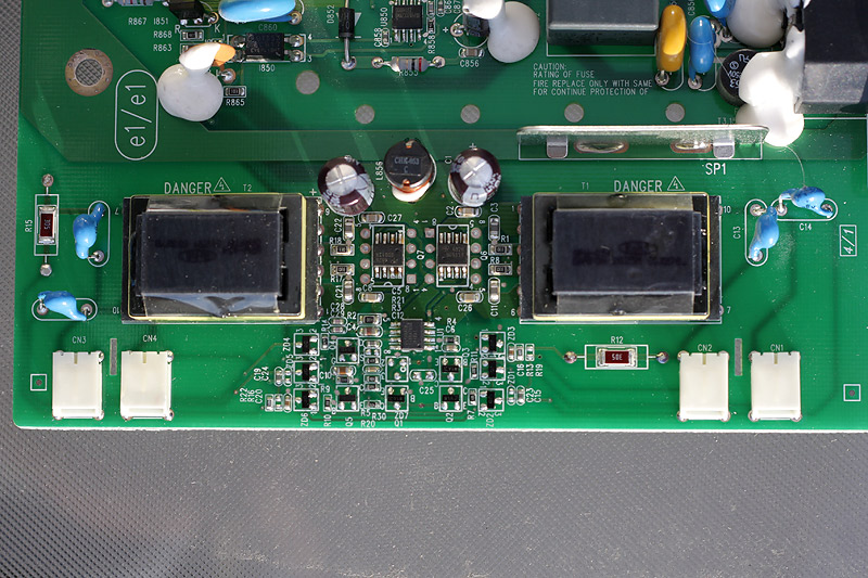

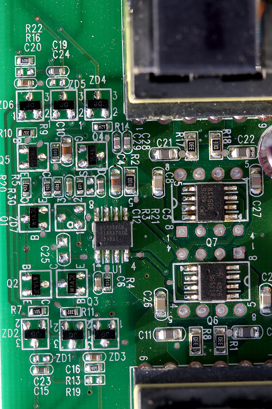

    Monitor is a Dell E196FPf no backlight. Image is visible on the monitor with a flashlight so I suspect just the inverter, or maybe a bad lamp, though none of the 4 come on at all, even at power up.
    2 caps in the inverter section are bulged and have relatively high ESR (2 ohms) other than that no obvious visible signs. Solder joints on the transformers look ok, I'll re-do them though.
    I don't see anything that looks like a fuse so far. While I wait for caps, I'll look up some part numbers and test some of the transistors if I can.
    Photos are full board, and closeups of the inverter section.
    Has anyone worked on this model before?

    I believe someone has posted pictures of this (or a similar) combination power supply / inverter / logic board. Or at least something similar to it. A couple of points to check:
    U1 in the inverter section - I believe that is the inverter controller. Look for the datasheet.
    There should be two signal traces from the logic board portion over to the inverter portion.
    Larger pictures of both front and back of the circuit board would help.

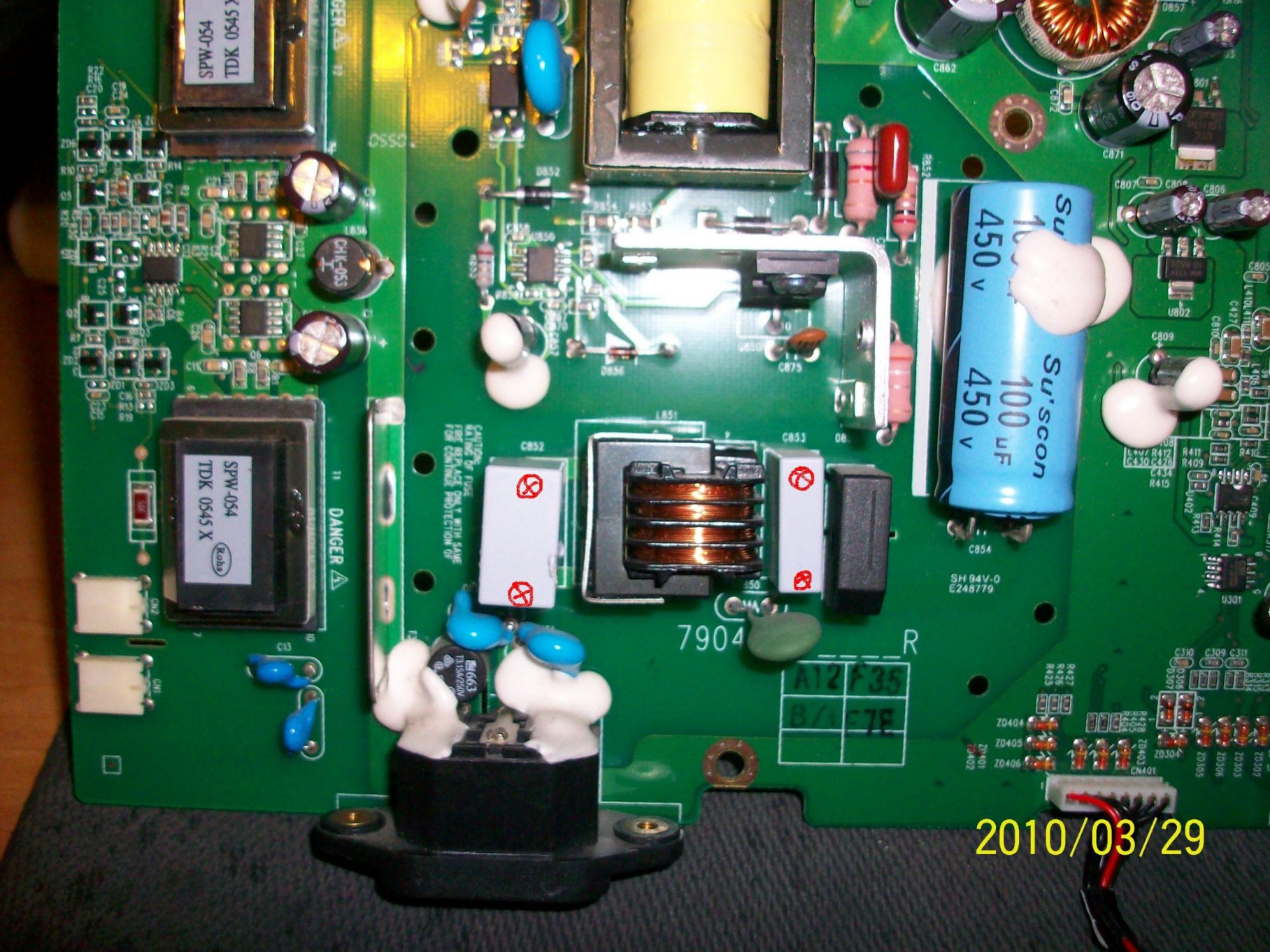

                        Re: Dell E196FPf
                        It does not show any signs of power. I did try an ohm meter on both fuse blocks and did not get any continuity. Is this an accurate test on these types of fuses?

                            Re: Dell E196FPf
                            I was testing the two white boxes with an ohm meter. I marked them with red circles with an "X" where the pins are on the back side of the board. I thought these were the fuses.

                                Re: Dell E196FPf
                                I don't think those are fuses, they're labelled as caps.
                                The fuse appears to be the round black component that has the amp and voltage rating on it.
