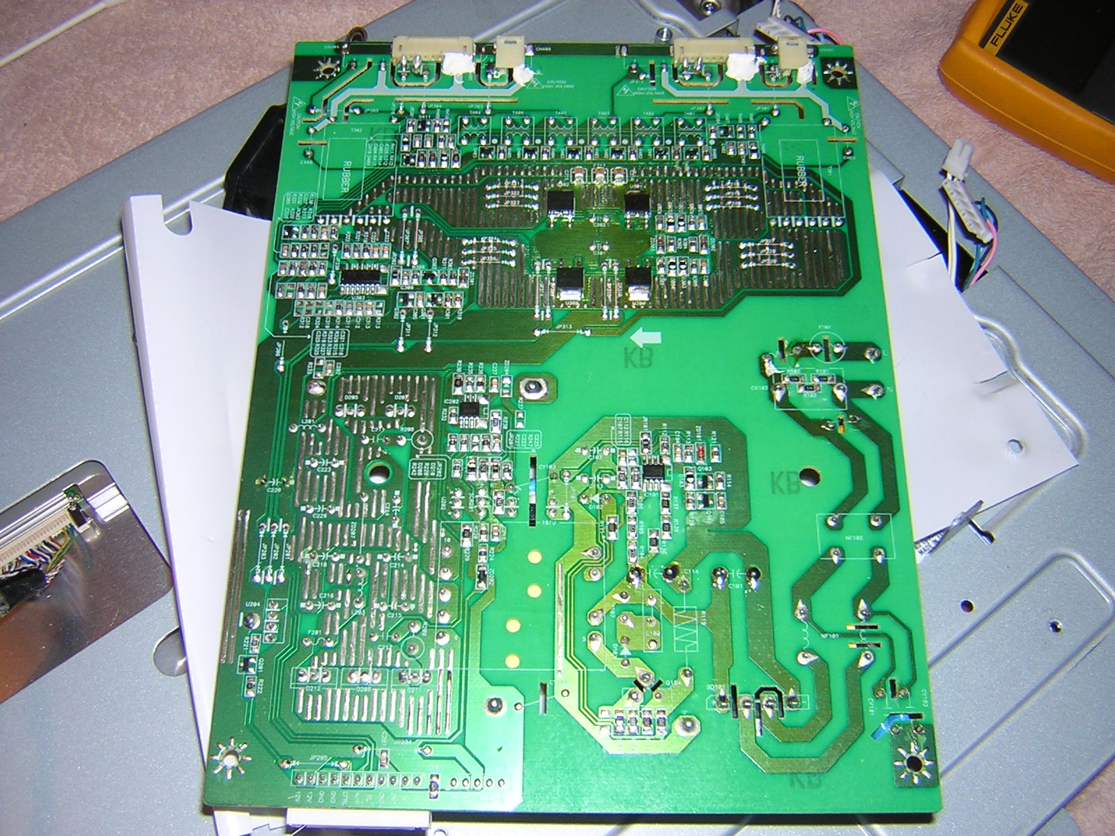

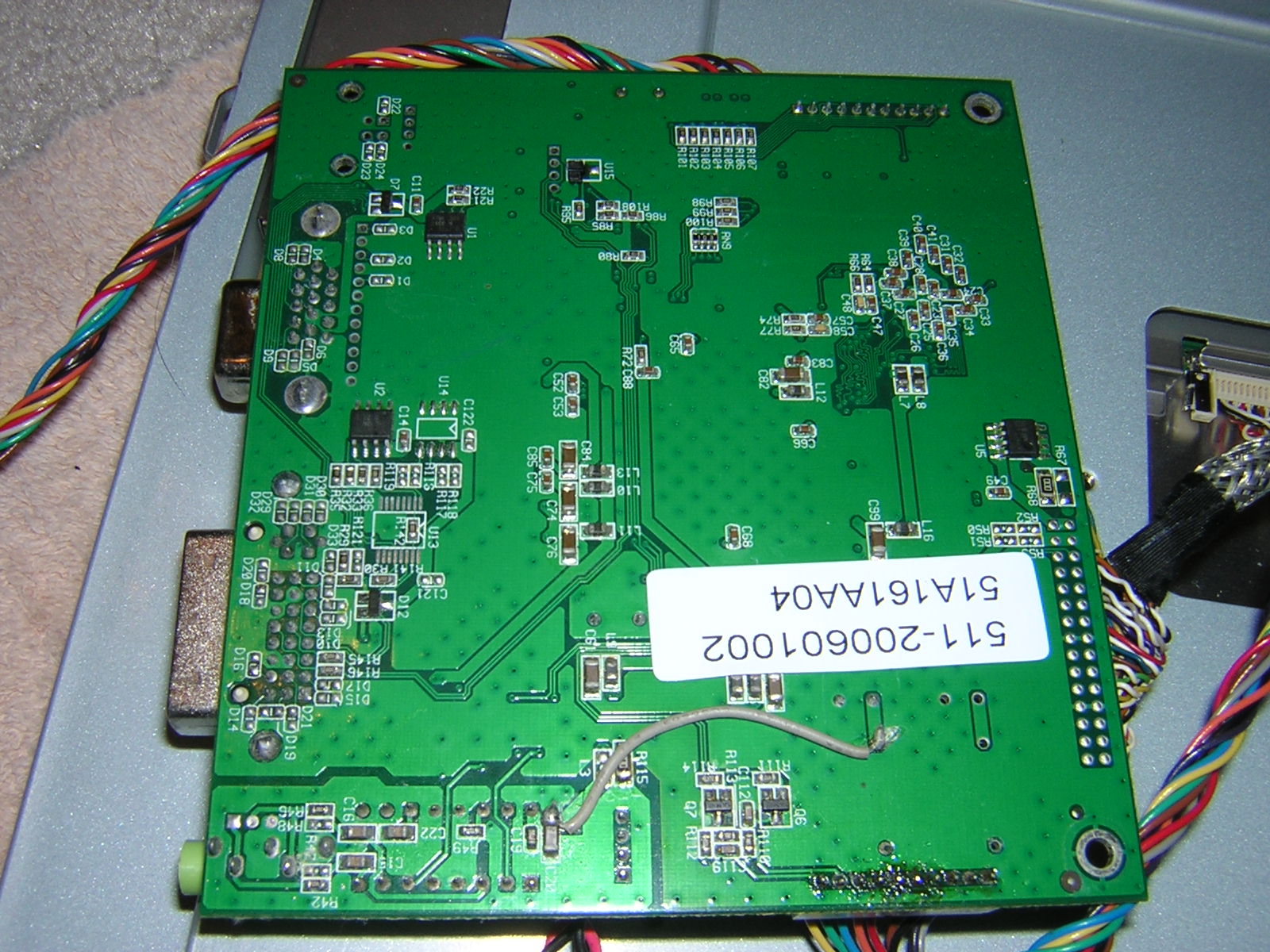

    Forgot in the previous message to post pictures of the back of the boards as well.
    So these pics which i am enclosing are for the "backs" of the boards.

      here are pics.......of back of boards

        Did you put that wire in or has someone been there before? Are the wires with dark flux around them the ones you de-soldered to test the bulbs?

          Are you talking about the grey wire on the back of the video board? If so i did not put this there.........and i dont know if someone has been there before me.

            Engineering error fix for batch of PCBs. Next batch of PCB get revised.

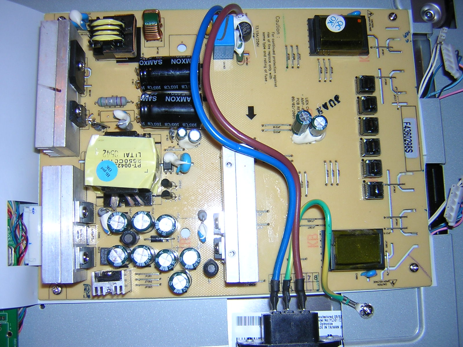

                  This looks close to the same power supply used in Gateway FPD2185W screens. Is it a Samsung LCD? I heard that most of the gateway screens died in under 3 years of use... mostly due to bad caps. I would try replacing all but the two large caps as a start. I also noticed that they sell inverter transistor kits for the FPD2185W. There are 4 of them on the under side of the board. On the gateway I think its U301, U302, U304, and U305.

                      Did you have any luck with this one? This is the same power supply as the FPD2185W. If you are changing U301, U302, U304, and U305 the numbers on them are qty 2 each of AOD405 (replaced by AOD417) and AOD408 (replaced by AOD484). I know that Digikey carries them but I didn't check inventory.
                      There shouldn't be any issue with those big caps but it looks like something may be going on at F101 which is your primary fuse. Check the resistance to see if it is open. I would also suggest re-flowing the solder joints of the large transformers while you are in there.
