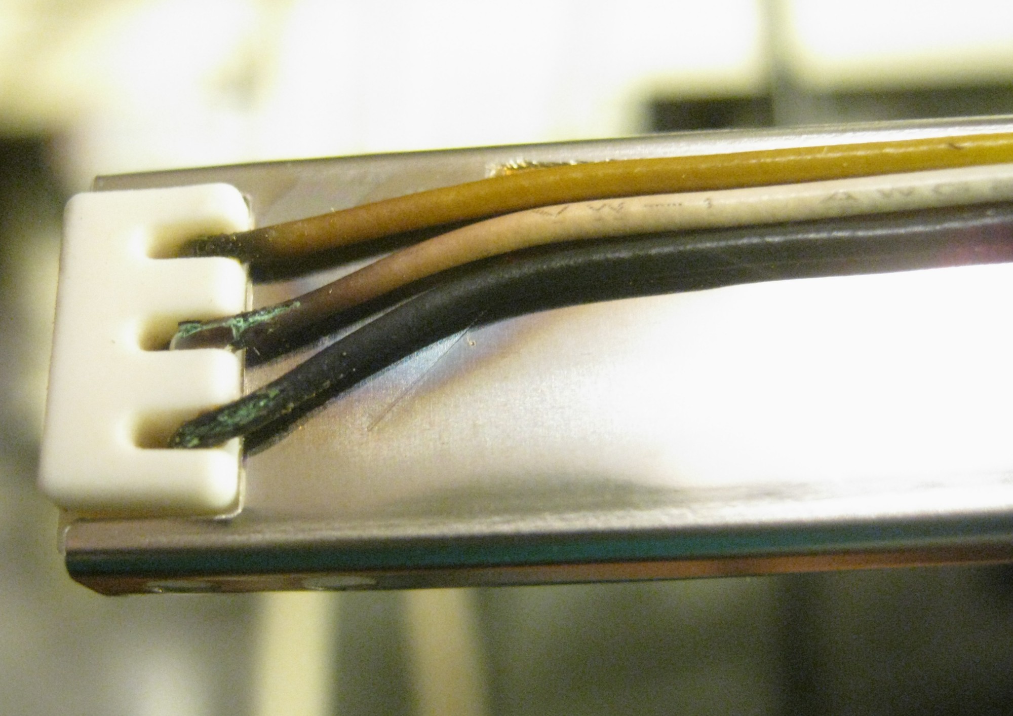

Loosened wires from the plastic holder and could take the reflector piece with the three tubes out. First one looked maybe a little brown there on the thin return (so called cold) wires, I tried nudging the silicon holder, seemed to be glued...
Got the three tubes off the reflector by pushing some wire in through the first white silicon rubber holder so I'd get some slack on the three thin return wires which also had to be loosened from the tape and then I thought I was going to shorten the wire a bit and resolder all three of them - just to be sure. That's when I noticed this on the other tybe/reflector assembly in the image...
Isolation gone in the bend of two wires, blueish mark on the reflector metal, seems I have had some arcs here...
So I just cut all three wires, one of them broke loose as soon as I touched it. I cut maybe 10mm, removed the white silicon rubber from the tubes - which is apparently impossible to do in one piece. No worries though I'll sort it out...
Cleaned the leftover wires from the metal pins of the tubes, they were originally twisted around the pin and formed a nice little circle. I just soldered all three wires straight on, covered it with silicon and stuffed the cap back on. I guess I'll have to wait until tomorrow to try it out.
I did notice some small cracks in the insulation of some of the return wires, at the bends, where they had been mounted in the white plastic holder on the back of the panel. So in retrospect, replacing those six wires is not a bad idea. Don't know if they cracked first and then started arcing or because of something else but it seems to be crappy wire, wonder why they didn't use silicon insulated wire like the thicker one? More expensive maybe?
Some cable with teflon insulation maybe that can take the heat and a little thicker (gauge) cable, as much as can fit. I only had 0.08 sqrmm wire with PVC insulation, it seemed a little thinner than the original and I'm not sure PVC is good in that heat.
Anyway, I'll probably loosen the thin return wires that are damaged and put some shrink tubing on them, hope that helps, maybe put some tape on any metal in the vicinity to prevent arcing... If the problem is solved I'll probably leave it - those end caps on the tubes is a real killer...
