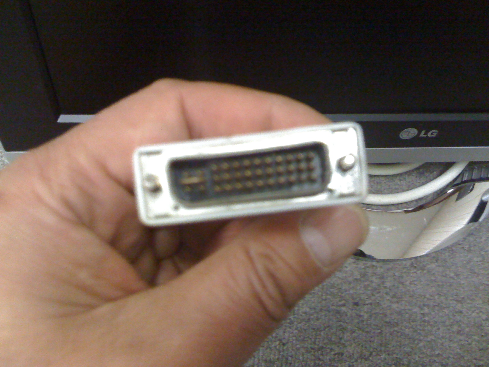

    A friend just sent me an email asking me (dont know why he asked me) if there was a way to test or power up a monitor that he just got from someone cheap.
    First its an LG L2320AL. Apparently it does not have a standard power connector on the back. Apparently it has only a single cable coming off the back. My friend sent me a pick of what the cable looks like (see enclosed pic).
    What my friend wants to know if how to power up monitor with only this cable. I think what he wants to know is that since he does not have the "media center console" which i think came with the monitor at some point is there a way to make like an adapter to a power cord so that he can turn the monitor on. Also, he would want to some how connect monitor to a computer.

    Hey, man, that's appears to be just a straight DVI connector. Hmm - I've heard that some Apple displays with the ADC (Apple Display Connector) had to have a special adapter from Dr Bott (the DVIator) that allowed the ADC Monitors to work with standard PCs. I believe think Apple 30" Cinema Display was one that required it. Hmm, I've found an image of the ADC plug, it had rounded edges, so that cannot be it. There must be a AC or DC plug jack hidden under a bezel somewhere. Have your friend look there. I also can't find any info on this monitor in English, was this a mainland China only monitor?

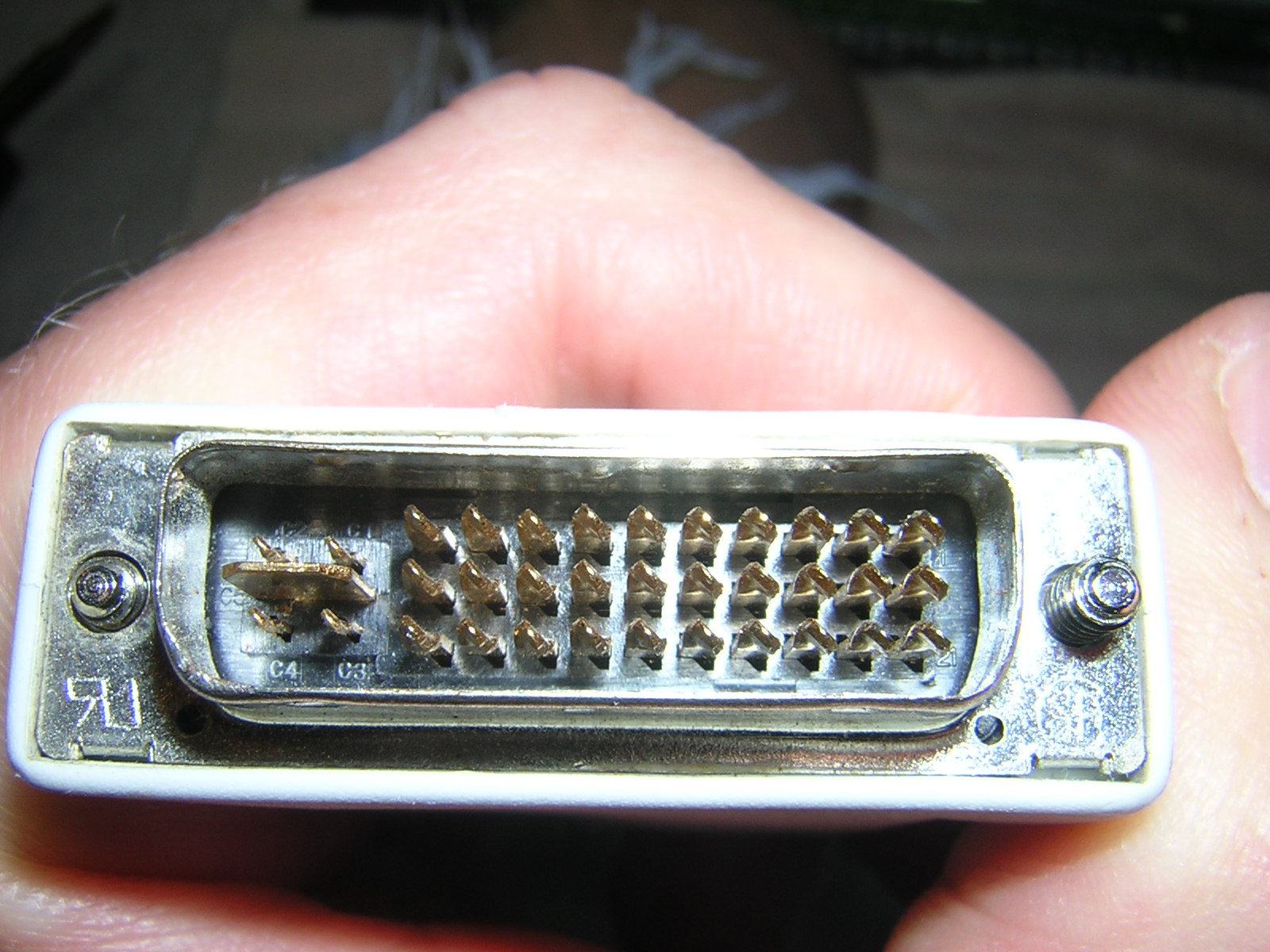

                There are MORE pins on this connector than a standard DVI cable. In fact, there are 6 extra pins tacked on to the end of what otherwise would be a standard DVI connection.
                  Re: How to power up LG 23" L2320AL without media center console?
                  Oh. :P
                  Open it up and find out the chipset and wirings that accounts for the extra six pins.

                        That's the info for a standard DVI connector. This monitor has 6 additional pins.

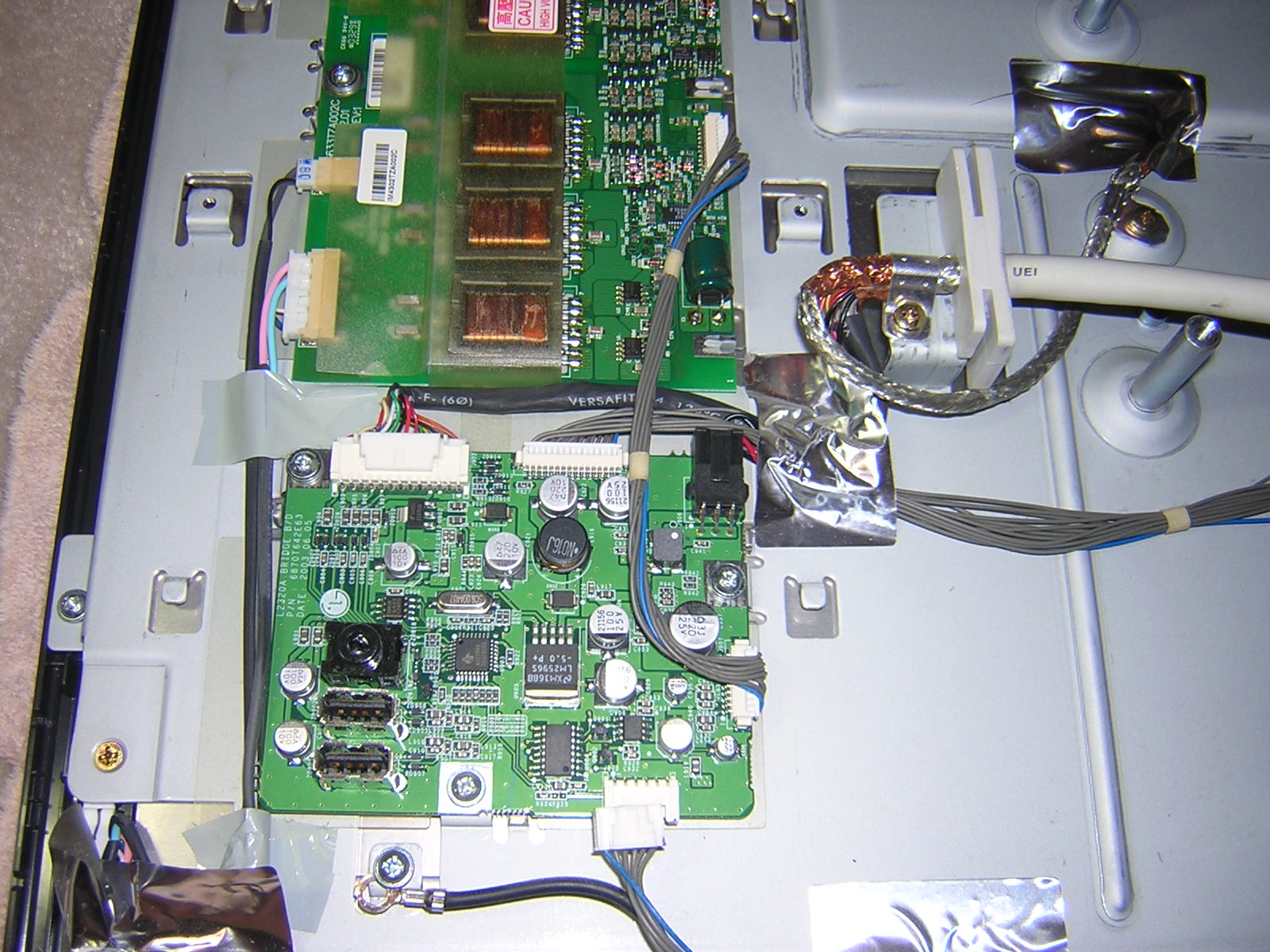

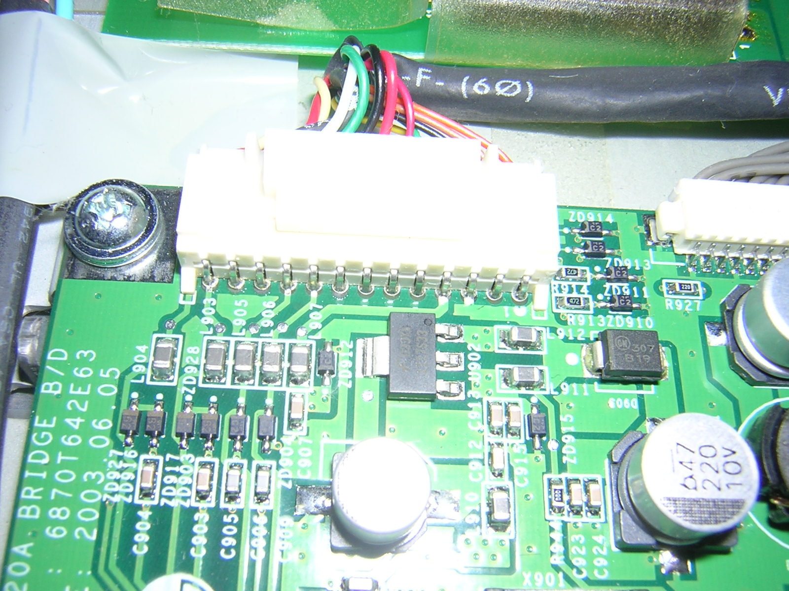

                            My friend dropped off his LG2320A about 1month ago. Just now getting around to looking at it.
                            Recall: This monitor does not have a standard power cord. The link below is a pdf file for this monitor and how its connected to its other components.
                            Basically this monitor plugs into a "media station" (a pc of sometype). One of the outputs from the media station goes to the monitor. This connection must have the power and signals for the lcd.
                            FIXITNOW listed some voltages and currents........these same voltage/current levels are listed on page 33. On this page the Display input specifications are listed below.
                            Display Input
                            DC 18.5V 4.5A
                            DC 5V 0.5A
                            The goal here, if possible, is to rig some sort of cable that will enable it to plug into a standard either DVI or VGA computer input. Do you think this is possible?
                            I have also included general pic of how cable is connected to monitor and where cable comes into printed circuit board.

                              If i were to use an external power supply rated at say 18V, 4.5A how would i need to wire it up to power this monitor?
                              Also, how would i wire a VGA cable to this monitor so that i could plug this into a computer?
