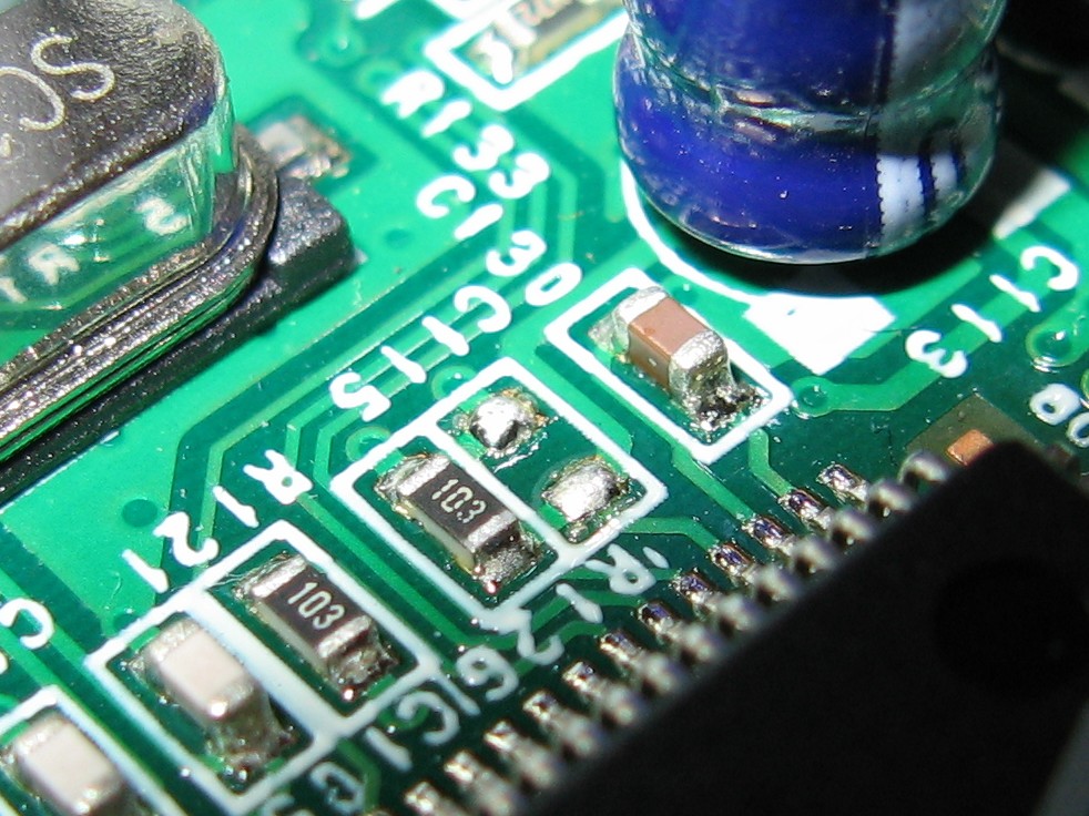

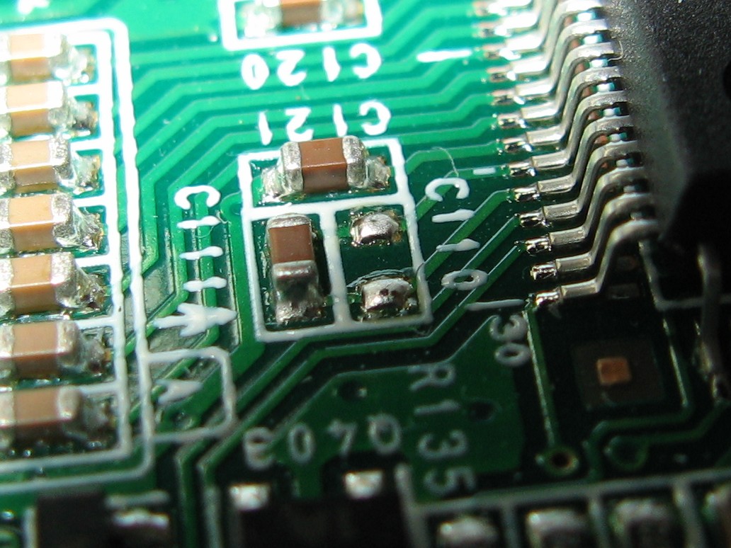

LG Flatron L1732TQ -Display "out of range"
+ More Options
Posts
  • jarl
    • Oct 2009
    • 57
    I got this LCD monitor that seemed to be Ok, but: When you connect it to a PC via either the analog or the digital input, it shows an image as soon as I start the PC. After a few minutes the screen goes black and a message appears saying "analog out of range" (or digital, for that matter). A few seconds later the monitor goes to sleep, due to the lack of a "proper" signal.
    Restarting the monitor doesn't help, but leaving it off for several (>15) minutes gives you a few seconds or extra video time. Google search don't help at all since most of the questions are from people running their monitors at wrong resolutions. In case anybody is wondering, I am 100% sure the signal I'm feeding the monitor is "within range"
    I took this thing apart hoping to find one or more blown capacitors, but everything looks fine. The power supply (Lien Chang AIP-108 Rev 02) is built using Maxon GF capacitors, but none of them is bulging. Besides, can the power supply create this kind of problem, or is it safe to assume something else is fried (and the monitor is gone for good)?
    The actual "brain" of the monitor uses different capacitors, but there isn't any obvious brand I can discern. There's something that looks like a logo (an "S") and a code like "CD112S" in the case of the 100uF electrolytics.
    I'm hoping someone around here may have faced a similar problem before -and has been able to fix it-
    Thanks!

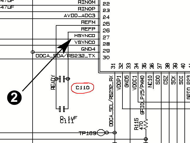

                • jarl
                  • Oct 2009
                  • 57
                  Re: LG Flatron L1732TQ -Display "out of range"
                  Stj: that sounds great. I was hoping the problem would be a capacitor or something very simple, but it looks like its more complex than that. So, if your friend has seen this problem before it's great news.
                  PlainBill: EEPROM was one of my first guesses, but I have no way of testing that (that I'm aware of). In the service manual there's something about EDID, and something about accessing memory using a program (WinEDID). But what should I be looking for?
                  According to the schematics (It's a PDF... how can I make them available for you to see?) there seems to be two separate 24C02 (one for analog and one for digital), but since the problem happens no matter what input is being used I think the issue is probably in a component common to both. The scary part is that the only component I can find in that particular area has 100 pins There are also two 25P10VP and one 24C08WP close to the main IC
                  Now... regarding the 100 pin IC (U101): In the schematics that IC is indicated as "TSUM16AL", but the actual component says "Flatron F-Engine / FE2031-LF". Either way I can't find any datasheet about them, but inspecting around I found two spaces without SMC components (pictures). C110 looks like there has never been anything there, but C115 looks weird. I dunno...

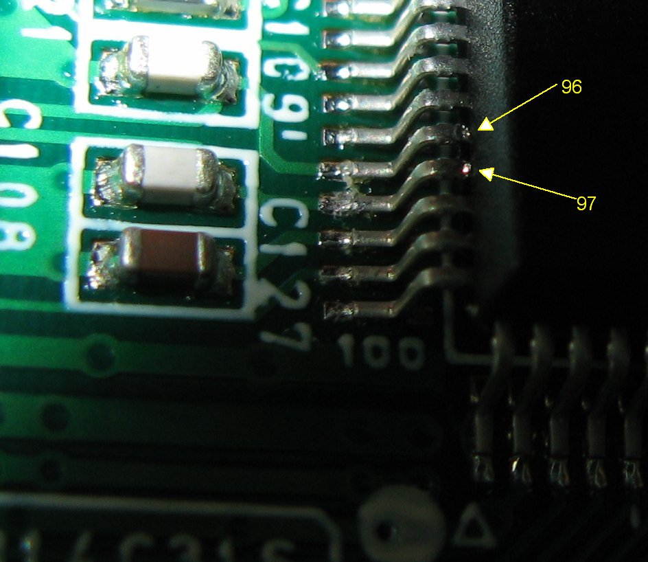

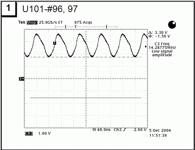

                        • jarl
                          • Oct 2009
                          • 57

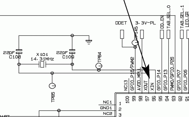

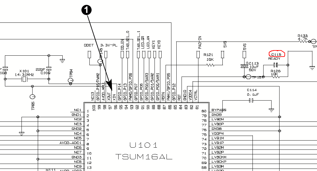

                          Reporting back...
                          I decided to buy an oscilloscope to check this monitor and a couple other things I have sitting around. And the weirdest thing happended when I tested this monitor.
                          I turned the monitor on, got the usual, normal image for a few minutes, and then the "out of range" message. The hottest running IC is U101, as expected (close to 50C, 122F). I cooled it with canned air, but nothing happened.
                          Then I probed the pins 96 and 97...
                          #96: when I touch it with the probe, it kills the display. OSC shows a constant 0.8V or so
                          #97: when I touched it, the normal image came back OSC shows a waveform similar to what should be there (I guess... still remembering how to use the scope). More importantly: when I removed the probe, the image was still there!!! If I touch it again, sometimes I get the "out of range" again, and by touching it again I can fixit -eventually-. It looks like pin #97 is broken???
                          Having identified this, how do I fix it? Right now the monitor is working, but I'm afraid after I'm done putting it back together it will fail again. What would you do?
                          Thanks!

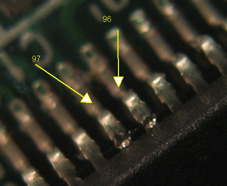

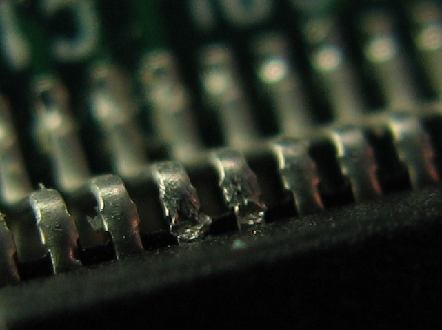

                            (Sorry for posting again... I ran out of the 10 minutes I had to edit the previous message)
                            Got a better image of the two pins (last image)... how on earth could this have happened???
                            • philpem
                              • Aug 2006
                              • 15
                              If you've swapped the caps already, I'd be suspicious of the two 22pf capacitors and the crystal. Crystals do wear out (the contacts basically break off the quartz slice), and when they're "on the way out" it gets harder to make them oscillate. Putting the capacitance of an oscilloscope probe on there might have been just enough to make it oscillate.
                              I'd try swapping the crystal, then if that doesn't do anything, swap the two 22pf capacitors.
                              As for those dimples in the pins... it looks like someone's used a scope probe to monitor the signal on them, and pushed down "just a bit" too hard. Thus the sharp tip has gouged the metal slightly.
                              Also check out that bit of "fluff" that seems to be stuck between pin 96 and 97.

                              • jarl
                                • Oct 2009
                                • 57
                                "...it looks like someone's used a scope probe to monitor the signal on them, and pushed down "just a bit" too hard"
                                Hmmm... I wonder who may have been that someone But those leads must actually be made out of lead to get damaged like that... It looks really bad, and I don't think I was pressing that hard (I was using my non-dominant hand, though... so that may explain it)
                                I saw the "fluff" you mention, but it's too tight in there to be able to clean it adequately. Now... regarding the probe starting the crystal... wow. I didn't know that was even possible
                                I guess there's some SMT soldering in my future... We'll see...

                                • jarl
                                  • Oct 2009
                                  • 57
                                  Another self-reply.... I hate when this happens...
                                  Anyway: I'm looking for the crystal at Digikey, but there are too many options and it doesn't look like any of those is what I need.
                                  From the manual, what I need (X101) is a "6202TST001A / SX-1 SUNNY ,SMS, 14.31818MHZ", but I have no idea about the other options digikey is showing me (tolerance/operating mode/ etc). Would this one work: http://search.digikey.com/scripts/Dk...=478-4350-1-ND ? What happens if the "load capacitance" is different?
