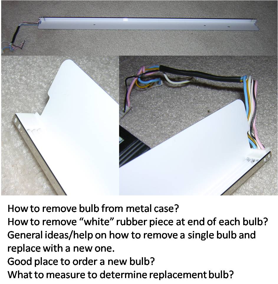

    Hi, I have an LCD computer monitor. It comes on for about 1sec and then goes off. I determined that one of the six bulbs in the monitor were bad. Now i need to replace the bulb. I have removed the bulb housings and i show one of them in the enclosed pic.
    I dont know if this is the right forum but so many on here have been so helpful i thought i would try this problem on here as well.
    My questions are as follows:
    How to remove bulb from metal case?
    How to remove “white” rubber piece at end of each bulb?
    General ideas/help on how to remove a single bulb and
    replace with a new one.
    Good place to order a new bulb?
    What to measure to determine replacement bulb?

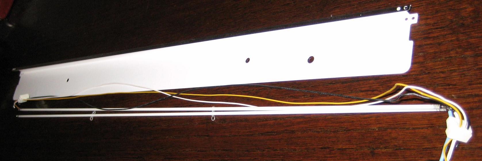

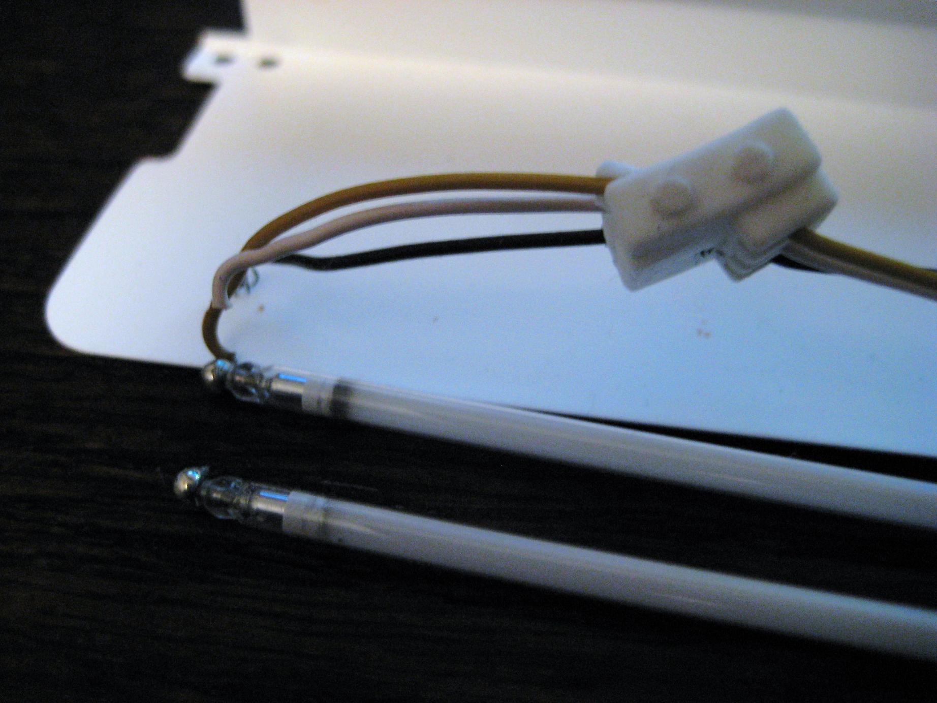

    You can coax the bulb pack out of the metal housing fairly simply. Usually the wires are kind of glued down on the back side, you will be able to slide a knife or some other tool under them to separate them from the metal. You should also find that you can push the smaller return wires that go to the far end of the bulb through the rubber housing to give enough slack that you can now separate the metal casing from the bulb packs held by the rubber pieces at either end.
    I don't think many people would suggest replacing a single bulb but who knows. There are sources for bulbs but any that I have found are all very expensive. The best bet in my opinion is to get yourself a spare from another similar sized monitor. Ebay, Craigslist etc can be good sources to get the same monitor but a cracked LCD.
    I have a picture of a similar three bulb pack that I took apart because it had a dead bulb. Although a single replacement is possible, it certainly isn't easy and I don't know what others would recommend but I don't think it's a good value fix.

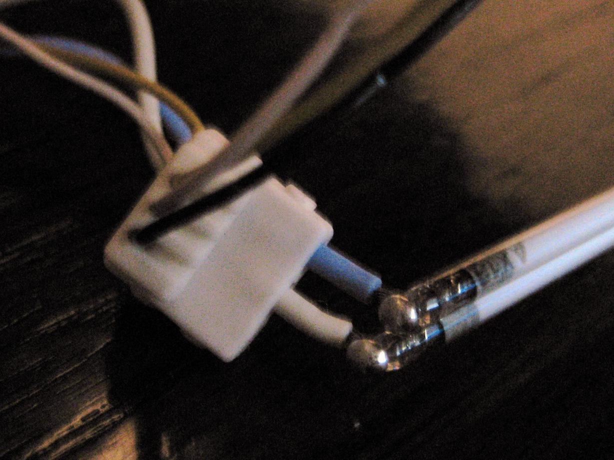

            rubber covering the solder joint is pushed on - if it's stick then they may have added glue.
            the tube is measured end-2-end of the glass body in cm.
            and the diameter in mm.

              Lots of gentle persuasion. The wires and solder joint came in on a right angle in mine so there was a lot of coaxing to work it off. In this case, I tried on the dead bulbs that you saw but I had another CCFL bank with a bad solder joint on one of the bulbs. I used the same procedure, re-soldered the joint and voila...it's still running fine!

                How did you know you had a "bad" solder joint on the bulb? Perhaps, before taking it ALL apart i should just resolder the joint as well.
                  • 30963
                  Re: How to suggestions for LCD bulb replacement.
                  i'v seen that, but your lucky.
                  usually when the solder is bad it causes a lot of heat.
                  the heat cooks the solder so it wont melt.
                  i usually have to file the damned stuff off to put fresh solder on!
