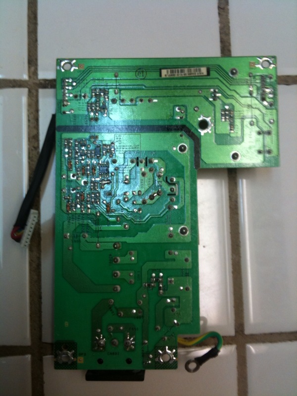

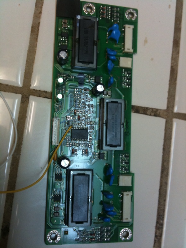

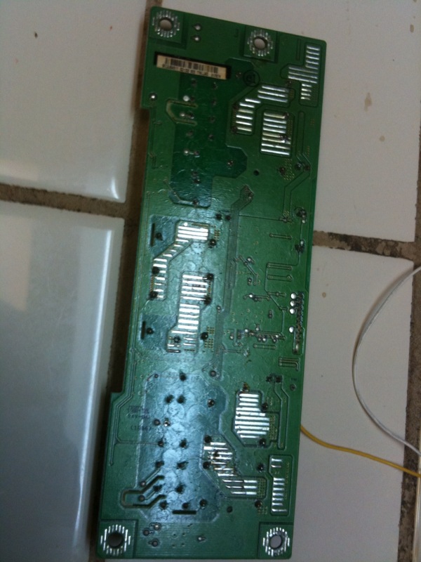

    My brother gave me this monitor after it stopped working for him in hopes I could repair it and find it a new home.
    The display turned on when I hit the power button for about a second and then immediately went dark. It appeared the backlights were shutting down because the monitor continued to function as I could see the desktop using a flashlight.
    So I suspected there was a problem in the inverter or one of the ccfl's.
    There were five electrolytic capacitors on the inverter board:
    (3) 220uF 25V Elite capacitors
    (2) 47uF 25V Lelon capacitors
    I went ahead and tried replacing the 3 Elite caps with some panasonic FC's I had lying around but this didn't change anything. I dont have anything to replace the 2 Lelon caps with, but I do plan to replace all caps in this monitor at one point.
    Then I measured the 3 inverter transformers and everything seemed ok there.
    Next I tried resoldering all the legs of the inverter transformers and surrounding devices just incase there were any bad solder joints. Still no improvement.
    I noticed the inverter is using the oz964gn pwm controller chip. Working from past experience, I temporarily installed an LED From pin 10 to ground. This forces pin 10 (Voltage Control Loop Compensation Pin) to around its nominal operating voltage. If I understand correctly, this fools the chip into believing there is no problem (ie over/under voltage or current) in the inverter.
    Here is the data sheet incase anyone wanted to see it: http://pdf1.alldatasheet.com/datashe...C/OZ964GN.html
    Anyways, by installing this LED, I was able to get the monitor to work properly. This leads me to believe that there is a problem in the inverter... either a over/under voltage or current condition OR a false positive for one of those conditions due to a problem in the detection circuitry. Not sure which one it is, but I figured it would be worth mentioning that with the LED installed, the Monitor operates wonderfully i.e great picture and great illumnination.
    So that all brings me to where I am at now... due to how this monitor is assembled, I can't really be making any online readings so further troubleshooting is going to be difficult.
    Anyone have any ideas? I suppose it could be that one of the ccfl's is getting old and just pulling to much current but I'm not sure how to go about determining this. Or should I try replacing the 2 Lelon caps?
    I have included top and bottom picture of both the inverter and power supply. Not the best quality but I suppose they are better than nothing. You'll notice a jumper wire installed on the inverter - that runs out to the LED I was talking about.
    Any advice is appreciated.

    There are a couple of ways to approach this. I'm going to need better pictures of the inverter to be able to help much, but here is the rough idea.
    The inverter has circuitry that senses the output voltage and current through each CCFL. This information is combined and fed to one or more inputs of the Inverter Controller. Typically they use a pair of capacitors in series and a diode as a voltage divider to sense the voltage, and a resistor / diode network to sense the current on the return line. By tracing the circuitry, you can locate points where you can measure the signal from each CCFL.
    One shortcut is to look at the leads to the CCFLs. Often you will see a large diameter pink or blue wire paired with a smaller diameter white wire. (The wires are actually the same gauge, the difference is due to the heavier insulation on the high voltage line to the CCFL. The return line is at a much lower voltage and needs less insulation.) In most cases the contacts on the CCFL connectors can be probed on the PC board. With the backlights operating, measure the voltage on the return lines (NEVER on the drive lines).
    Possible causes include shorted turns on a transformer, an open primary or secondary, a bad solder joint or broken wire at the CCFL on either the drive line or the return line, deteriorated insulation on either line, or a bad component in the sense circuitry.
