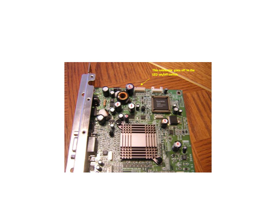

    A friend gave me his old LCD monitor to try and fix for him.
    Problem: When you plug in monitor ...... nothing happens. The "LED on" light does not even come on. This LCD has as its input-power source a 12V DC power cord.
    I opened it up and found several bad capacitors. Replaced those and still nothing happens when i turn it on.
    NOte: I did not replace ALL the caps on the board but i replaced the ones that had a slight "bulge" in the top of the cap.
    I am enclosing a picture of the board.
    If anyone has ANY ideas what to try and figure this out please let me know.

    We need some more information:
    1) What kind of caps are on your board? If they fall into the bad cap list, you'll probably want to replace them all. Also, some may fail with no visible indicators, so keep that in mind.
    2) You mentioned a 12V DC power supply. Have you tested the output with a Voltmeter? It is quite possible there are some bad caps in there as well - that's what I've heard anyway. But I wouldn't crack it open until a senior member tells you that you should, or the output is not 12V DC.
    Post back with that, and perhaps we'll find something that you missed.
    Good luck!

        Thanks for the input.
        The capcitors are manufactured by "TEAPO".
        I did check the output of the dc power cord and its 12.32volts......so i think thats ok.....right?
        I also checked the fuses and they are still shorts.

                I will get the list. The caps i replaced are identified in Red. I will get the names and ratings.
                • Welchs101
                  • Sep 2008
                  • 979
                  Re: Troubleshooting Mag LT865B
                  Referring to the caps labeled in the picture:
                  1) Nichon 470uF/16V 85c
                  2) Rubycon 470uf/16v 85c
                  3) g-Luxon 470/16v 105c
                  4) rubycon 10uf/50v 85c
                  5) asiacon 1000uf/6.3v 105c
                  6) Luxon 470uf/16v 105c
                  Its a mix of parts that i had left over from some other electronics project. Glad i made this lists as i did not realize i put caps rated at 85c in there. But they should be good enough to see if i can get the unit working. I plan on placing an order to digikey. I was planning to buy the following caps from digikey:

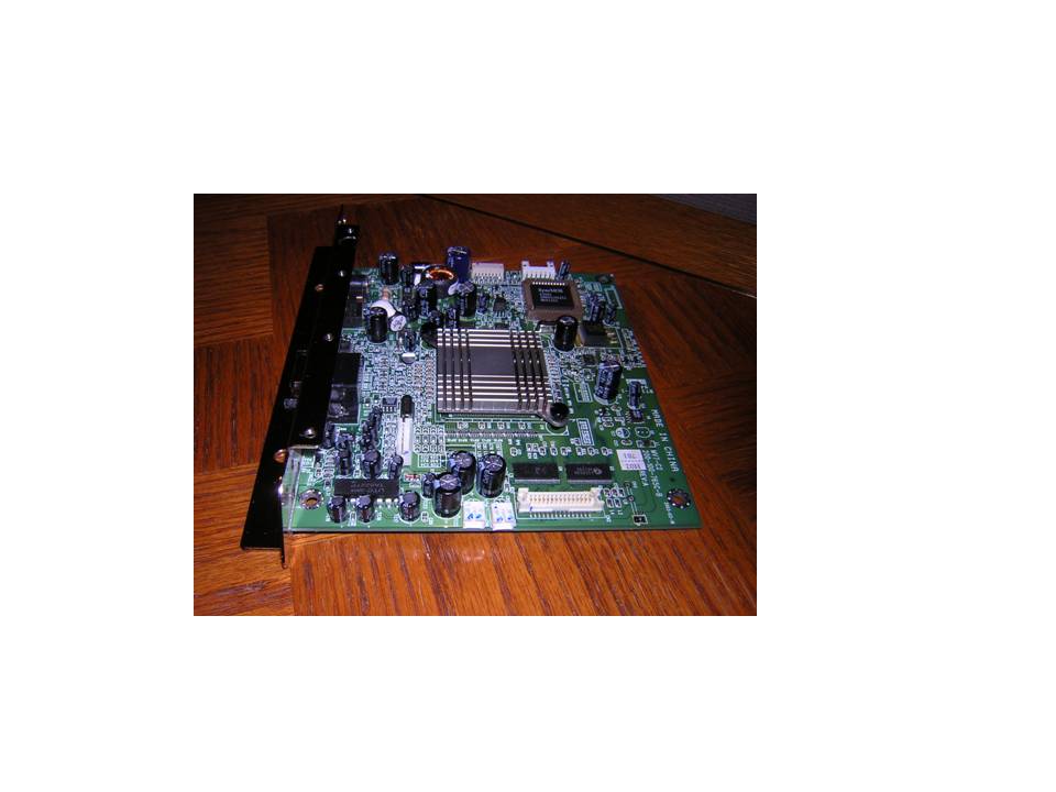

                      • EGuevarae
                        • Nov 2008
                        • 1336
                        Originally posted by Welchs101
                        Just to be clear. The caps i listed in an earlier post are the "new" caps to replace the bad-old caps. Did not want to confuse anyone.
                        You need to post better pics for us to see the components.

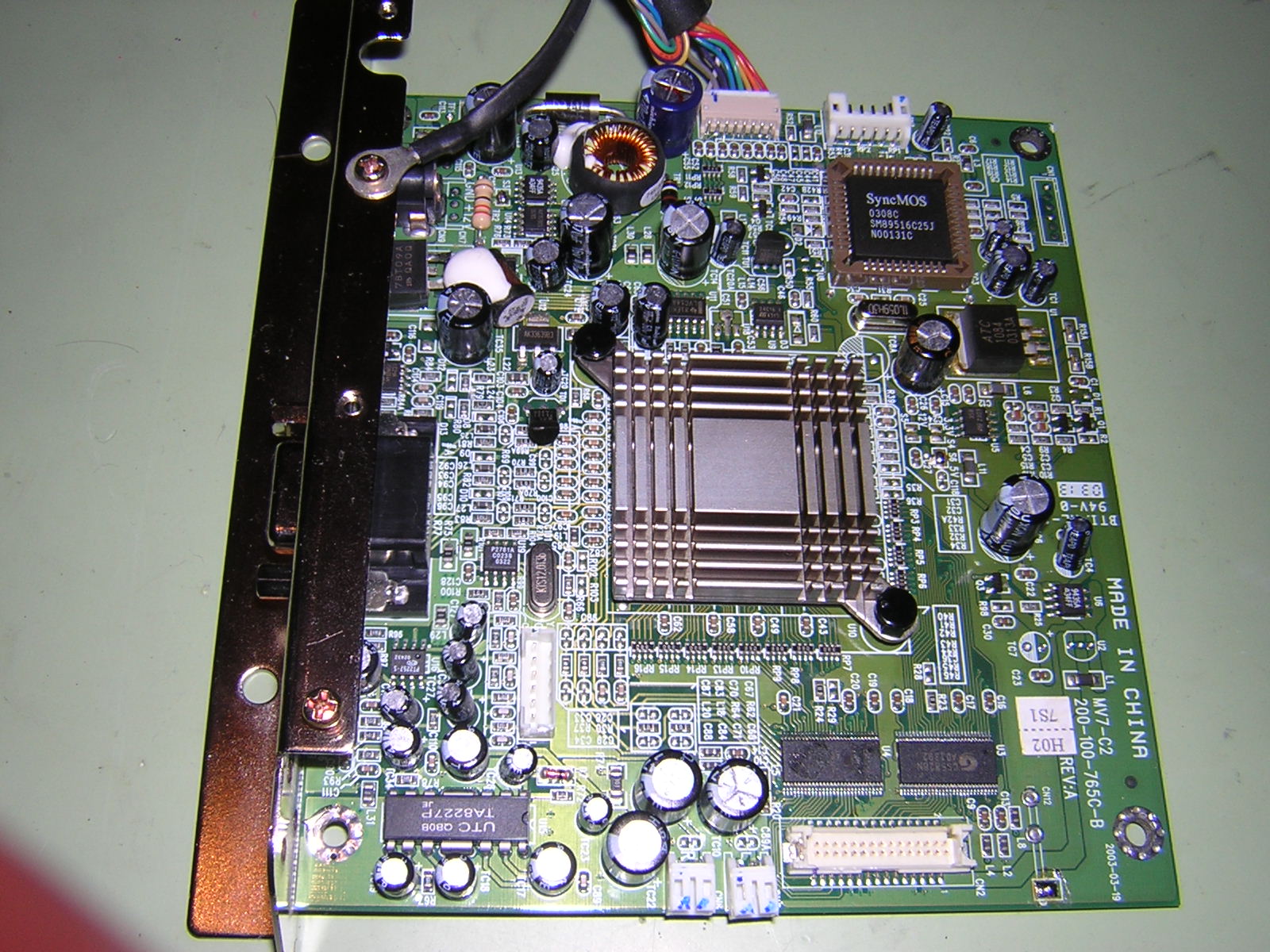

                          • Welchs101
                            • Sep 2008
                            • 979
                            Here is a better picture.
                            also, here is the web site where i found the schematic.
                            http://www.eserviceinfo.com/download...iew_AY965.html

                              I will resolder the toroid..........but can you tell me what kind of problems resoldering the toroid will solve.
                              • PlainBill
                                • Feb 2009
                                • 7034
                                It will solve a problem of no power getting through the toroid due to bad solder joints.
                                Have you tried following the troubleshooting flowchart in the service manual?

                                    ok. SOldered toroid and replaced 97% of the many many caps on this main board. Still nothing. The power on/off LED does not even light up.
                                    I am at a loss. Not sure how to proceed from here.
                                    Any suggestions?
                                    • PlainBill
                                      • Feb 2009
                                      • 7034
                                      Any suggestions?
                                      The troubleshooting chart told you to press the on/off button while looking for high / low transitions at U10, pin 141. What was the voltage at that pin?
                                      Can you read schematics? If so start by checking the power supply voltages on the logic card.
                                      If you prefer a 'divide an conquer' approach, go to U7 (Page 24 of the service manual). Check pin 22 (Gnd), 44 (Vcc), and 10 (Reset, 0 Volts). If those are correct, observe pins 2-6 as you press the corresponding pins on the front panel.
