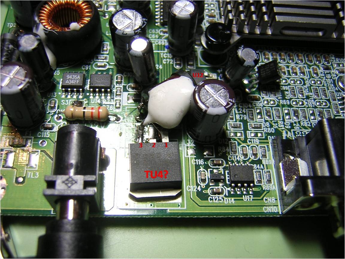

            Here goes. All voltages are DC.
            U13, pin 2 should be 3.3V
            U1, Pins 2 and 4 should be 3.3V
            Check both ends of L6, should be 3.3V
            L11 check both ends, should be 5V
            TU4, pin 3 should be 9V
            L19 Check both ends, should be 3.3V
            L22 check both ends , should be 3.3V
            TD1, pin 3 should be 2.5V
            PlainBill

                      There is an error on the schematic. Instead of U13, measure the voltage at U12, pin 2. It's next to TC35, which is next to TU4
                      TU4 is the three legged component next to the power jack. Man, that is one ugly modification hanging off it.
                      PlainBill

                        U12 measured:
                        Pin 1: 0.002V
                        Pin 2: 3.3V
                        Pin 3: 5.31V
                        TU4: I have enclosed a pic. I have labeled what i think is TU4 based on what you said. I could not find any writing on the PCB board which said TU4. If this is the right device (TU4) then i measured the voltages as follows:
                        Pin1: 12.22V
                        Pin2: 0.01V
                        Pin3: 9.01V
                          #52
                          Re: Troubleshooting Mag LT865B
                          Originally posted by Welchs101
                          U12 measured:
                          Pin 1: 0.002V
                          Pin 2: 3.3V
                          Pin 3: 5.31V
                          Pin1: 12.22V
                          Pin2: 0.01V
                          Pin3: 9.01V
                          Well, I can't think of anything else to try. There is no sign any of the power supplies on the board aren't working. The best conclusion is that either U7 or U10 is bad. Maybe someone else will have an idea.
                          PlainBill
