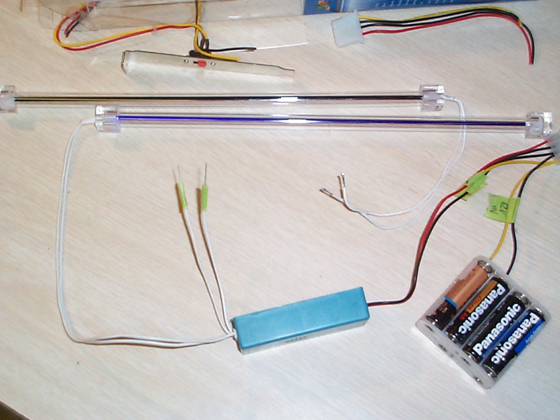

    Just bought a case mod kit to test CCFL's in lcd computer displays.
    I'd like to buy the connector / cable assembly that is wired to the ccfl's in lcd monitors. I want to change the connector on the lamps that came with the kit to match the inverter pcb connectors I see on the monitors.
    Is there a "standard" connector? Molex perhaps?
    I've seen cable assemblies on some websites but plan orders to Digikey and Mouser soon and would like to include them on the order.
    Anyone have Mouser or Digikey part numbers?
    I don't have a scrap monitor to scavenge the connectors.

    Re: Inverter and CCFL test connectors...
    Take a look at my CCFL lamp and Inverter test kit....pic shows all... the two pairs of white leads are what you're after...left pair has a pair of cap legs soldered into stranded wire for a single fine test lead (waste not want not), and the right pair of leads are soldered flat so they stick in the board connector. The 12V battery pack is lghting my 'spare' lamp, and I've left the female dongle on for an alternate connection to power.
    Questions...?

      here a website that I found that have the connector you want
      http://www.futureelectronics.com/en/...9%28SN%29.aspx
      Hope this help
      ecking767
        Re: Inverter CCFL connector question
        Many thanks for the part number!
        That is what I wanted.
