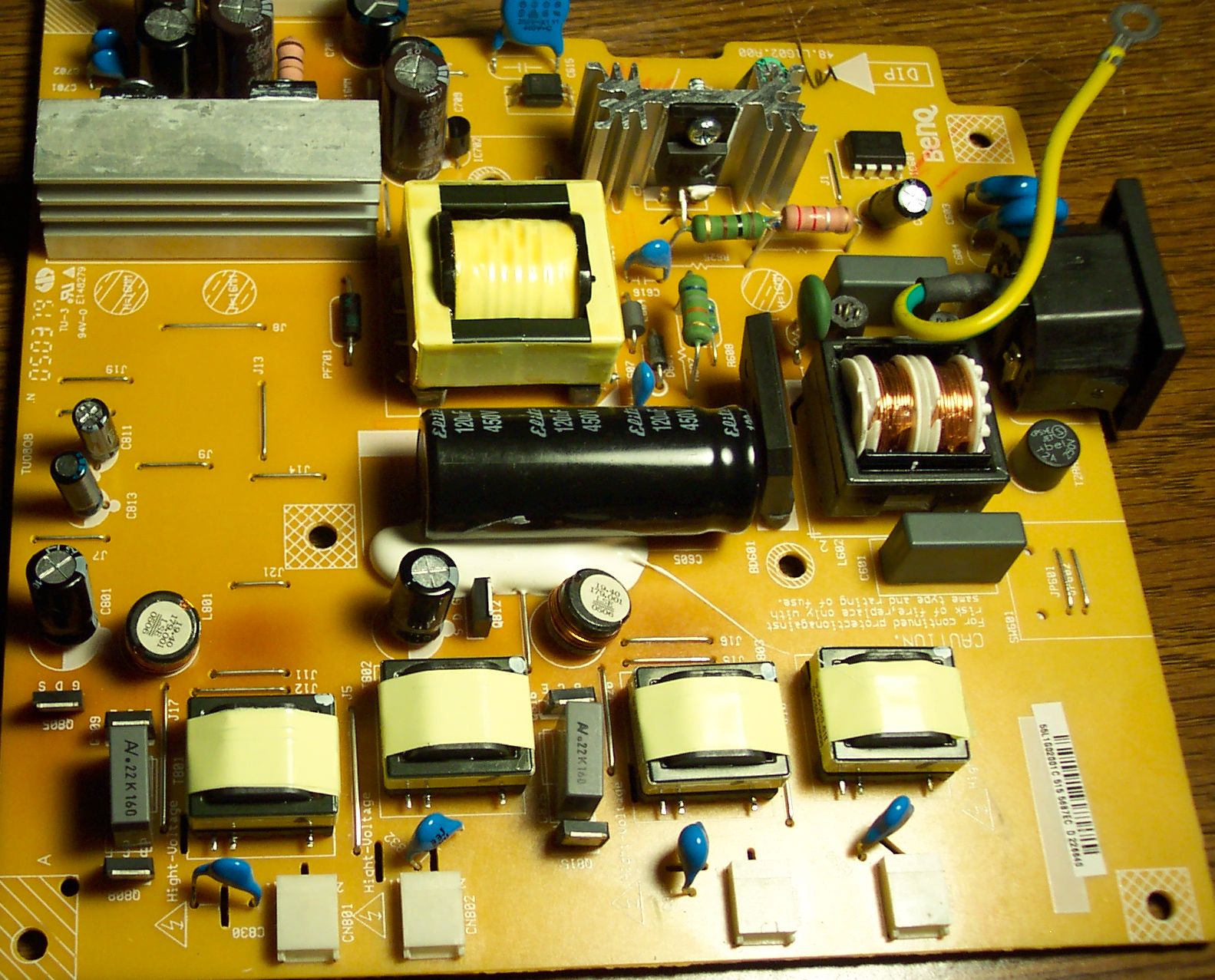

    I got a scrap HP 1740 monitor and am trying to repair it. I have been reading this post and see allot of the same problems. My monitor lights up for about one sec. then goes dark I can see the display is there but there is no back light. So I order this repair kit and replaced 4 c5707, 2 fu9024n, Pico Fuse, 2 220uf 35v cap, 2 470uf 35v cap. I also re soldered the transformers as suggested in the form. But my monitor is still doing the same thing. Only displays for about one sec then goes black. Is there a way to find out which component is failing?
    Yes, but it will require a little testing. This is a very interesting circuit; I don't believe I've ever seen it before. The transistors drive both primaries, the secondaries are connected in series.... OK, I've got a handle on it.
    On the top side of the board there is a long jumper that runs between the pairs of transformers. J5 runs between T801 and T802. Another runs between T803 and T804, I can't see the number. Mount the power supply / inverter board in place with all the screws. Use either screw at the bottom of the board (as seen in the picture of the top side) as ground, and measure the voltage at each jumper in the second or so before the screen goes dark. This should be only a couple of volts DC.

      Here are the readings I got
      starting at the bottom
      J10 .84
      J20 .84
      J5 .72
      J17 1.68

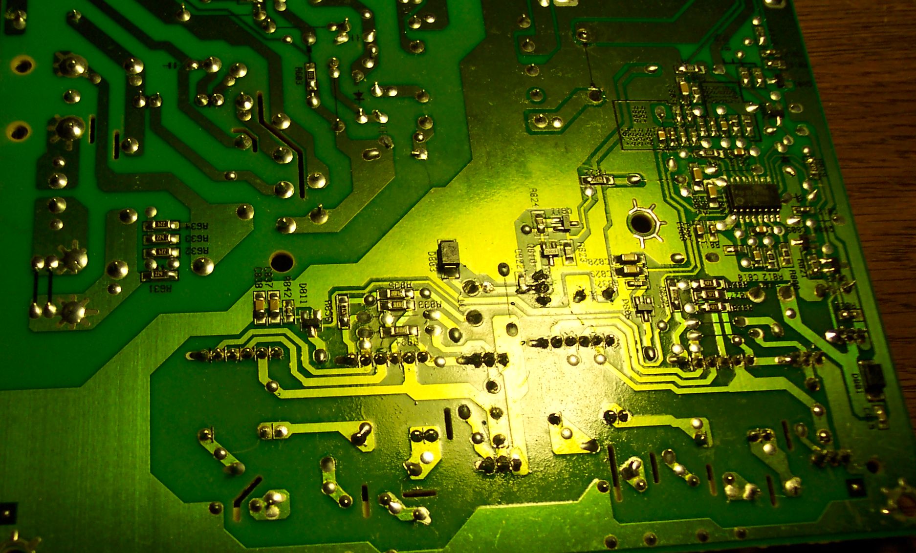

        You might want to test the D801 and D803 diodes on the back of the board. I repaired a 1940 a while ago, where one of them was shorted. I also replaced all capacitors. You might have a look in this thread for ideas.

            Ok I pulled both diodes from D801 and D803 and tested them they were both good so I put them back on. I do see dark color on the board above the 4 resistors on the other side would that be my problem? R27-R30, R33-R36

              All Benq-boards I've seen had those dark spots.
              You might have other bad capacitors beside the four you have replaced. Personally I've repaired five HP monitors with Benq-boards, and not one of them had so few as four bad electrolytic capacitors. As a minimum, I always replace all capacitors with value 220uF and up. I even saw someone who found one of the capacitors that sits between the c5707s to be bad. Also, what make and series of capacitors did this kit you bought come with?

                So are you saying I should replace the four blue cap located at c830,c832,c834,c836.
                But my main question would still be is there a way to test which component is failing and replace that one instead of blindly replacing parts untill I get lucky and make the monitor work again. or then again maybe not?

                  To test if a capacitor is defective reliably, you need an ESR-tester. Unless you plan to repair electronics regularly, it doesn't pay to buy one. Just replace all. Also, if some of the capacitors of dubious quality (Elite, Lelon, Jamicon) is starting to fail, the rest probably are in line for failing also. So, unless you like opening up monitor to search for failed components regularly, replace them all.
                  I don't find my notes on the board with the same layout you got, so I can't verify the locations, but my monitor worked after replacing all capacitors with value 220uF and up.

                    No not the four blue ones, the ones I mentioned are the grey film capacitors. Anyway, the other electrolytics are more likely to be bad than the film capacitors.

                            OK, a little capacitor failure tutorial. In addition to when you can see the bulging top/leaking bottom, the capacitor can be shorted or open internally. The most common failure though, is an elevated ESR-value. ESR is a form of resistance in the capacitors. Elevated ESR is so common, that most of us here own an ESR-meter. Even a hobbyist like me. When we replace capacitors, we use low-ESR capacitors with same or better specifications than the original, from a known good manufacturer.
                            Those Chengx you got with the kit, are of unknown specifications, but they are very likely not low-ESR like the originals, witch I'm guessing were Elite ES-series. You might have replaced Elites with elevated ESR-values with capacitors equally high original ESR-values. The Chengx might work as they are manufactured for, but their specification might be to low to work in this specific application.
                            As for something else going on, since you got image, but no backlight, I'm guessing first capacitors (the ones you haven't replaced and the ones you have replaced), second a bad CCFL-lamp. To test the lamps you need another inverter. We usually use an inverter from a PC-case lamp to test the CCFLs.

                              Yes I already tested with another good inverter from a HP 1703 monitor I use on this computer and the screen works good, backlights stay on. so I guess I should get a good set of capacitor and try repalacing them again.
                                Did you resolder all the transformer solder points, and other suspecting solder points?

                                  Yes I did all the transformer points I read that in other post and tried that already
