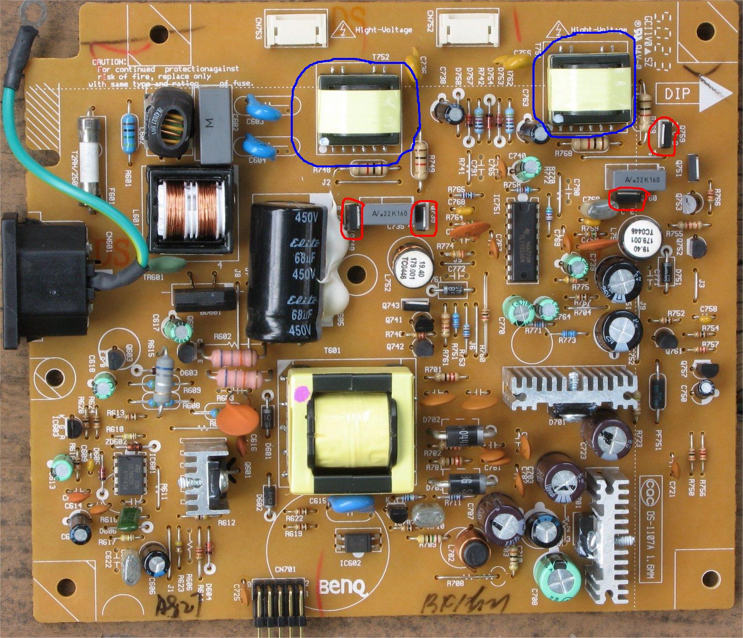

      The inverter oscillators in the E172FPb and E173FPb are free running oscillators, the E153FPb seems to be the same. Here's a picture of the power supply / inverter from an E153FPb. It's likely Q743 and Q751 control the power to the inverters.
      HOWEVER, given the history of the problem, it would be a good idea to start by looking very carefully at the area around C703. Odds are a stray blob of solder is causing this problem.
        PlainBill
        I agree too.
        See this eBay kit that contains the 4 c5707, 2 fu9024 (the Q743 & Q751 in the pic) and the picofuse. The Model and brand of the units (Dell E172FPB & E173FPB) are also mentioned. I've seen cases where all of that mentioned parts need to be replaced, and bad solder points/cold solder was also corrected.
        Either a solder blob is making the BLON signal to stay always on, or one of the above mentioned components is failing.

          Re: Dell E153FPb - Screen stays white when off or in standbye
          I checked everywhere for any stray blobs of solder, shorts etc and cant find anything.
          I desoldered the two mosfets Q743 and Q751... but I'm not really sure exactly how to test them beyond using the diode function on the multimeter for which they both tested identical (nothing obviously wrong i.e. no shorts).
          Then I desoldered the four transistors Q739, Q740, Q759 and Q760 and checked the hfe's (not sure which transistors where which as I hastly got them mixed up):
          392
          389
          393
          552
          Seems something could be up with that last transistors reading... but I'm probably going to have to replace atleast one of them anyways as I managed to break a pin off of the transistors whose hfe measured 389. (Doh!)

            You're working at it from the wrong direction. The fact that the backlights are working indicates Q739, Q740, Q759 and Q760 are good. If the two mosfets were not shorted (no need to desolder them, by the way), you should have worked back toward the control input as eguevarae indicated.
            It's a little more difficult without a schematic, but you should be able to trace the signal as it goes from the connector to the FETs with a DMM by probing and watching the voltage change as you hit the 'Power' button on the monitor. It's a bit of a pain, because you have to avoid touching anything with high voltage as you do this.

                    I managed to solder a new pin onto the transistor so that I could put everything back together for some live testing.
                    Now the problem is gone... so whatever was wrong, I managed to fix it by desoldering and resoldering the 4 transistors and 2 mosfets... perhaps it was a bad solder joint or a tiny blob of solder I didn't see.
